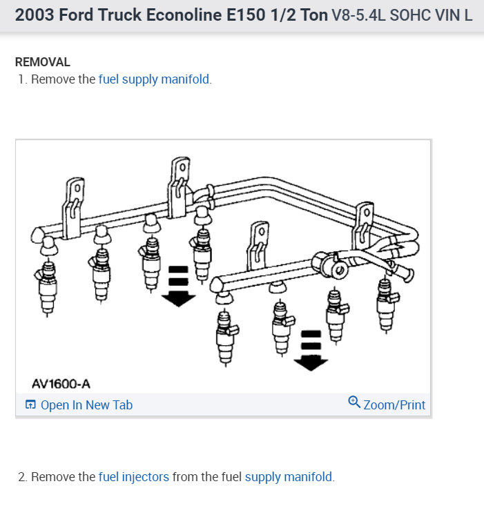

These readings are normal, except for the O2B1S1 =.075 to.880 Volts (fluctuates at idle).
It sounds like the spray patterns of the fuel injectors are compromised, but to be sure let's pull them out and check which this guide can show you how:
https://www.2carpros.com/articles/how-to-test-a-fuel-injector
Here is how to remove the injectors.
https://www.2carpros.com/articles/how-to-replace-a-fuel-injector
Check out the diagrams (below). Please let us know what you find. We are interested to see what it is. Also make sure you have the correct air pressure in the tires.
