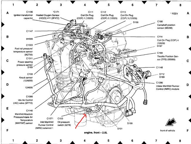

Hello, can someone tell me if they have changed the oil pressure sensor on a Ford Focus 2, 1.6, petrol, Tivct. How can I find it? Do I have to remove the alternator and then find it or is there another method?

The oil pressure sensor is easy to replace on this car, it is right above the oil filter on the right side. Check out the images (below). Let us know if you need anything else.

Hi Ken,
Thank you for the answer but the image doesn't help me.
It's for another ff2 model. Mine is ff2, 1.6 Tivct, HXDA, made in Hungary / distributed in Germany.
The sensor is located on the engine block, above the oil filter, between the oil filter and the intake manifold.
I'm attaching a link with an engine type, it's the green one in the middle.
https://www.globaleu.sk/product/15960978682

Yep, sorry about that, we don't have information on this exact car the information is what I found on a similar car.
