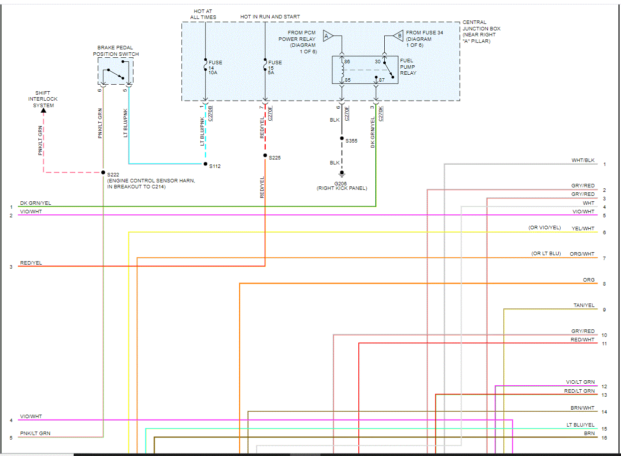

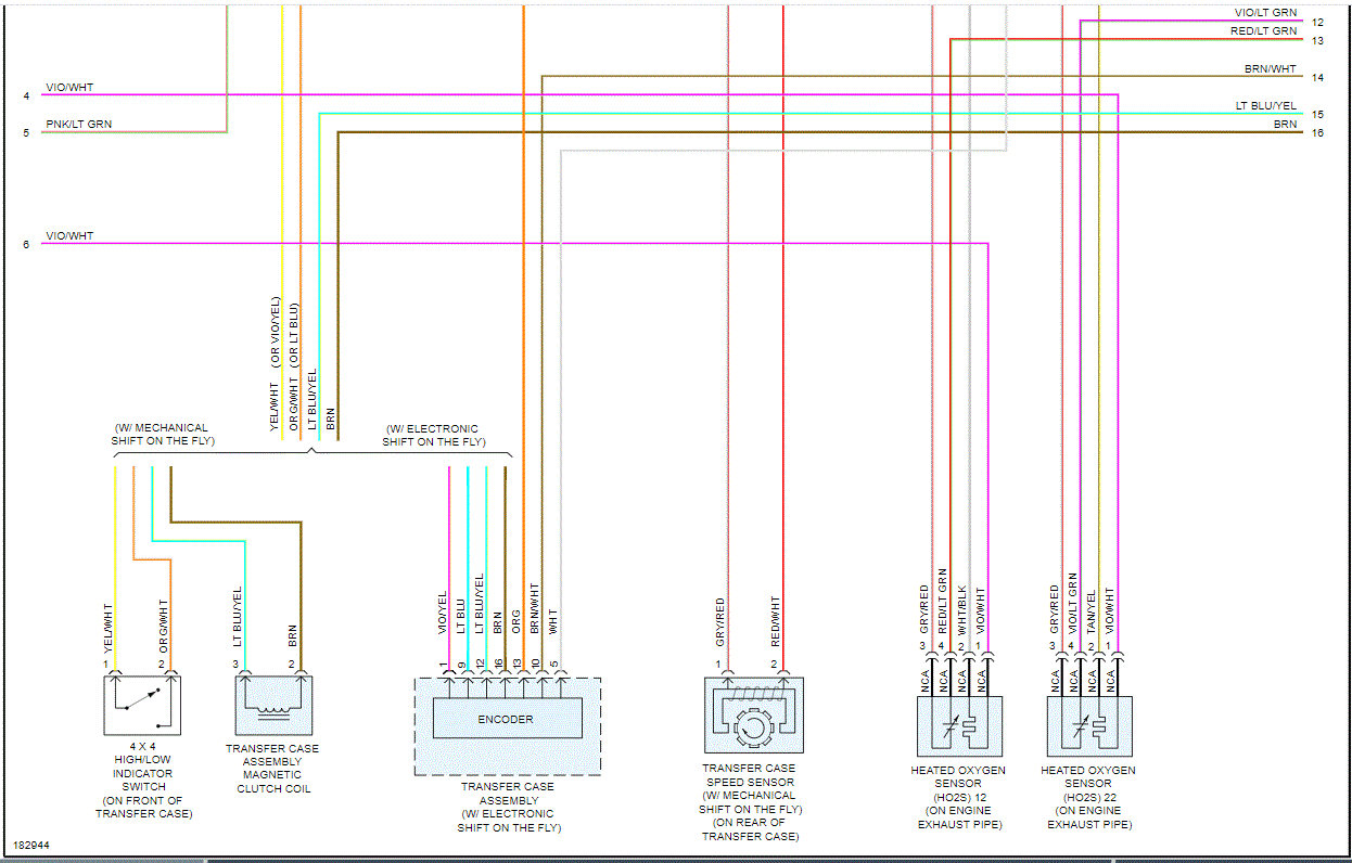

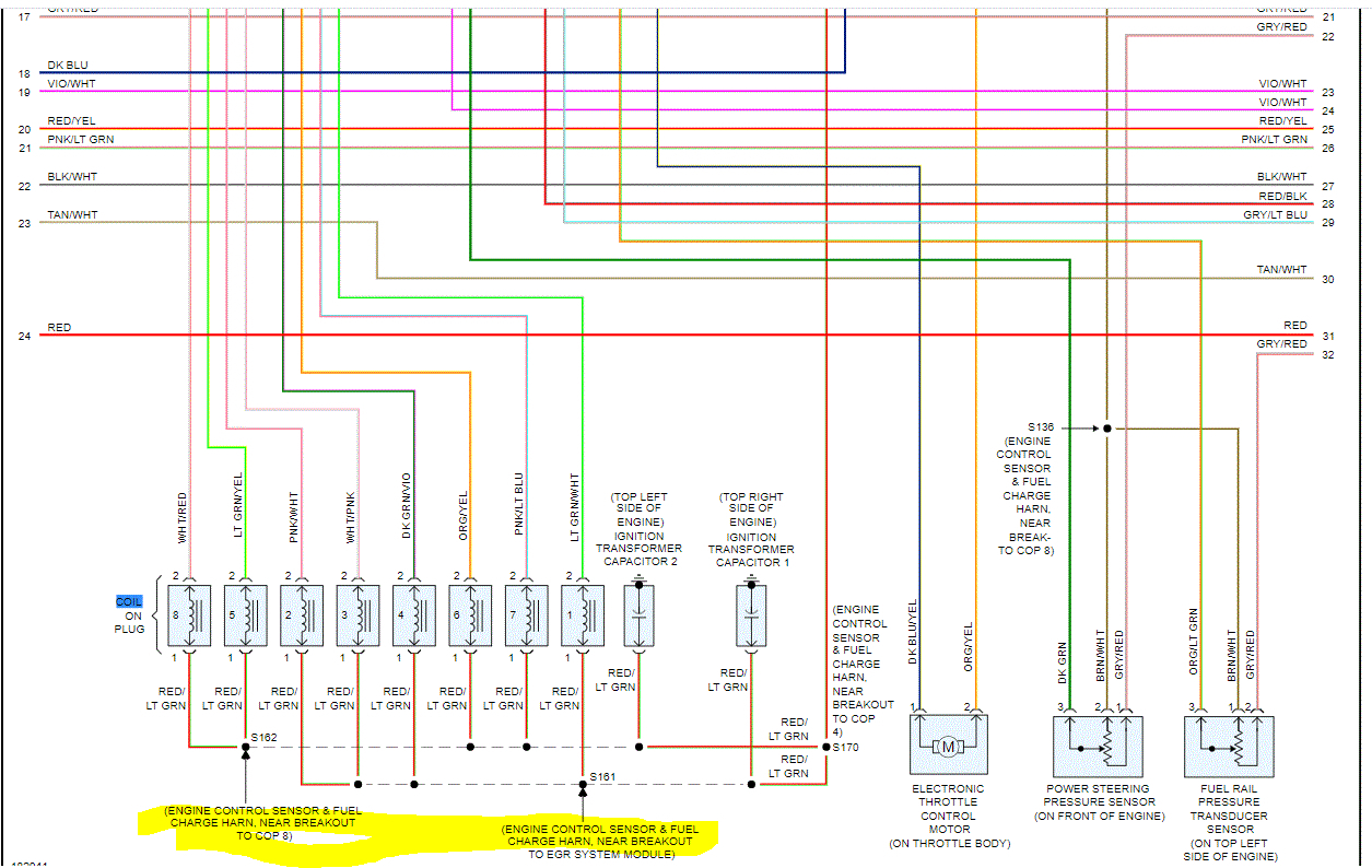

bank 2 wiring bundle that feed the cop and the fuel injector then feed the camshaft position sensor then goes down to the oil pressure sensor, there is one plug after this what does it feed and where?
Sep 17, 2021 at 5:07 PM
  • 110,194 POSTS
That's a hard one to answer without knowing wire colors, how many are in the harness, and so on. When you listed everything, the first thing that came to mind was a knock sensor. However, I can't be sure.

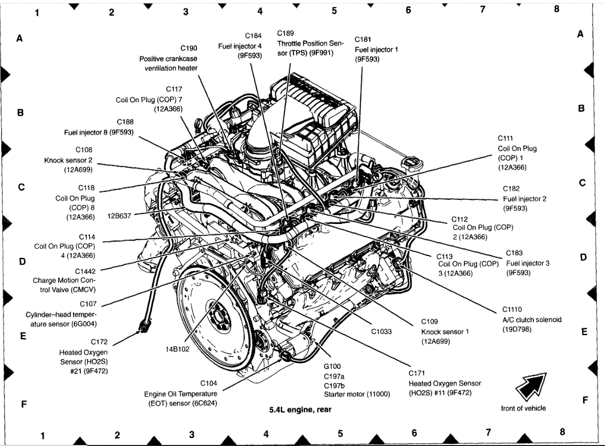

If you look at the first pic below, it shows multiple electrical components on the engine. See if that helps.

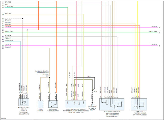

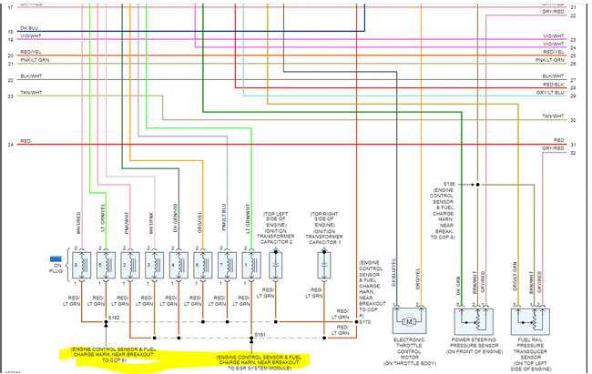

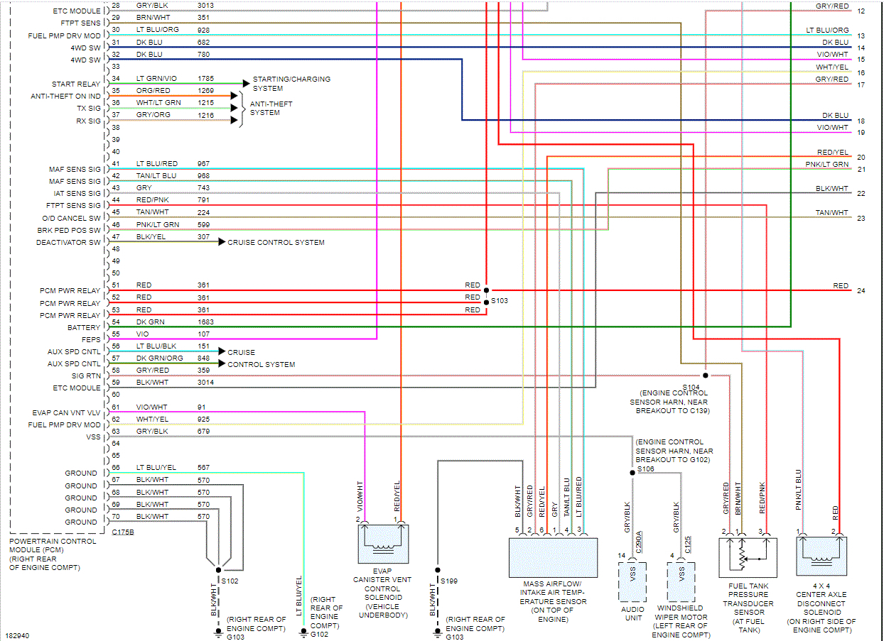

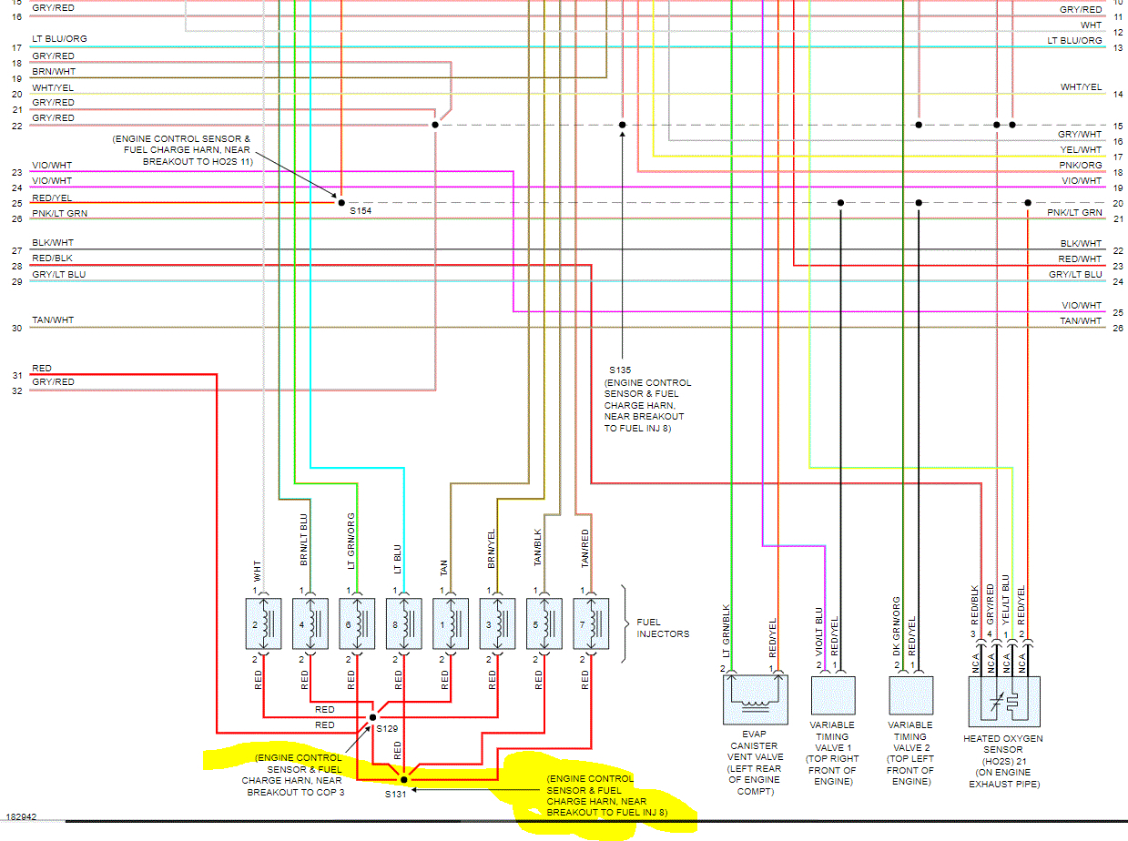

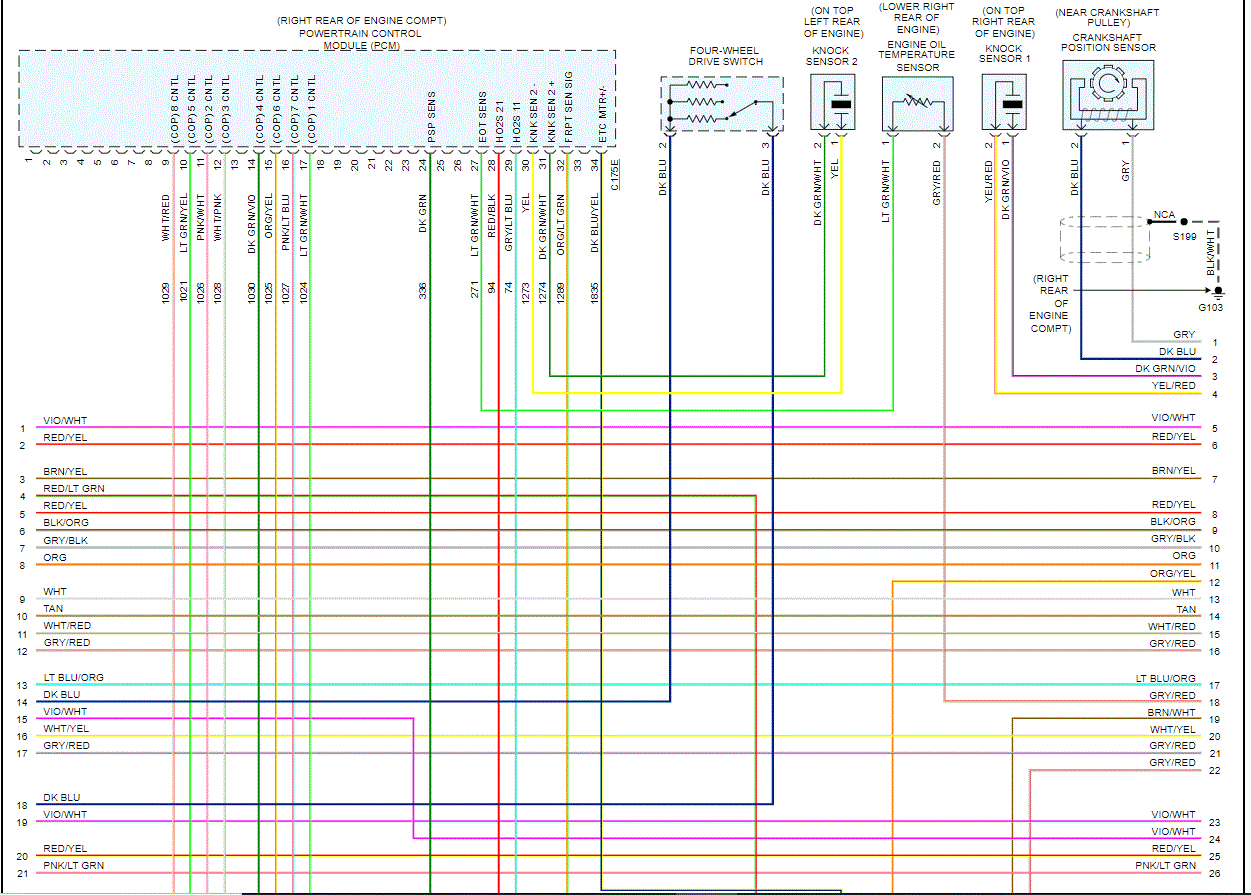

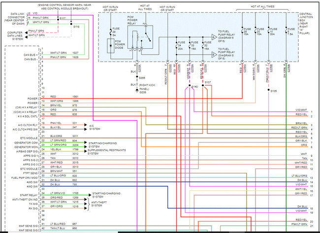

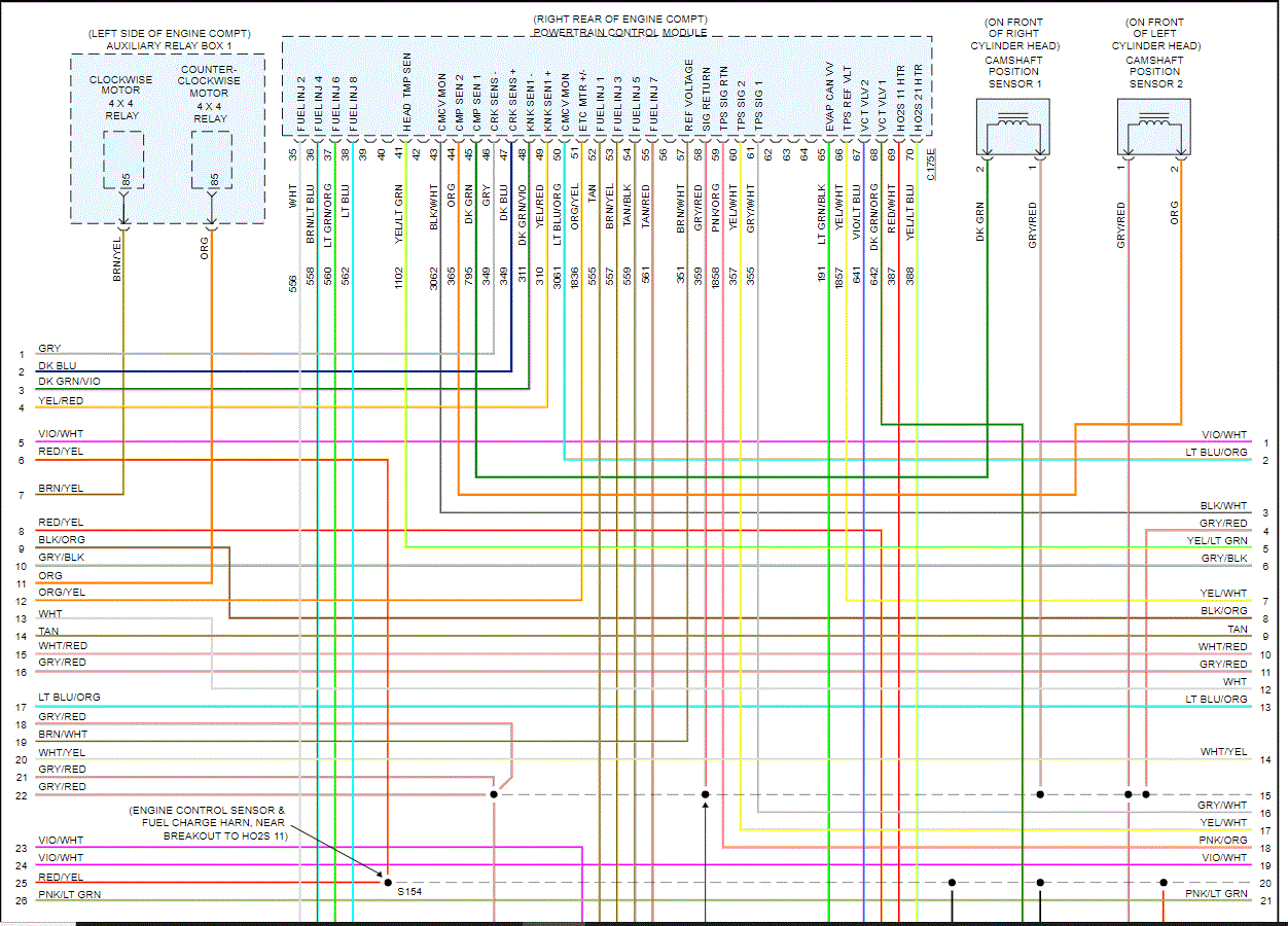

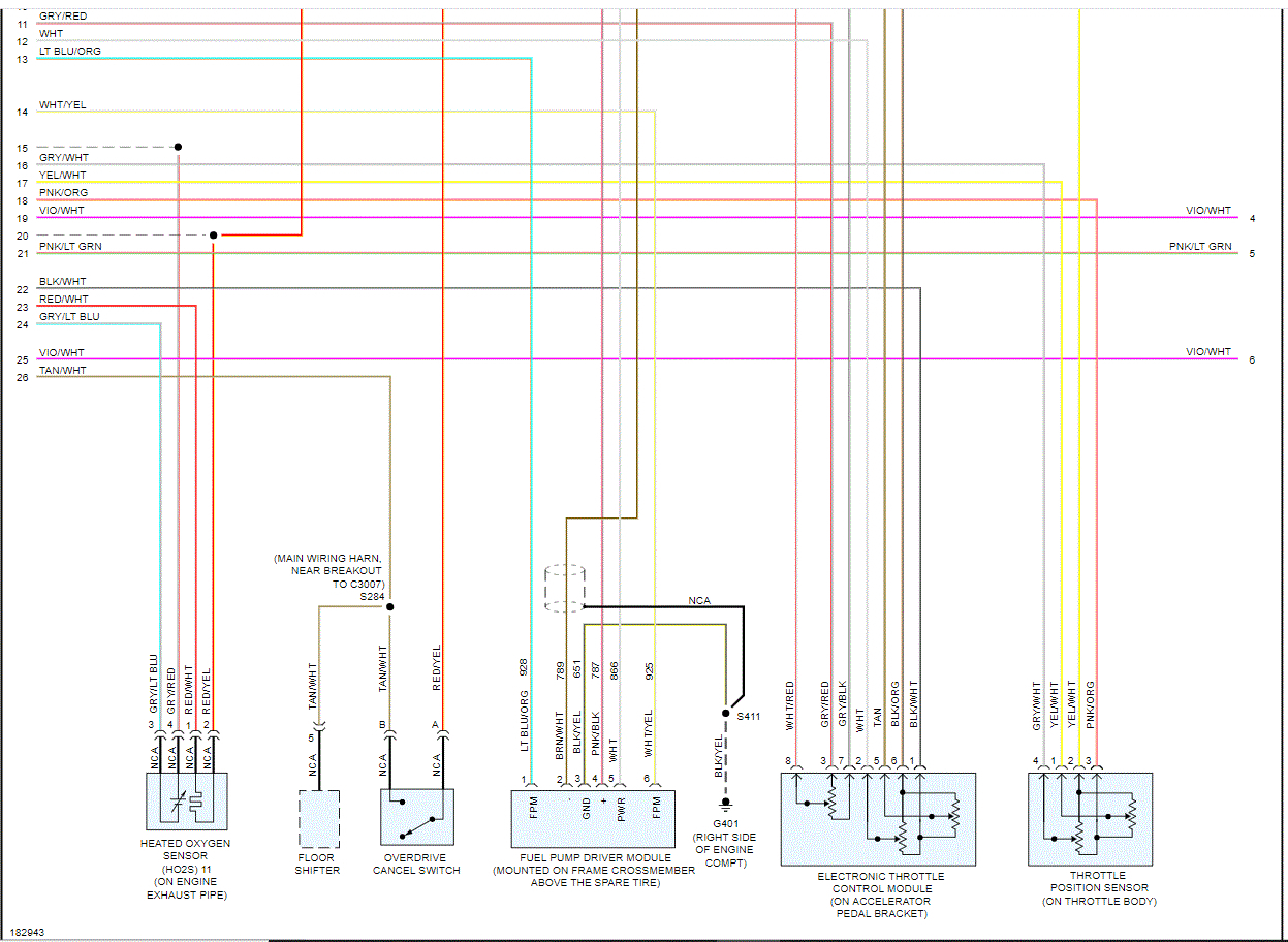

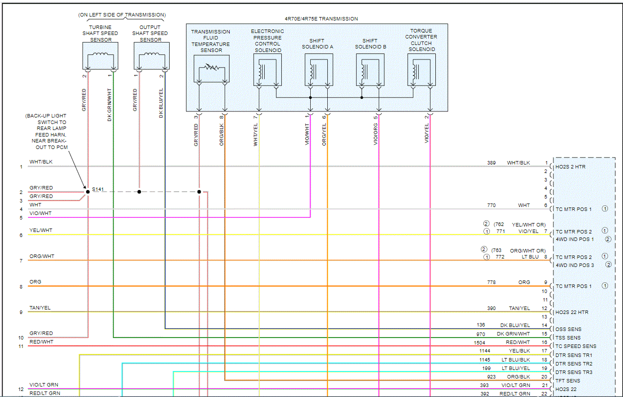

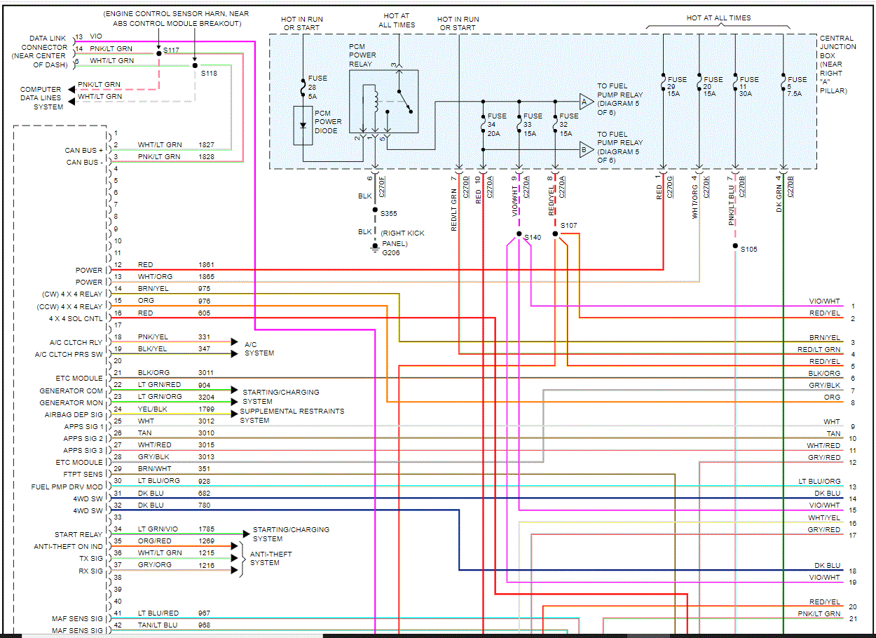

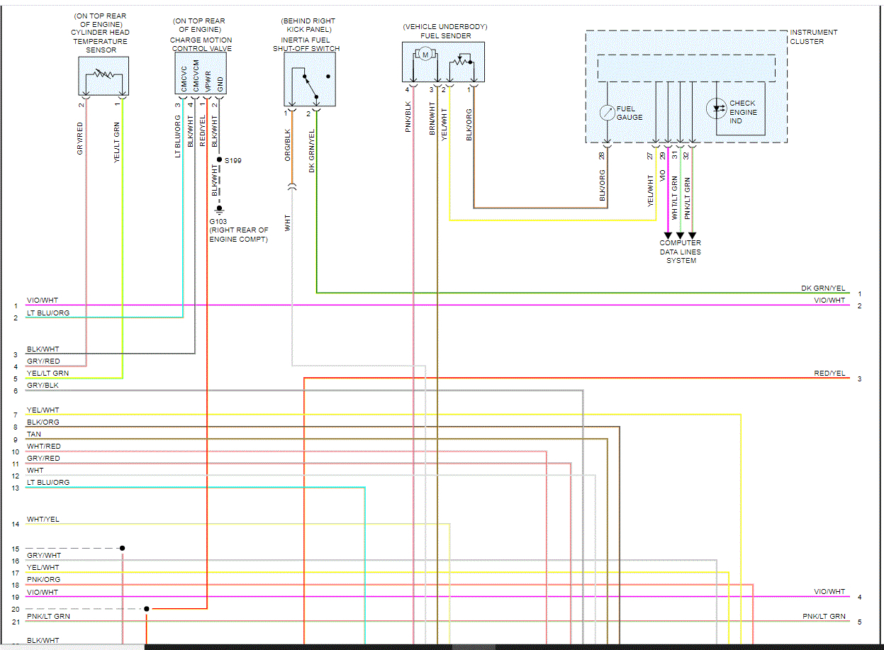

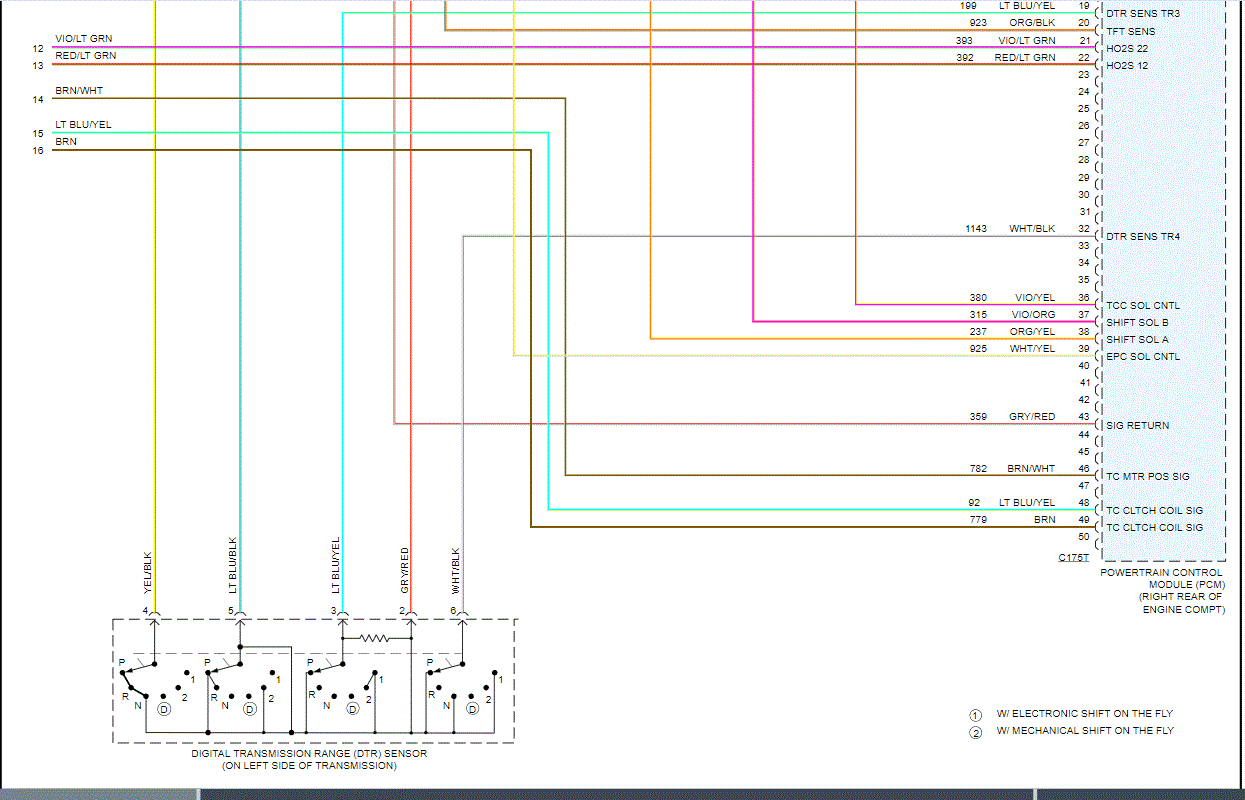

Also, the remaining 12 pics are the wiring schematic for the entire powertrain management system. I highlighted the coils and injectors to help orient you. Check the wire colors in the harness and see if you can match them with the schematic.
Now, the pics I attached for the schematic had to be cut in half to make them readable. I did overlap them so you can follow from one to the next.

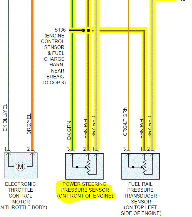

The plug has 3 wires green gray/red black/white.
Sep 18, 2021 at 7:22 AM
  • 110,194 POSTS
Could the black/white be brown/white? If so, it appears it goes to the PSP (power steering pressure sensor). Take a look at the attached and let me know.
Sep 18, 2021 at 8:23 PM
KDCHRIST
  • 39 POSTS
this was the right answer.
