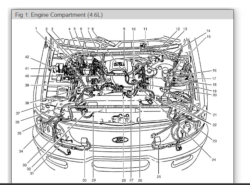

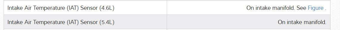

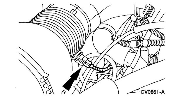

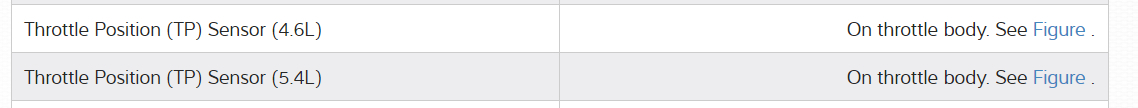

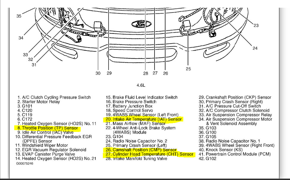

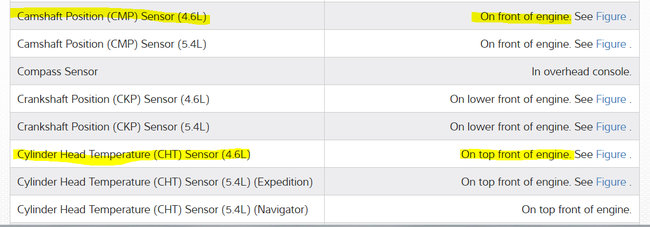

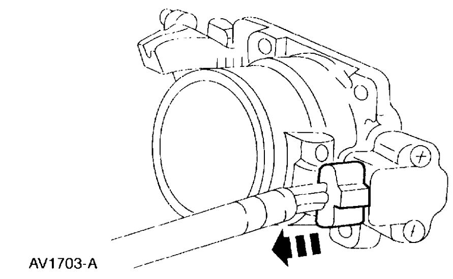

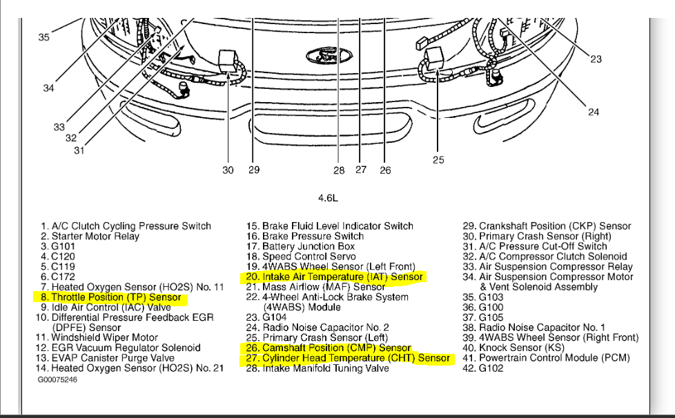

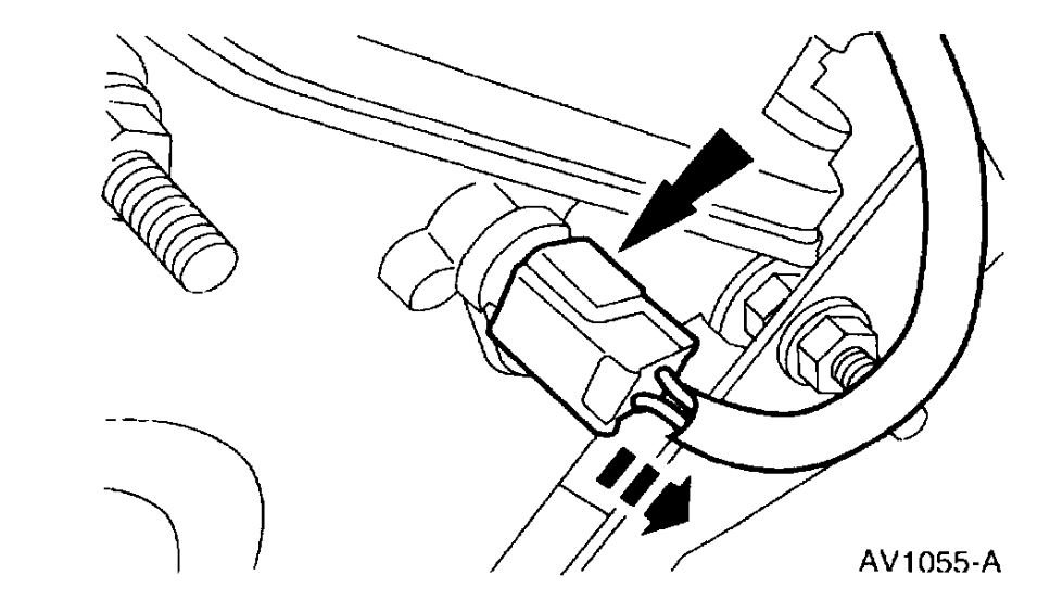

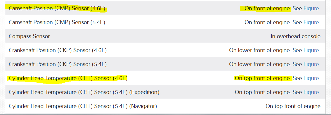

I need to know where to find the cylinder head temperature sensor, the air intake temperature sensor, the camshaft position sensor a circuit bank (p0340), the throttle pedal position sensor/switch, and the evaporative pressure sensor (p0453). Also, can you tell me what KOER stands for on the emissions test?

I attached the locations of the sensors you requested.
The pressure sensor is on top of the fuel tank.

KOER stands for Key On Engine Running. In the diagrams down below I have included not only printed locations for all the sensors you requested, I have also included a diagram with the sensors highlighted on the callout for you. Please get back to us if you have any other questions, or to let us know how everything turns out.
