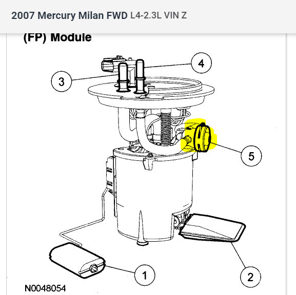

Hello, i need a diagram on where the fuel pressure sensor is located on my vehicle listed above.
Apr 14, 2024 at 5:37 AM
  • 110,241 POSTS

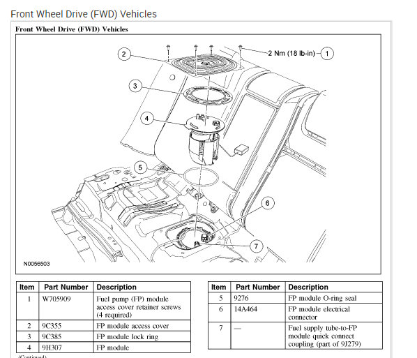

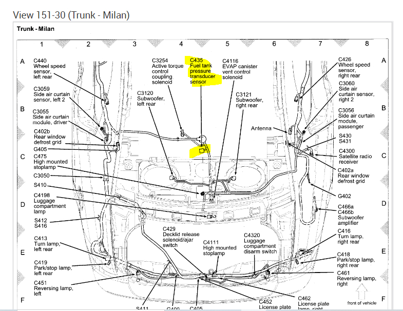

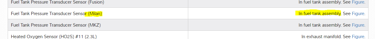

I checked two different manuals, and both tell me it is in the fuel tank assembly. If you look at the picture below (pic 2), it is of the rear of the vehicle. That is where the fuel tank is located. Pic 1 indicates the sensor's location.
Take a look and let me know if this helps. Also, let me know what is going on or what code was identified to indicate this part is a problem.

The fuel pump module contains the fuel pump, the fuel pressure regulator, and the fuel sender assembly. You need to remove the assembly to access the regulator. Before going to this extent, confirm you are able to purchase a new regulator.
To access, there is an access port under the rear seat. Remove the cover and you will see the top of the fuel pump module that needs to be removed. See pics below.
Let me know if this helps.
