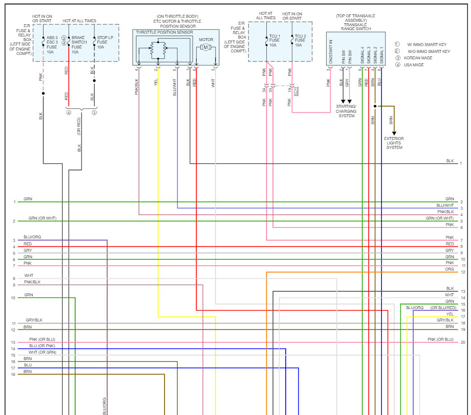

HO2S Heater Control Circuit High Bank 1 Sensor 1 code will not go away, and all sensors have been replaced?
2013 KIA OPTIMA
100,089 MILES • 4 CYL
JEFF JASE

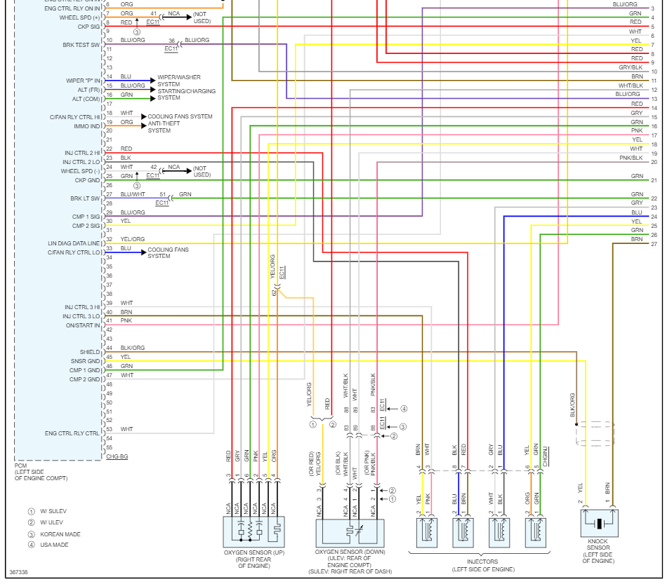

The code
I’ve replaced the sensor 3 times and this code keeps appearing no other codes appear what else could the problem be?
Aug 29, 2023 at 1:58 PM
  • 55,412 POSTS

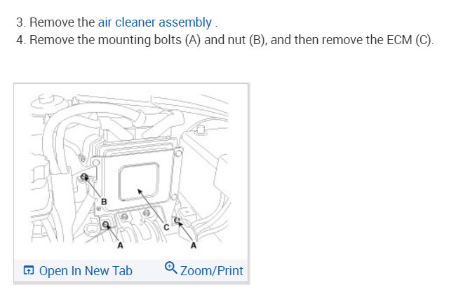

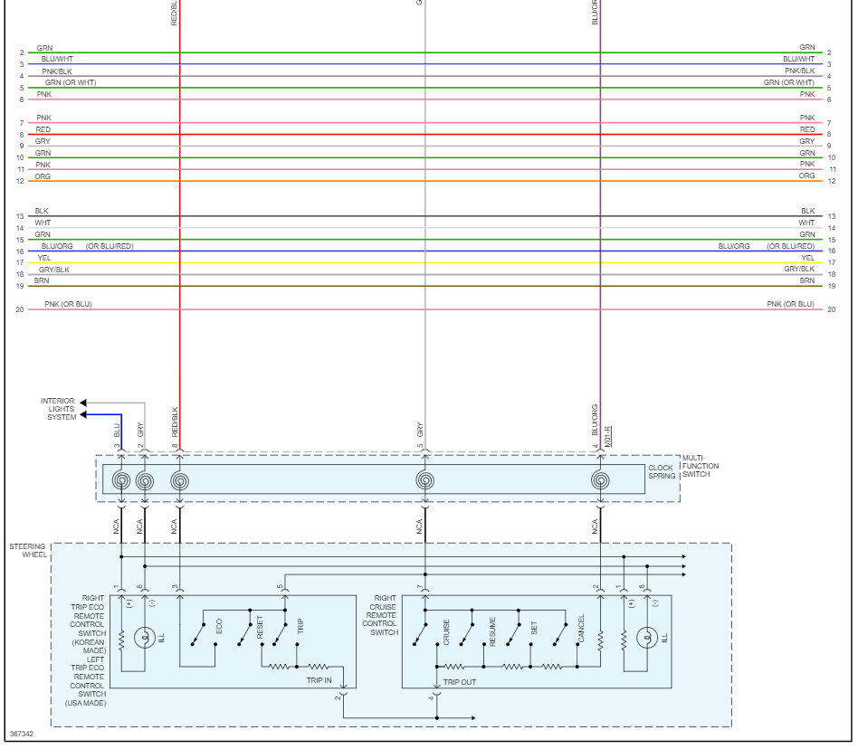

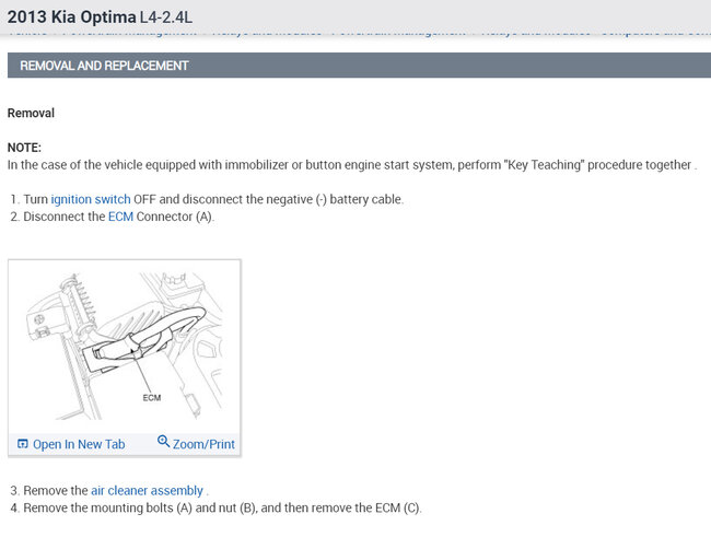

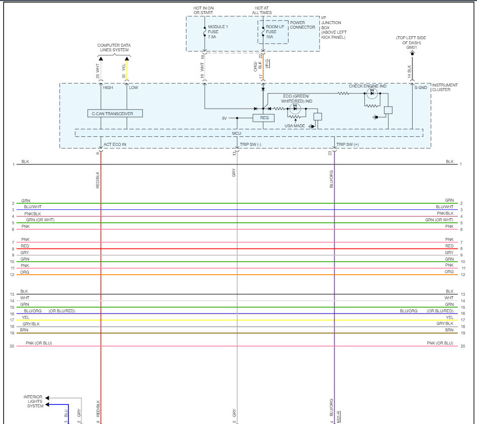

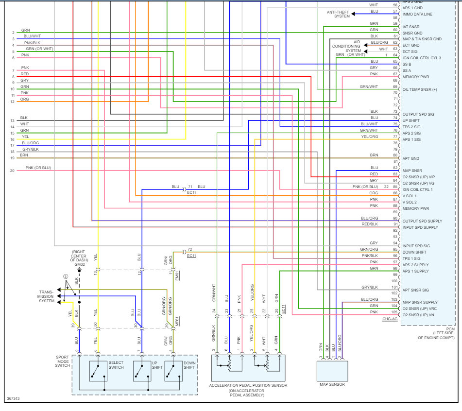

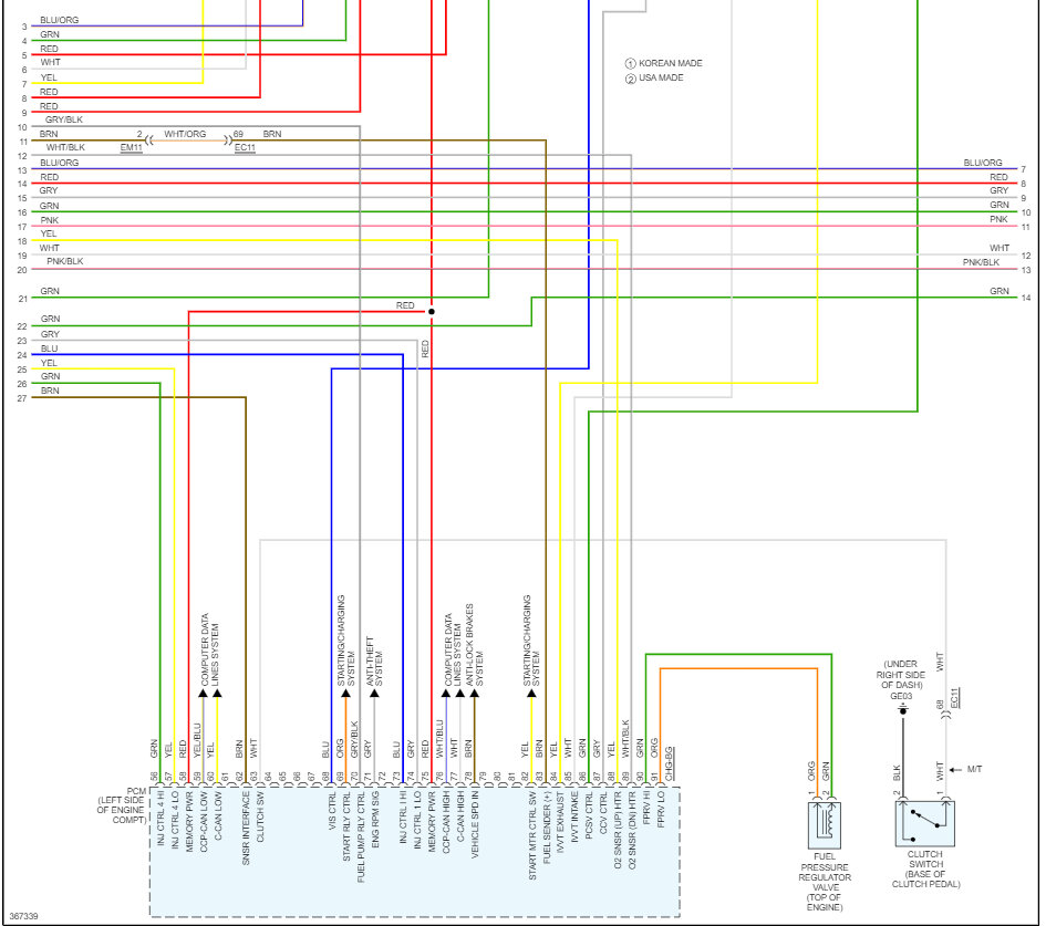

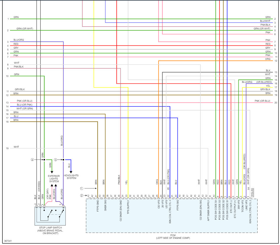

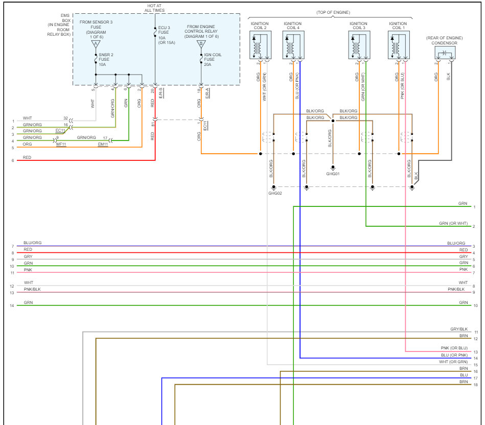

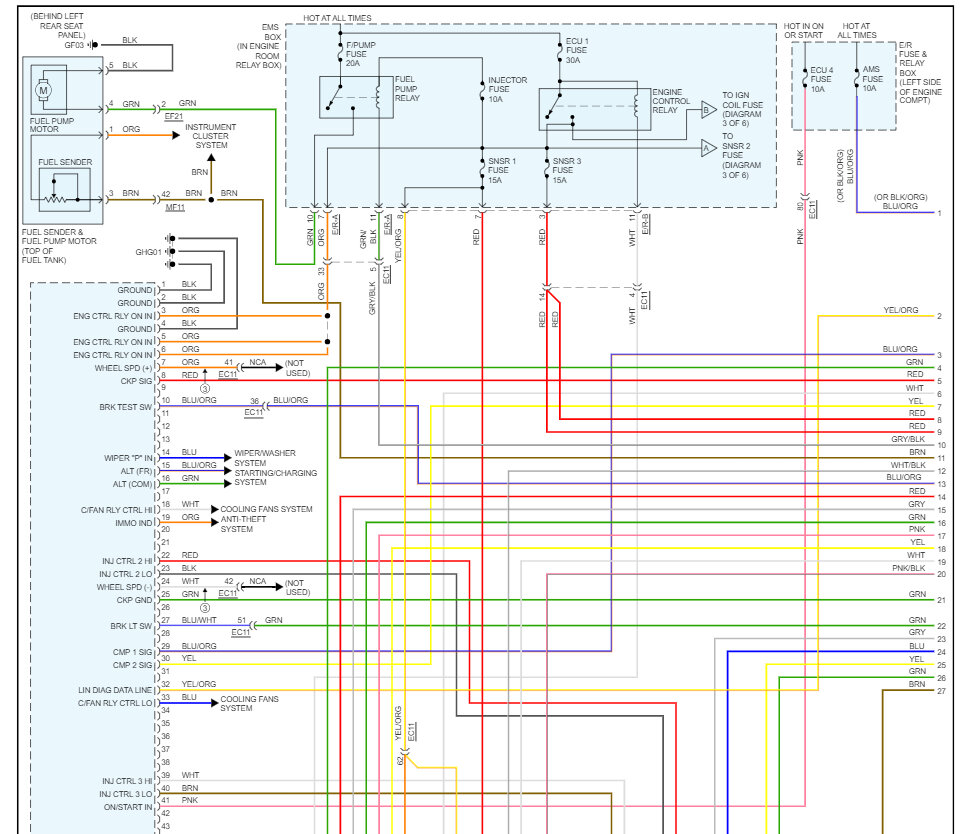

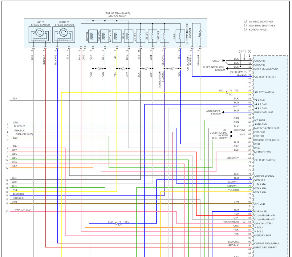

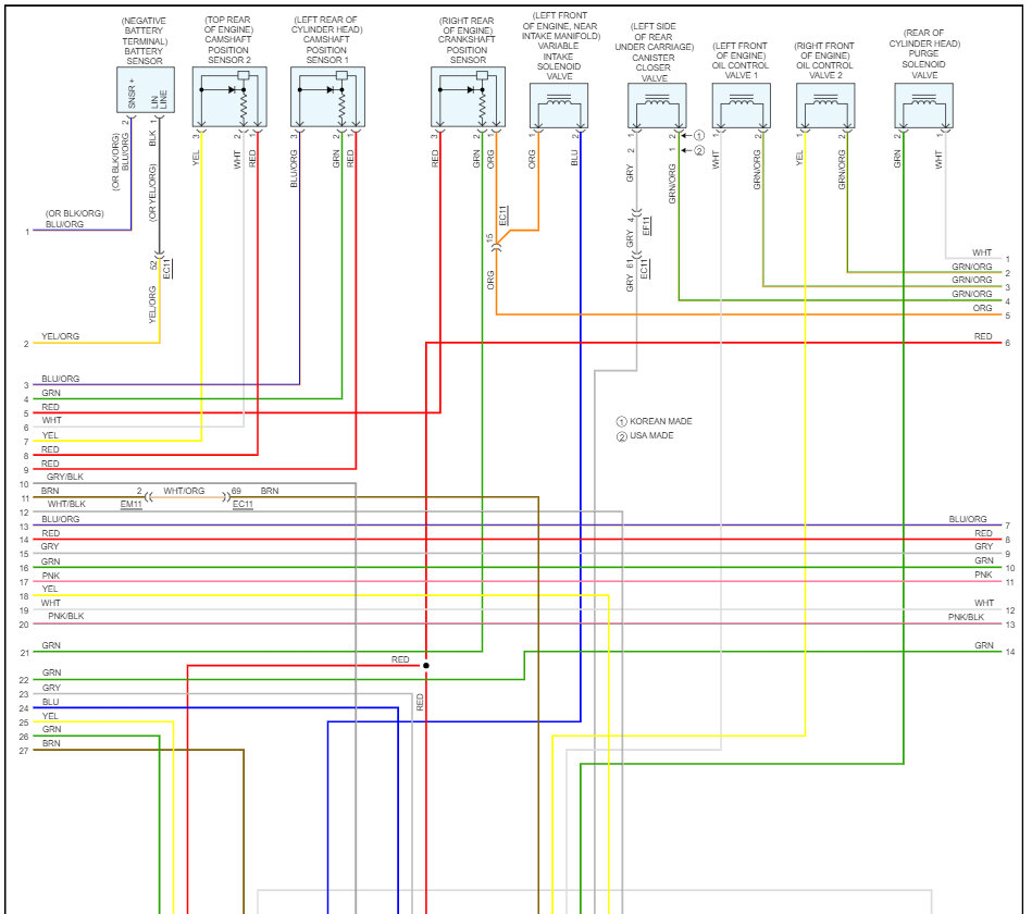

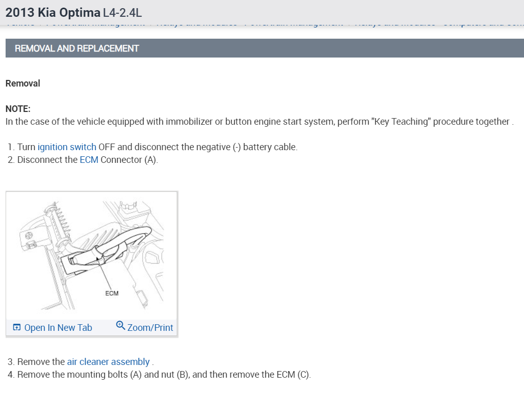

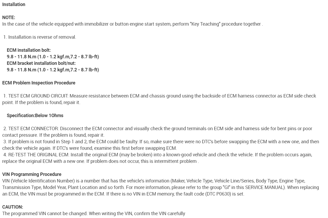

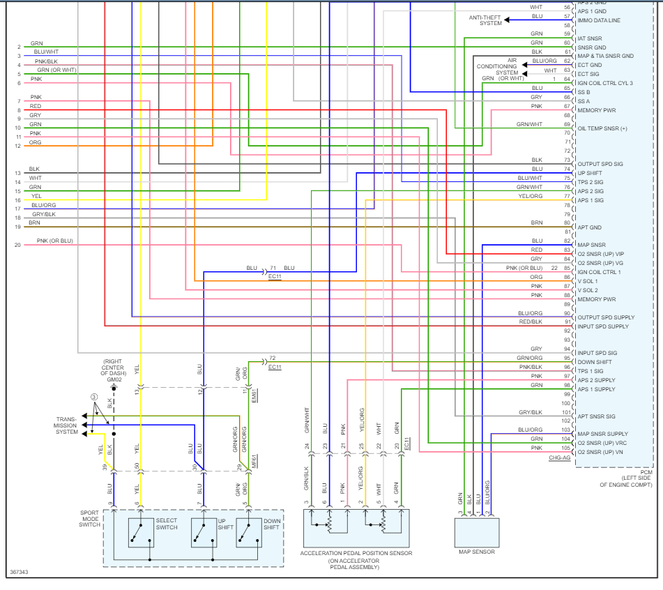

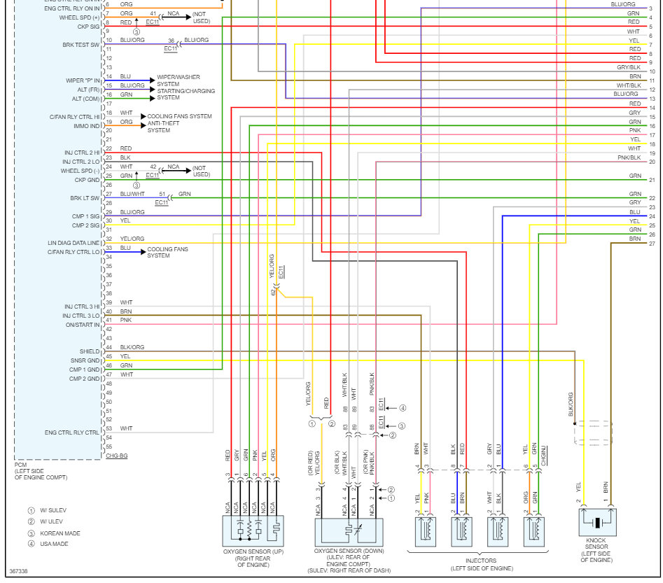

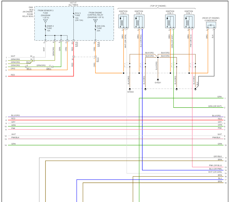

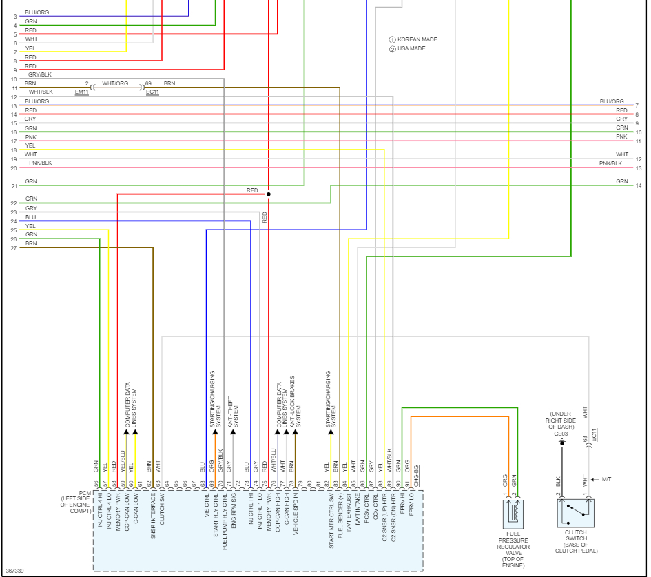

This is a circuit code so you may have a broken wire to the PCM. This guide can help you check, and I have included the engine and oxygen sensor wiring diagrams so you can see which wires to test and how the system works.

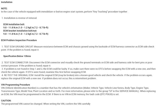

If the connections are good, you have a bad PCM, you can get a preprogrammed unit by searching Google or Ebay. I have included the instructions on how to change that out as well. Check out the images (below). Please let us know what you find.
