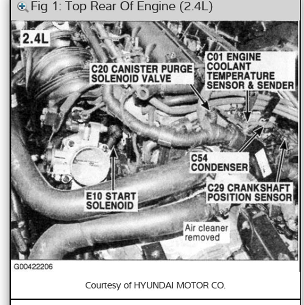

How do you install crankshaft sensor?

undo bolt that holds it in and electrical connection twist and pull old one out. lube new sensor o ring then put back in and carefully hook electrical back up. do this with engine shut off.
Image (Click to enlarge)
