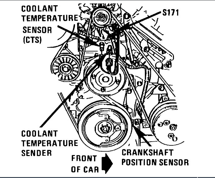

Where is the cam sensor located?
1991 OLDSMOBILE CIERA
217,000 MILES • 3.3L • V6 • 2WD
CAMARO9162
I can't find my cam sensor on my car.
Mar 8, 2023 at 10:10 PM
  • 110,194 POSTS
A camshaft position sensor wasn't used on this engine. The engine is a traditional type with a timing chain connecting the crankshaft to the camshaft. It does have a crankshaft position sensor. It is on the right side of the engine, behind the A/C compressor. See the pic below. Is that what you are looking for?
What problems are you having with the vehicle? I literally had this same engine apart within the last two weeks. LOL
See pic below.
