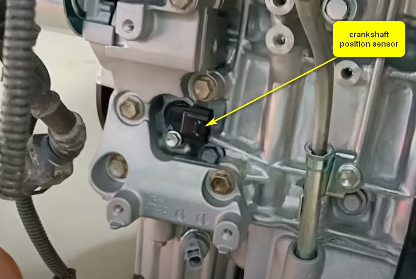

Where is the crankshaft position sensor located?
2009 TOYOTA VENZA
180,000 MILES • V6 • 4WD
LANCE138
Crankshaft position sensor location?
Feb 13, 2024 at 2:28 AM
BORIS K
  • 836 POSTS
Your vehicle is fitted with the 2GR-FE engine.
The crankshaft position sensor is located behind the A/C compressor.
See image below.
Cheers, Boris
