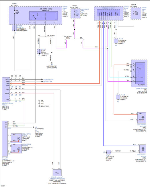

The symptoms are; all warning light on dash are on, the speedometer does not work, the power steering is going in and out, the gears are shifting right and it's an automatic. I replaced the alternator and battery and the alternator isn't charging the battery. This could all be coincidental but it all started when I put in a new radiator fan and ran the wire directly to the fan relay fuse so it would stay on if the car was on so my A/C would work, and the car would not get hot.

four cylinder, LE, gas. I wired the radiator fan so that the fan would turn on when I started the car because both of my fans stopped working. When I turn the key every warning light comes on and stays on after I start it. i had it connected to the relay fan fuse. But after these problems happened, I took it off and replaced the relay. I replaced the alternator and battery also because I thought that was the problem.

So, you wired the fan, then all these other symptoms started, dash lights, shifting issues, power steering going in and out, not charging and this code P0793. But now you have undone the wiring and replaced the relay, and the fans work fine but the rest of the symptoms remain unchanged? Is that right?
