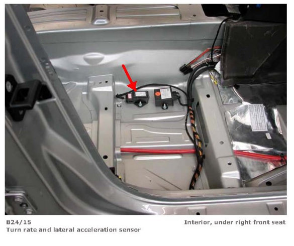

Need to replace the yaw rate sensor and I need to know the location of the sensor in my vehicle listed above (211) e-350.

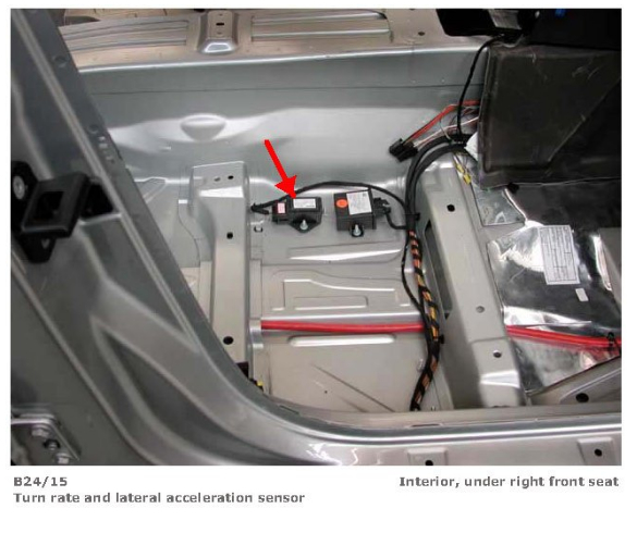

It's location is under the right front seat. I've attached a picture below of its location.If needed I can provide removal and installation instructions.Hope this helps and thanks for using 2CarPros.
