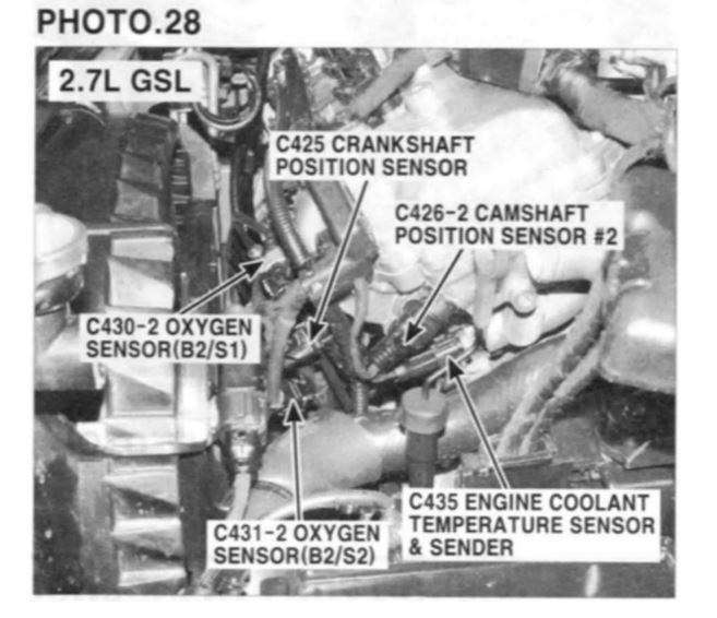

I have the vehicle listed seven seater. Everyone tells me that the crankshaft position sensor is at the top left of engine at passenger side. It is not there. please help me find its location.
Mar 30, 2019 at 8:30 AM
Good evening,
I attached the only location of the crank sensor for you.
Mar 30, 2019 at 11:58 AM

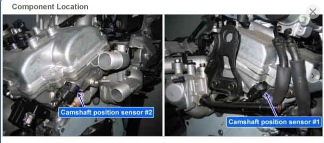

After replacing crankshaft sensor and starter, it turned on. Yay, i am driving again. but now engine light came back on. I checked it, it said distributor or one of my two camshaft sensor is bad. Please, need ur advice, replace what? One or both sensors? Or distributor?
If it is sensors, please include picture of locations. 8-) Thanks.

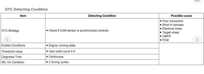

What are the code numbers?
Apr 8, 2019 at 12:24 PM
MIKIA
  • 11 POSTS
Sending picture of report.
Apr 8, 2019 at 12:30 PM
Okay, I posted a description of the code and possible issues.
This sounds like a harness issue.
General Description
The Camshaft Position Sensor (CMPS) is a sensor that detects the compression TDC of the NO. 1 cylinder. The CMPS consists of a hall type sensor and a target on the end of the intake camshaft. When the target triggers the sensor, the sensor voltage is 5 V. If not, the sensor voltage is 0 V. These CMPS signals are sent to the ECM and the ECM uses the CMPS signal for synchronizing the firing of sequential fuel injectors.
