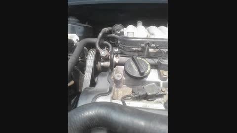

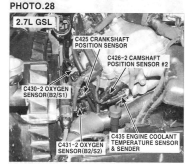

I have the vehicle listed seven seater. Everyone tells me that the crankshaft position sensor is at the top left of engine at passenger side. It is not there. please help me find its location.
Mar 30, 2019 at 3:30 PM
Good evening,
I attached the only location of the crank sensor for you.

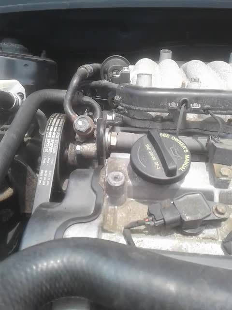

Roy, I thank you very so much. It wasn't easy getting it out due to the fact there was hardly any space. This is the first time i have ever touched a Kia vehicle. I prefer Chevrolet, Honda, Toyota. Anyways, in this v6 motor, how come i am only seeing three frontal spark plugs? Where are the other three located? Please respond ASAP. thank you. God bless.
Apr 6, 2019 at 8:38 AM
The other three are at the back toward the firewall.

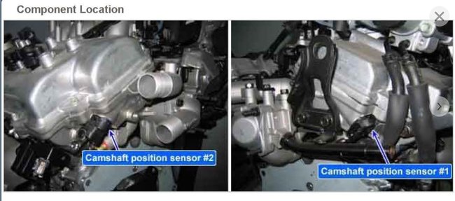

After replacing crankshaft sensor and starter, it turned on. Yay, i am driving again. but now engine light came back on. I checked it, it said distributor or one of my two camshaft sensor is bad. Please, need ur advice, replace what? One or both sensors? Or distributor?
If it is sensors, please include picture of locations. 8-) Thanks.

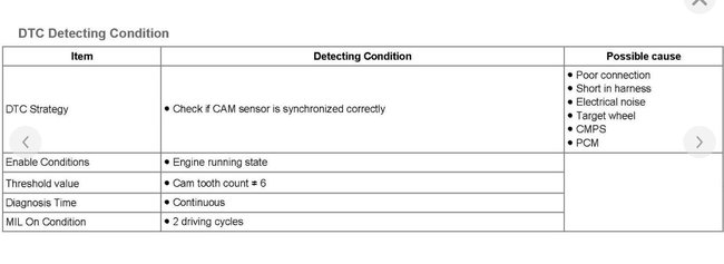

Okay, I posted a description of the code and possible issues.
This sounds like a harness issue.
General Description
The Camshaft Position Sensor (CMPS) is a sensor that detects the compression TDC of the NO. 1 cylinder. The CMPS consists of a hall type sensor and a target on the end of the intake camshaft. When the target triggers the sensor, the sensor voltage is 5 V. If not, the sensor voltage is 0 V. These CMPS signals are sent to the ECM and the ECM uses the CMPS signal for synchronizing the firing of sequential fuel injectors.

Try it and see.
My other concern is the timing chain. If it has slack from wear, the cam and crank sensor may not line up correctly and this code will set.
