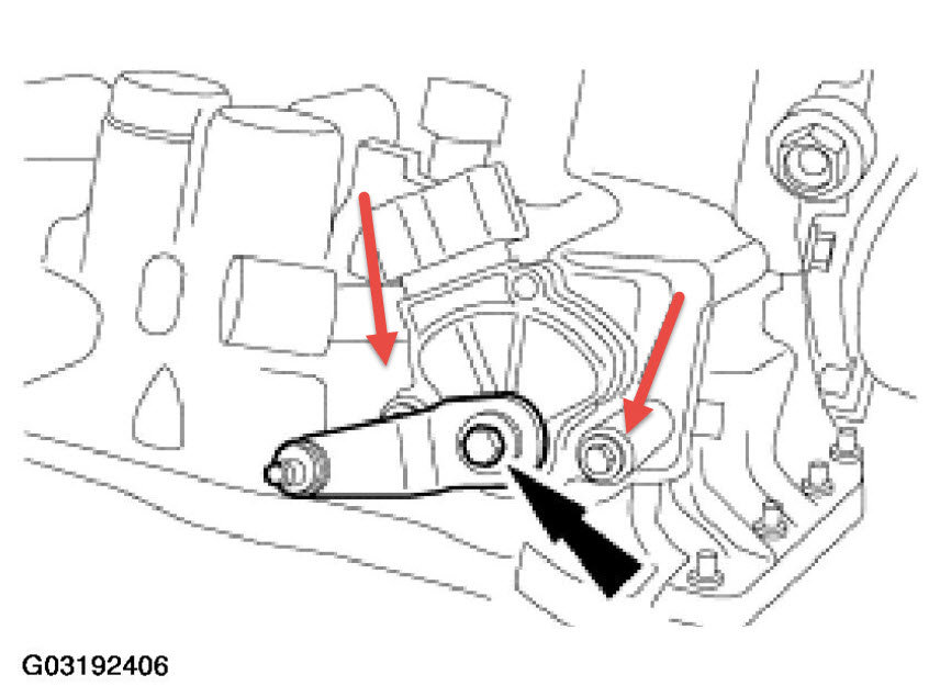

selector shaft seal replacement
2004 FORD FUSION
100,000 MILES • 1.6L • 4 CYL • 2WD • MANUAL
GARTHFUNKEL1984
I have removed almost everything but I cannot get the selector shaft lever off to replace the damaged seal. any suggestions welcome? thanks

we do not have a Fusion in US in 2004 here is one off of a focus, you will need to remove the handle unplug electrical for the switch then unbolt switch to reach the seal. see picture.
