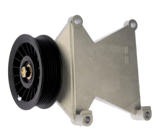

At this point you have three options. Fix the pulley (compressor in this instance), bypass it with a pulley bypass, or get a belt for your engine with no AC and route it as such.

A/C compressor is definitely seized. could you tell me what belt to get to bypass it? I'm broke and can't afford an A/C bypass pulley. Thank you
