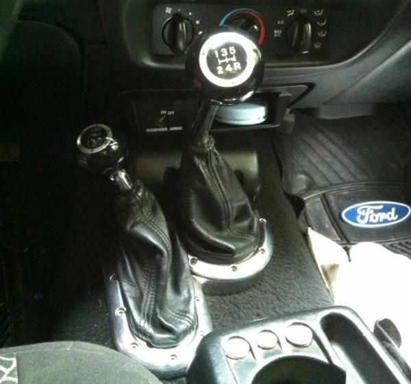

While driving at low speeds or slowing down and taking corners the truck seems to be shifting in and out of 4wd. The whole truck will jolt very hard intermittently.
What I know currently:
Fluid was just changed, reddish brown fluid came out and the transmission fluid was changed a month prior so I know they have not been mixing due to a blown seal. Problem only occurs when accelerating. If in neutral moving forward problem does not occur. Transfer case shifter is not loose and shifts into all gears (2L-4H-N-4L). Shifter linkages are tight and appear to have no damage. No check engine light. With vehicle on jack stands problem does not occur. Front and rear driveshafts do not spin freely without turning the wheels when in 2L.
My troubleshooting has led me to believe: 1. Internals of transfer case are broken (what would be broken I do not know). 2. Front axle is broken internally.

Manual transfer case, permanently locked front axle (not sure how this works but it is like having manual hubs that are always locked in and can not be unlocked).

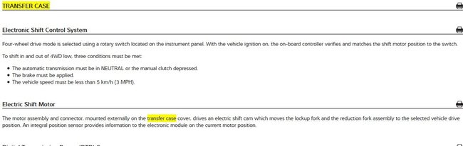

Yours is the live axle assembly. Basically, the connect/disconnect is done at the transfer case, instead of at the hub, which means that you do not have to manually lock and unlock the hubs.

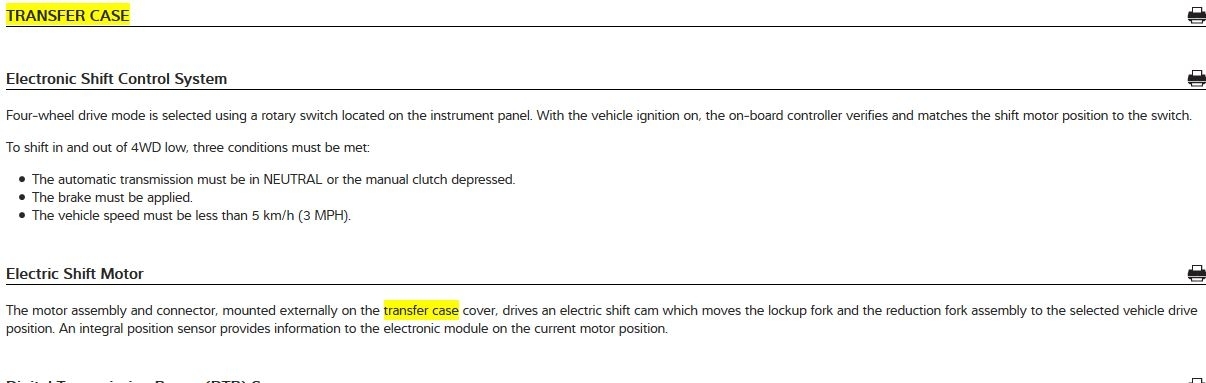

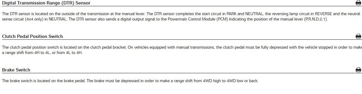

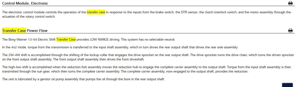

The images below describe how the transfer case works.
You might try simply unplugging the 4x4 switch and see if anything changes. I have seen 4x4 problems (such as unwanted operation) to simply be a short in the switch. If it stops when the switch is out, then we can (1) look into further testing of the switch or (2) simply get one from eBay or the local salvage yard.

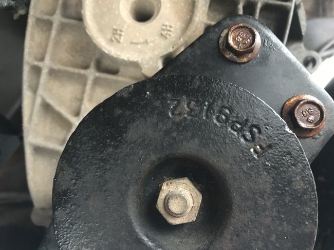

I understand how my differential works now. Not sure if you know that my transfer-case is manual and has no switches. Still went and tried driving with my one electrical connector that goes to the transfer case unplugged (pretty sure it is just a sensor that tells which 4wd light to come on) and my problem is still there.

Sorry. I just realized that you are talking about a manual transmission, and Prodemand and AllData do not show a manual transmission as an option for a 2002 Ranger with the 4.0L engine and 4x4. I completely missed that. The 2002 Ranger with the 3.0L engine and 4x4 does show as having a manual transmission option. Neither shows having a 4x4 setup that is run by a lever instead of an electrical switch. So I do not know exactly what is going on there, so I will try flying blind until I can figure it out. It is possible that this is a really very super simple fix. You might just need to get under the vehicle and grease the various linkages on the transfer case. Sometimes, when these things get dirty, they just do not move quite like they are supposed to. Especially with manual shift setups. You might check the linkages and make sure that the are tight, and not out of adjustment (hard to tell, I know, but give it a shot).
In the meantime, if you can get the VIN# for me, it might help me figure out exactly what is what here. And is this a US market truck, or is it some other market?

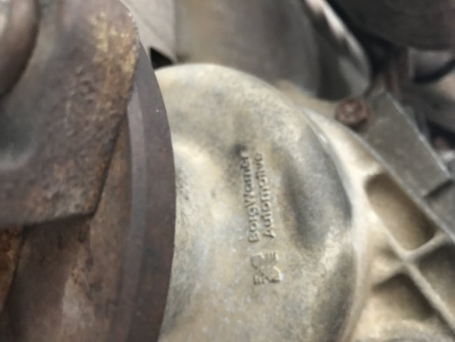

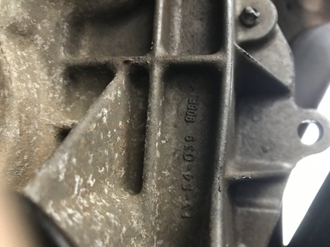

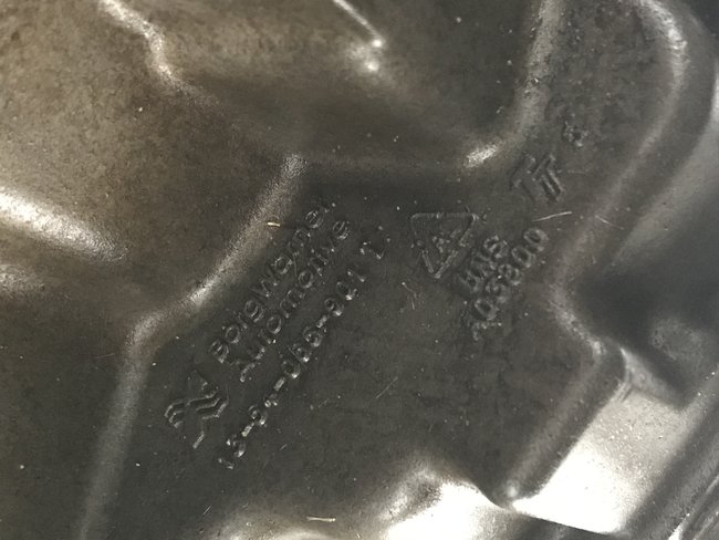

2002 4.0L V6 Fx4 Off Road model. The linkages look fine to me and the hardware that secures it is tight. It shifts through all the gears fine so I do not think that it needs greased. I do not have a VIN on it I believe. It is a Borgwarner model 13-54. Here is the rest of the numbers that are on the transfer case.

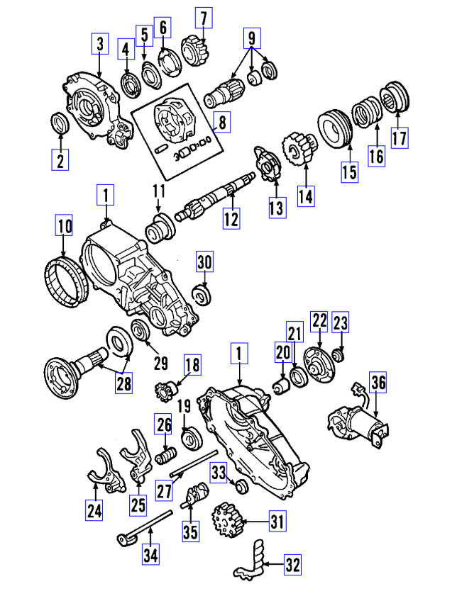

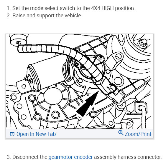

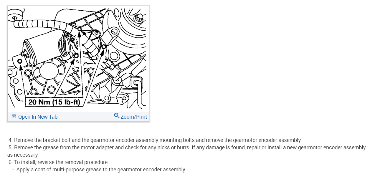

It sounds like the encoder motor is not pushing the transfer case all the way into gear. I would start by changing it. Here are diagrams to help you see how the system works and how to change the actuator. Check out the diagrams (below). Please let us know what happens.

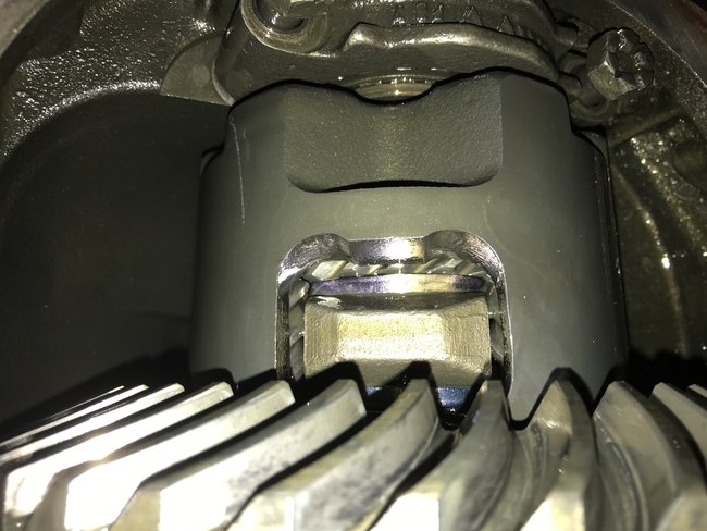

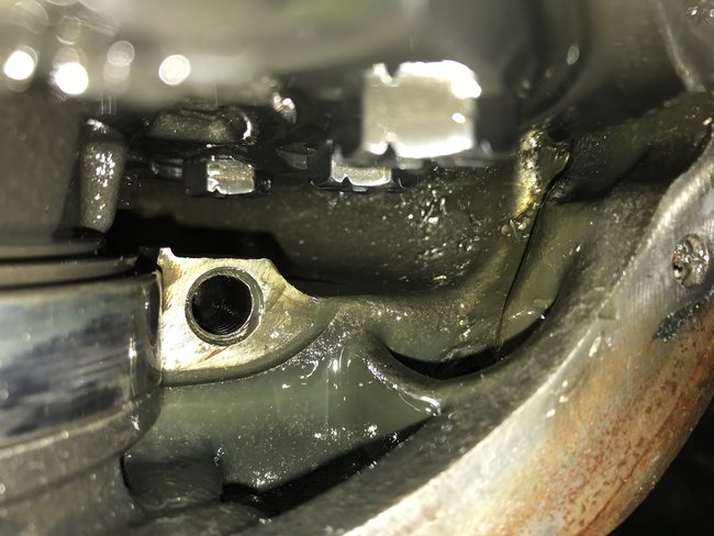

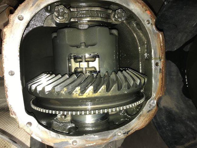

Okay, so new diagnosis. The front differential is out of the question now. I took off the front drive shaft and drove my truck around and the problem is still there. While it may still be the transfer case I am leaning towards more the rear axle is messed up. Took off the cover and there was quite a bit of shavings and metal chunks inside. Only saw some minor damage to one gear. The pencil sharpener style gears is what i’s on the inside but they have a cover around them which is what “The Medic” was talking about. Going to look up what could or might be causing my problem and see about taking the differential apart further. (Yes I did take off the bracket on the left side)

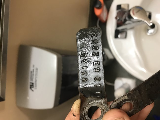

V313A
4L10 88 2D03
Nov 30, 2018 at 10:07 AM
CJ MEDEVAC
  • 11,004 POSTS
That is the tag on the outside, probably the original set-up.

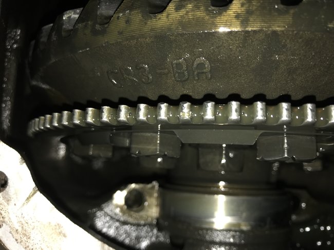

CR3-BA is stamped on the big gear in the differential.

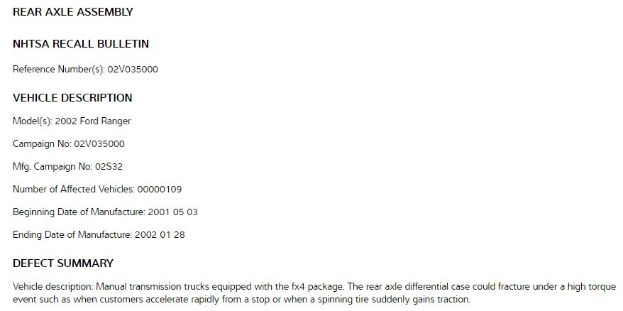

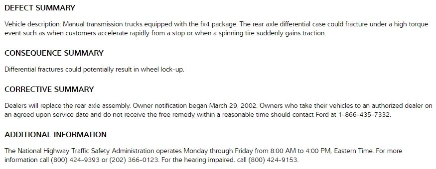

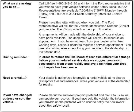

I did find this a few minutes ago.
I do not know if it will help you now.
The Medic
Dec 1, 2018 at 10:17 AM
CJ MEDEVAC
  • 11,004 POSTS
This is probably the same thing.
The Medic
Dec 1, 2018 at 10:24 AM

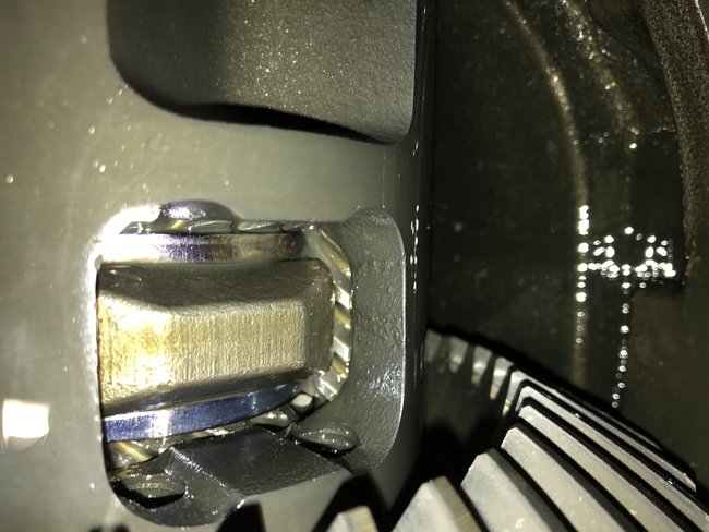

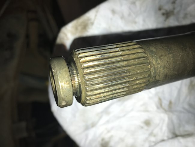

Anyway I can still get that deficiency corrected? I opened up my differential further and there is quite a bit of shredded metal in there. Here is one of the axle shafts I pulled. Do not have enough experience to know if it is bad or not.
Dec 1, 2018 at 10:26 AM
CJ MEDEVAC
  • 11,004 POSTS
If there are no chunks missing, the splines I can see in your picture look just fine.
I believe your problem is in the differential itself, so far I have not found an exploded view or anything except that recall that might shed some light on exactly what might go wrong with the differential.
Maybe one of those phone numbers or some homework might, at minimum, hook you up to a Ford tech guy that might tell you what their solution was (rebuild, replace, replace with a different unit).
It would be nice if it was still considered an issue and they might take care of it.

Ford will not replace it since “it does not have any recalls on it” and it is a salvaged vehicle. Right now I am looking at getting a new axle assembly from a junk yard. Found one for about $260.00 or I was going to try to find a rebuild kit for the carrier that I have currently. Figured whoever installed this aftermarket carrier never made proper adjustments in the first place so that is why it broke. A low end carrier costs around the same price as a new axle assembly from a junk yard.

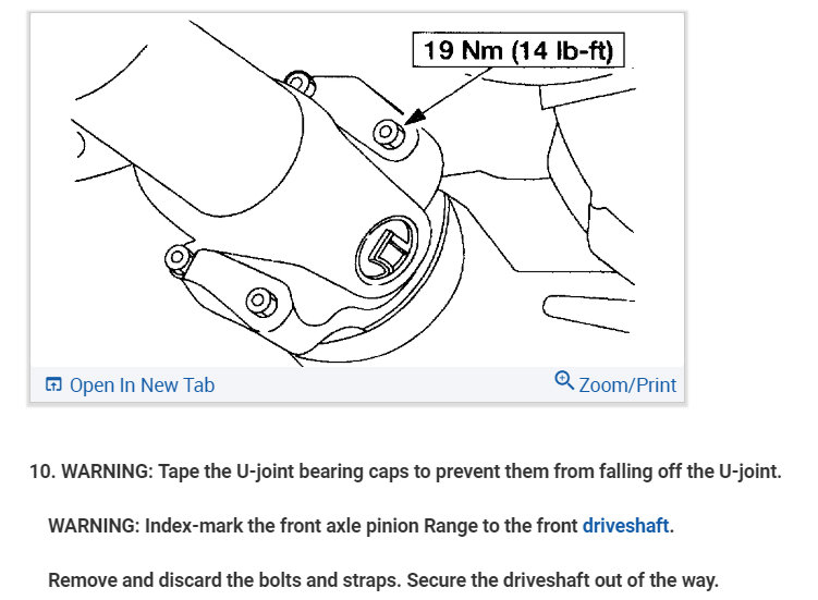

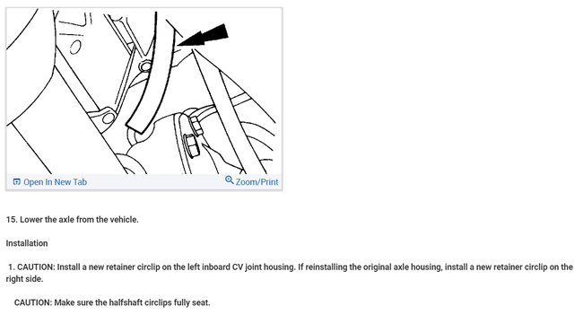

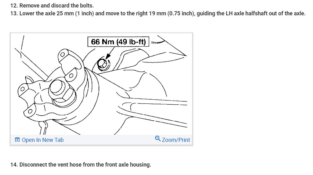

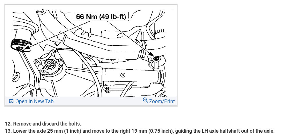

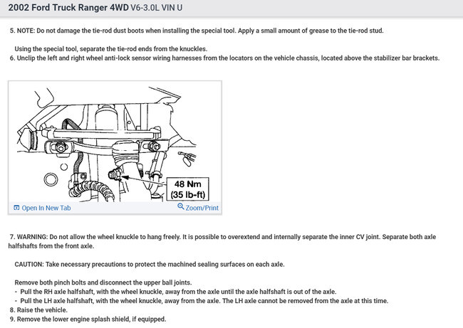

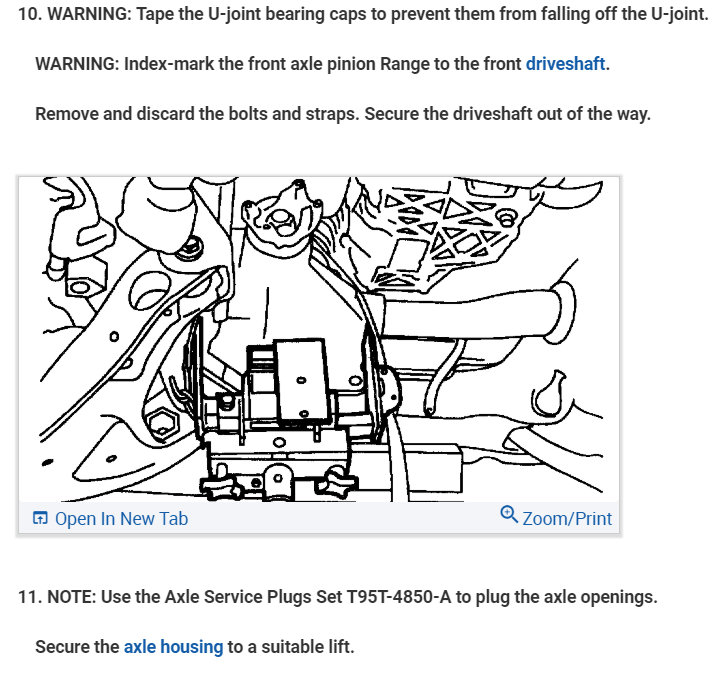

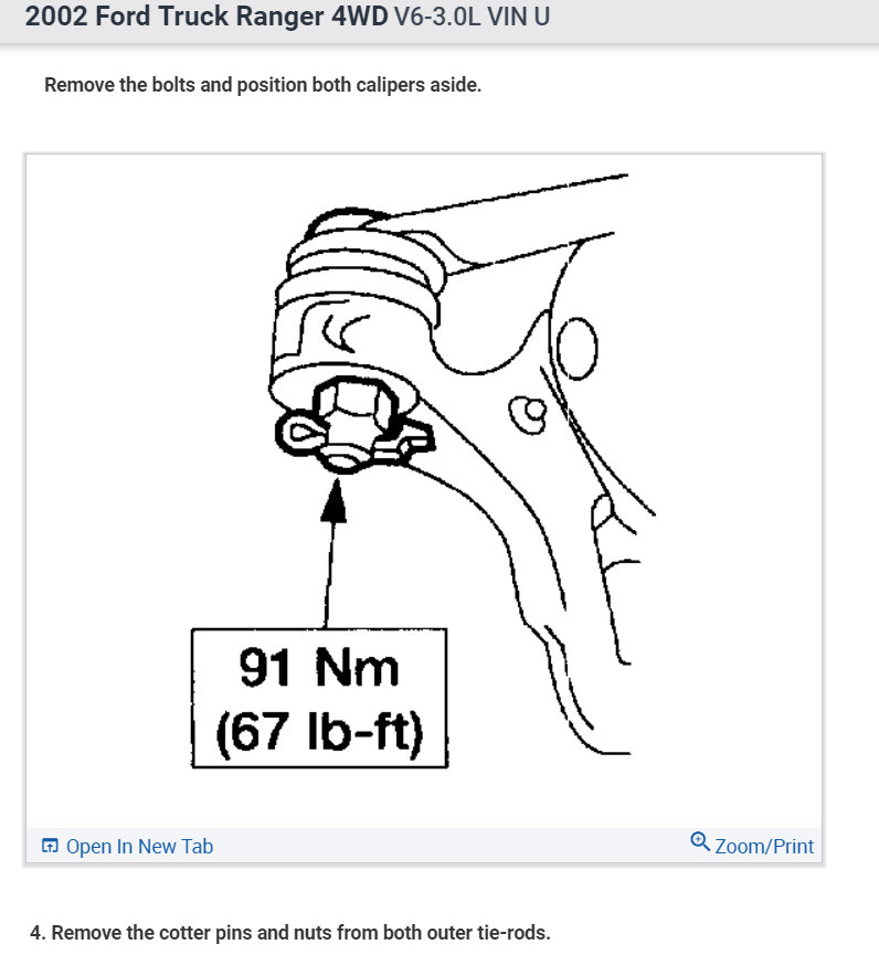

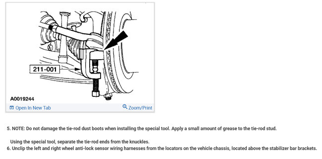

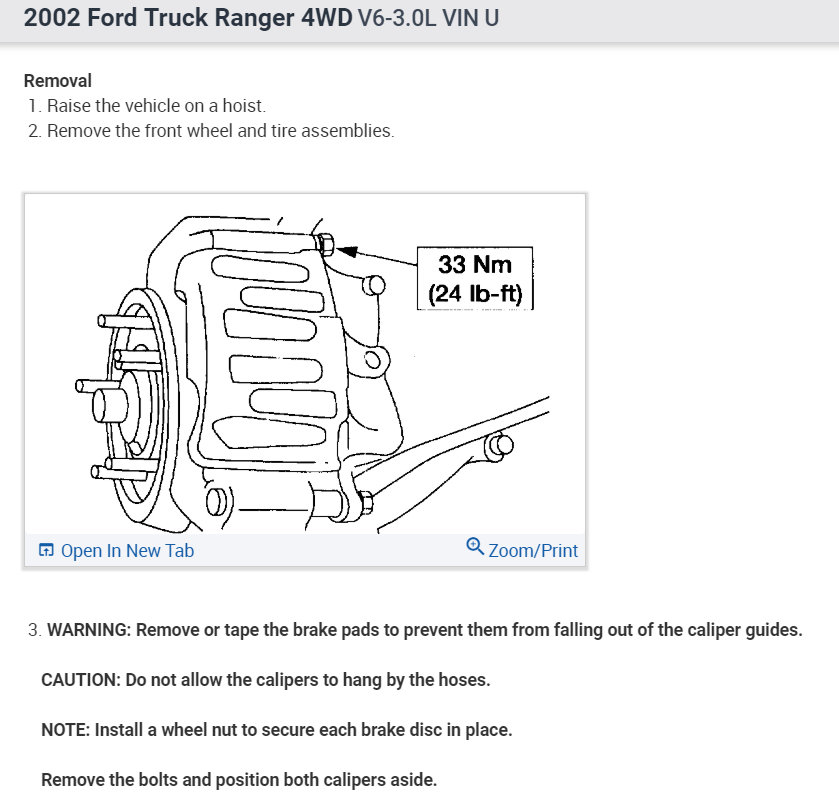

Yep, you are headed in the right direction. Here are diagrams and instructions to help show you how to remove the front differential:
