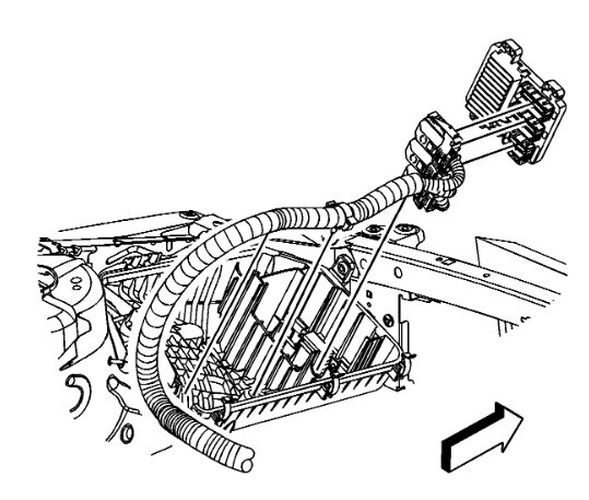

Just recently my car has been doing the following, but only on occasion:
1. When I turn the key to the ON position, the normal functions activate as expected, but when I turn the key to start the car, nothing happens. No sound, no attempt to start, nothing.
2. While the key is in the ON position but the car is unable to start, three warning lights appear on the dash. The anti-slip/hydroplane light, the ABS light, and the red 'BRAKE' light.
3. Then, after I try starting the car a few times, eventually the car reacts to me turning the key and the car starts. I do not know why the car won't start sometimes and sometimes it does. I don't change anything that I am aware of.
4. However, when the car starts, the three dash lights mentioned earlier are still on, the vents blow air but the A/C doesn't work, and the gear indicator on the dashboard (PRND) does not respond to me shifting gears. So, I am able to shift to reverse or drive and the transmission functions correctly, but the lights on the dashboard do not reflect this change. The gear indicator remains on 'Park'.
5. Then, if I begin to drive the vehicle with all the aforementioned problems, soon I get a dashboard warning saying 'Service Brake Assist'
6. Soon after the 'Service Brake Assist' light goes away, then the following things occur:
- The door locks engage
- The A/C begins working
- The dash lights go away
- The gear indicator updates and correctly shows which gear the vehicle is in
Then the vehicle drives normally for the duration of the trip. However, the next time I start the car, the same problem may or may not recur. Are you able to help me with this problem?

Yep, it sounds like there is a problem in the CAN, either the PCM or BCM is going out, either way you need to do a CAN scan which this video can show you how, then we can gather the codes and go from there:
https://youtu.be/u-4syLc-ifQ
Also, you might want to try and do a hard computer system reboot, this guide can help with that:
https://www.2carpros.com/articles/step-by-step-guide-performing-a-hard-system-reboot-for-your-vehicles-electronics-systems
This can be the internal mode switch inside the transmission can be going bad and shorting out which may affect these other systems. Please go over these guides and get back to us.

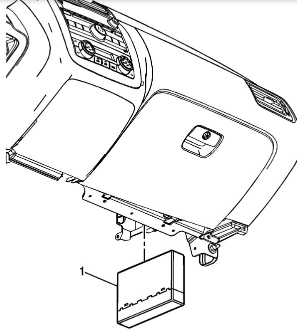

This is common when the BCM goes out. I would, search ebay to find a preprogrammed unit you can swap it out with. Here is the location. Check out the images (below). Let us know how it goes
Aug 7, 2025 at 11:18 AM
DSCHWINDT
  • 51 POSTS
I replaced the BCM, but that has not solved the problem. I also rebooted the computer after it was installed. Today while driving, I noticed the tachometer and speedometer froze at a certain point so that my RPMs were 1900 and my speed was 39 when I was stopped at a red light. However, all the aforementioned errors and these new ones are intermittent. They happen on and off as I drive, and when I got home my car wouldn’t start again.

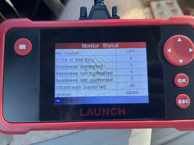

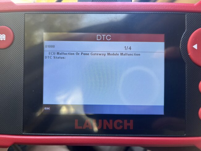

Does the canner still not connect?
Sep 2, 2025 at 12:28 PM
DSCHWINDT
  • 51 POSTS

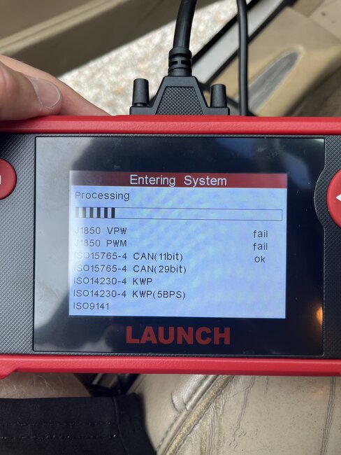

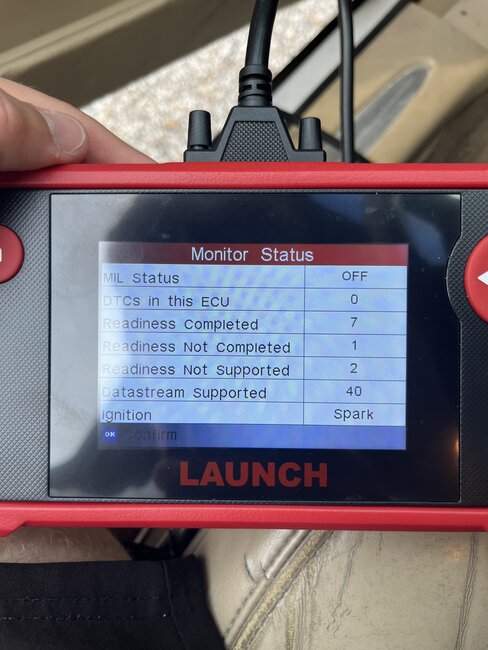

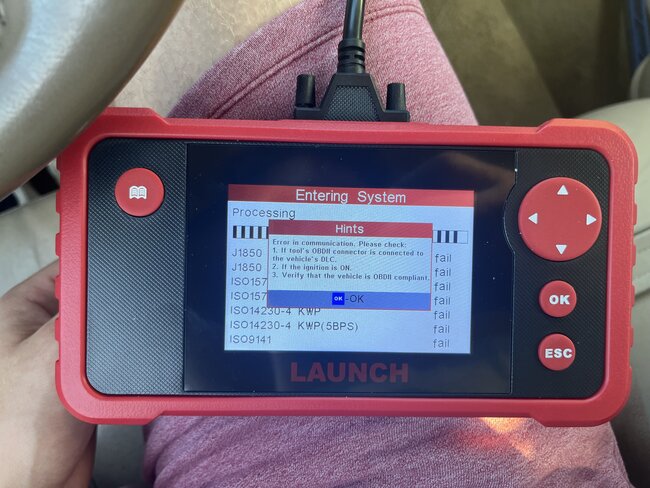

The first image shows the final screen before it switches to the second photo. Is that showing that it connects or no?
Also, are you thinking the PCM replacement changed anything? I get free returns, so just seeing if I should return it or not.
Sep 7, 2025 at 9:12 AM
  • 55,798 POSTS
Yep, there are no codes in the ECU, but I don't think that is a CAN scanner. Also, we might be barking up the wrong tree, it can be the ignition switch. Lets get a CAN scan done
and here is a guide to help check for power output of the ignition switch, test for power at the white, pink and brown wire with the key on. Here is the guide and the switch location.

https://www.amazon.com/dp/B073GW5MTS?ref=ppx_yo2ov_dt_b_fed_asin_title
This is the scanner that I own. Is this not the same one in the link of the YT video you sent? It looks the same to me.

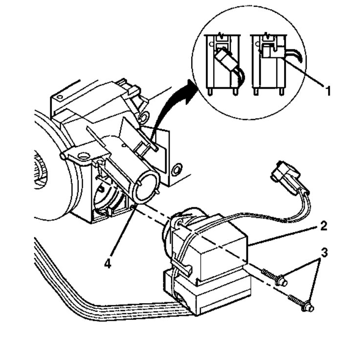

Also, I got the image of the ignition switch location. You mentioned a 'guide'. Did you intend to send a guide as well?
Sep 8, 2025 at 9:18 AM
  • 55,798 POSTS
Yep, I forgot to add the guide which is:
I went over the scanner you have and it does not scan the CAN system which included the BCM and HVAC systems. I would check the ignition first and if it is not he problem go for the CAN scan.
This is the next level up scanner the does the BCM for $169.00
https://amzn.to/3I7T9nk
Let us know how it goes.

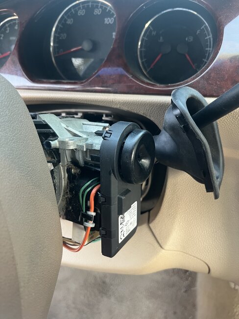

Also, now that we’re considering the ignition switch, perhaps I should mention another thing my car does. My car routinely thinks the key is in the ignition when it is not. When I pull out the key and open the door, the door chimes as if the key is in the ignition. Usually, if I put the key back in and jiggle it a couple times the chime stops. Does this make you think the ignition switch is faulty?
Sep 9, 2025 at 9:13 AM
DSCHWINDT
  • 51 POSTS

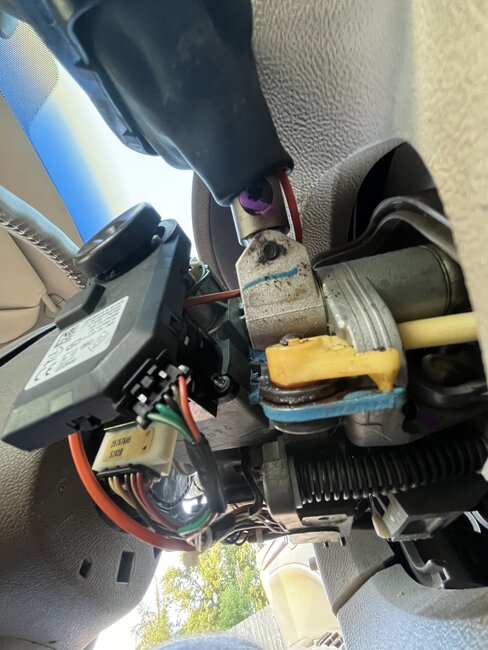

Here is the ignition switch. The guide you sent shows how to use a test light (which I have), but it didn’t say anything about how to use it for my situation. I assume different wires should be receiving power depending on what position the key is in. How can I use the test light to verify my problem?
Thank you for your continued assistance.
Sep 9, 2025 at 10:12 AM
  • 55,798 POSTS
Nice work, please test for power at the white, pink and brown wire with the key on. Use the test light.

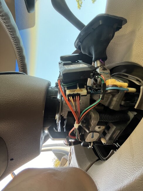

My car has two ON key positions not including the OFF position. I will note whether each wire is receiving power at each position.
White:
This wire is receiving power when the key is OFF. It only receives power when the key is in the ignition and in the OFF position. It is not receiving power when the key is in either ON position.
Brown:
This wire is not receiving power when the key is in the OFF position. It is receiving power when the key is in either the first or second ON positions.
Pink:
This wire is not receiving power when the key is in the OFF position. It is not receiving power when the key is in the first ON position. It is only receiving power when the key is in the second ON position.
I ran this test initially when my car was malfunction and unable to start. I now ran the test again when my car is able to start, and I got the same results. What are your thoughts on the results?

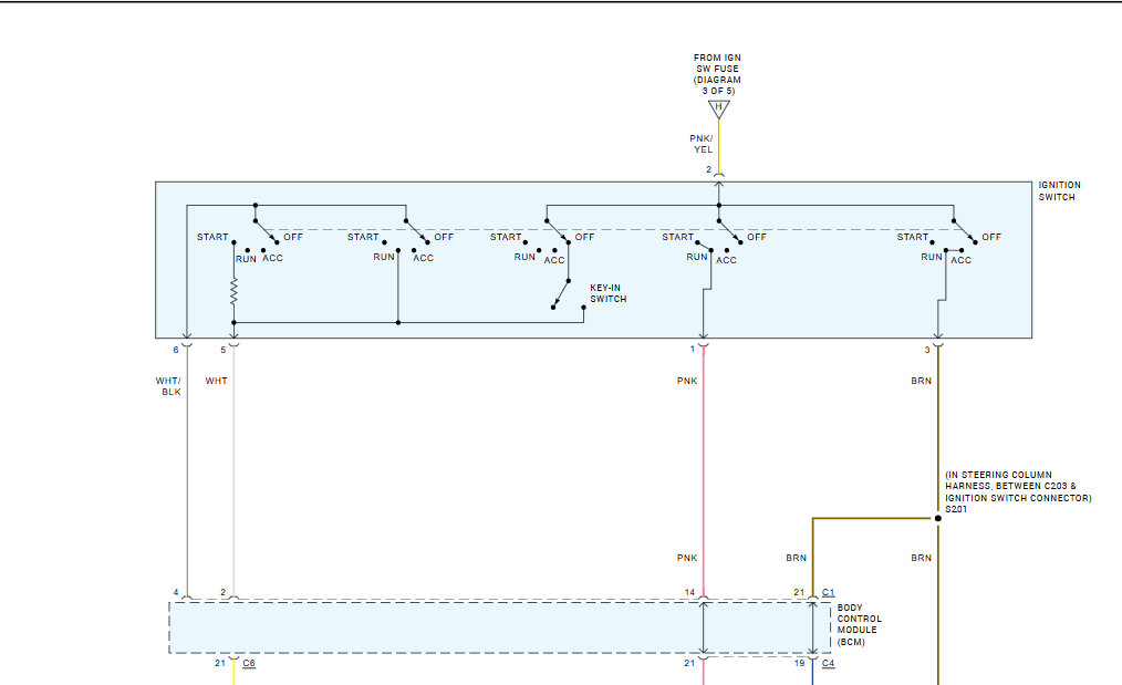

Sorry for the delay. Here is a wiring diagram so you can see what wire should be hot when. Check out the images (below). Let us know how it goes
Oct 14, 2025 at 5:05 AM
DSCHWINDT
  • 51 POSTS
I understand the diagram to say the following:
Brown should receive power only when the key is in the ACC and RUN positions.
For my car, brown receives power in these two positions but also when the key is in the START position.
Pink should receive power only when the key is in the RUN and START positions. This is accurate to my vehicle.
White should receive power when the key is in the OFF, RUN, and START positions.
For my car, white only receives power when the key is in the OFF position.
Could you confirm whether I am reading the diagram correctly?
Oct 16, 2025 at 10:14 AM
  • 55,798 POSTS
White should have power in the start and run position, it looks like the ignition switch is bad, you have found the issue.

Okay, I’ll look into getting that replaced. Do I need to replace the whole cylinder or is the linked part sufficient to replace?
https://www.walmart.com/ip/Ignition-Switch-Compatible-with-2006-2011-Buick-Lucerne-2007-2008-2009-2010/1953954588
Oct 18, 2025 at 3:24 AM
  • 55,798 POSTS
That is the part to change all righty.

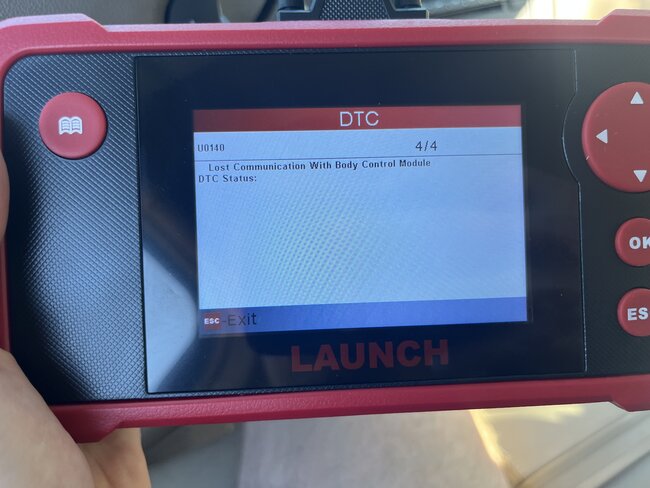

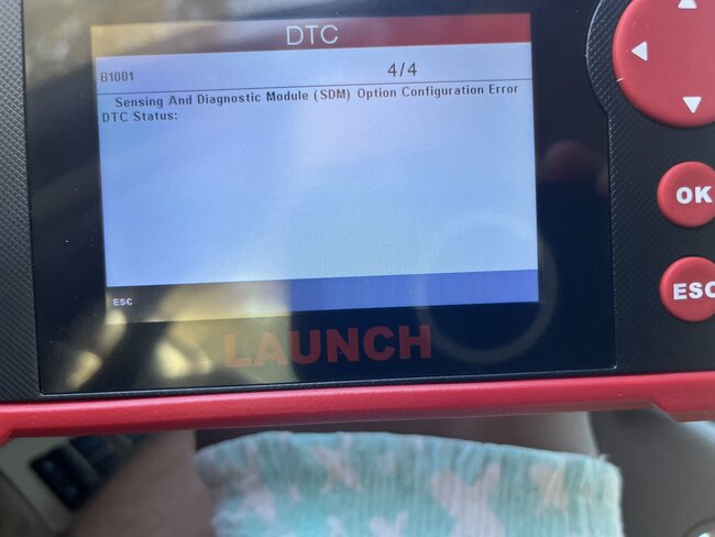

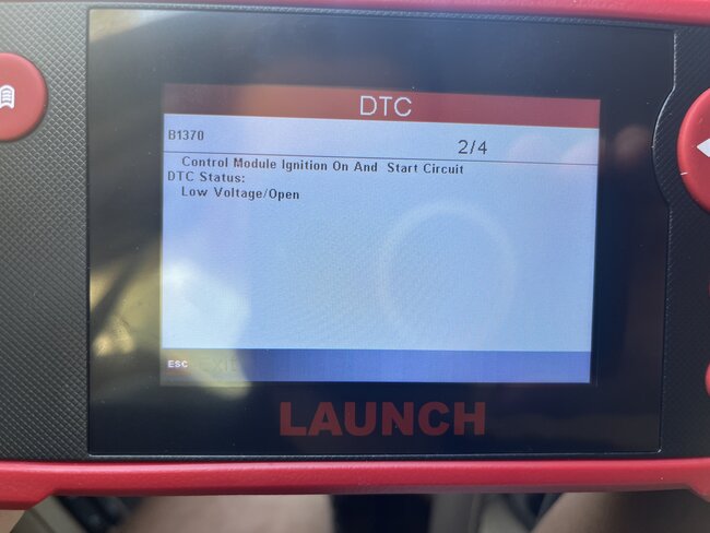

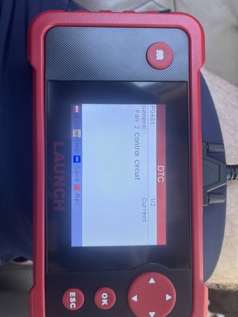

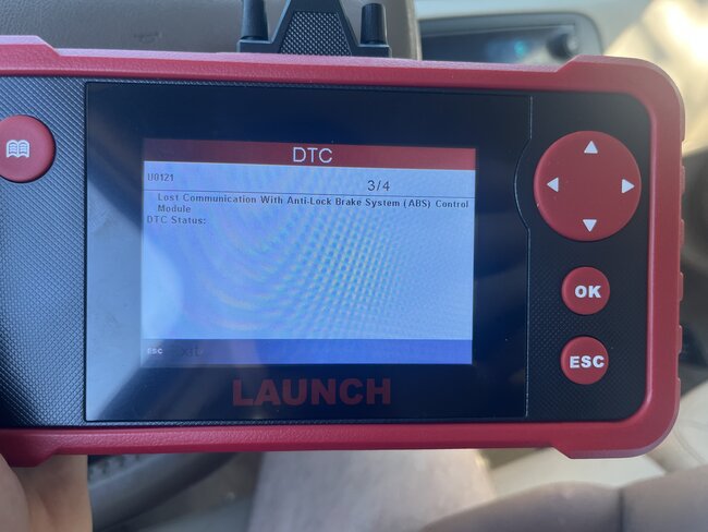

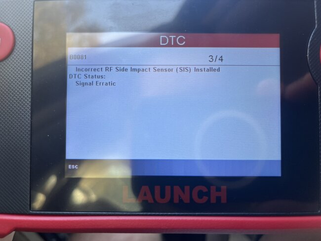

Okay, thank you, I will go over that. Also, the check engine light came on yesterday and I am receiving the following code in the image. Is this possibly related? How should this issue be addressed?
Sep 3, 2026 at 5:48 AM
DSCHWINDT
  • 51 POSTS
I know this is a lot… sorry about that. My OBD scanner has two options when scanning - OBD and Scan. I don’t know the difference, but the OBD option only gives the code in the previous message. When I run Scan I get the codes shown in the following images. The ‘Lost communication with ABS’ one seems to describe the issue well because the ABS light/warning appears on the dash for just a moment, and that’s when the A/C and instrument cluster start malfunctioning.
Sep 3, 2026 at 5:53 AM
  • 55,798 POSTS
Yep, you are loosing power to these modules, I would check the pnk/yel wire has power at the ignition switch before you go any further.
