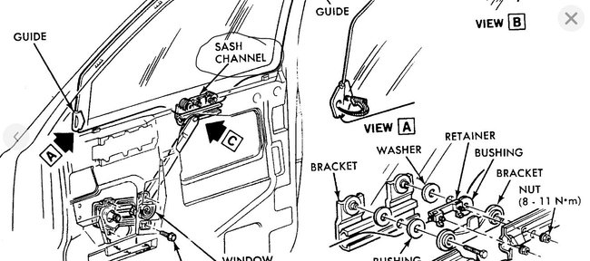

I have been researching for a couple days on the name of the part that holds the driver and passenger windows to the window regulator. No I am not looking for the window clips, I am looking for the part that hold the window with clamping force of two bolts. It has a track inside of it to run on the roller. The only thing I could find is this image. I need to know the name of the entire assembly to the right in this picture. My vehicle has manual windows. Any help is greatly appreciated!

Good afternoon,
I cannot see the picture. It is way too small for old eyes like mine.
Do you mean the piece that goes on the edge of the window and goes into the track for guiding it up and down?

No sir, I'm talking about the clamp that has two bolts that go through it and the window. It has a little "channel" in it that lets the window regulator. Roller go through it. It's location is at the bottom of the window.

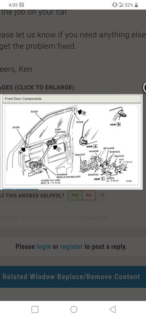

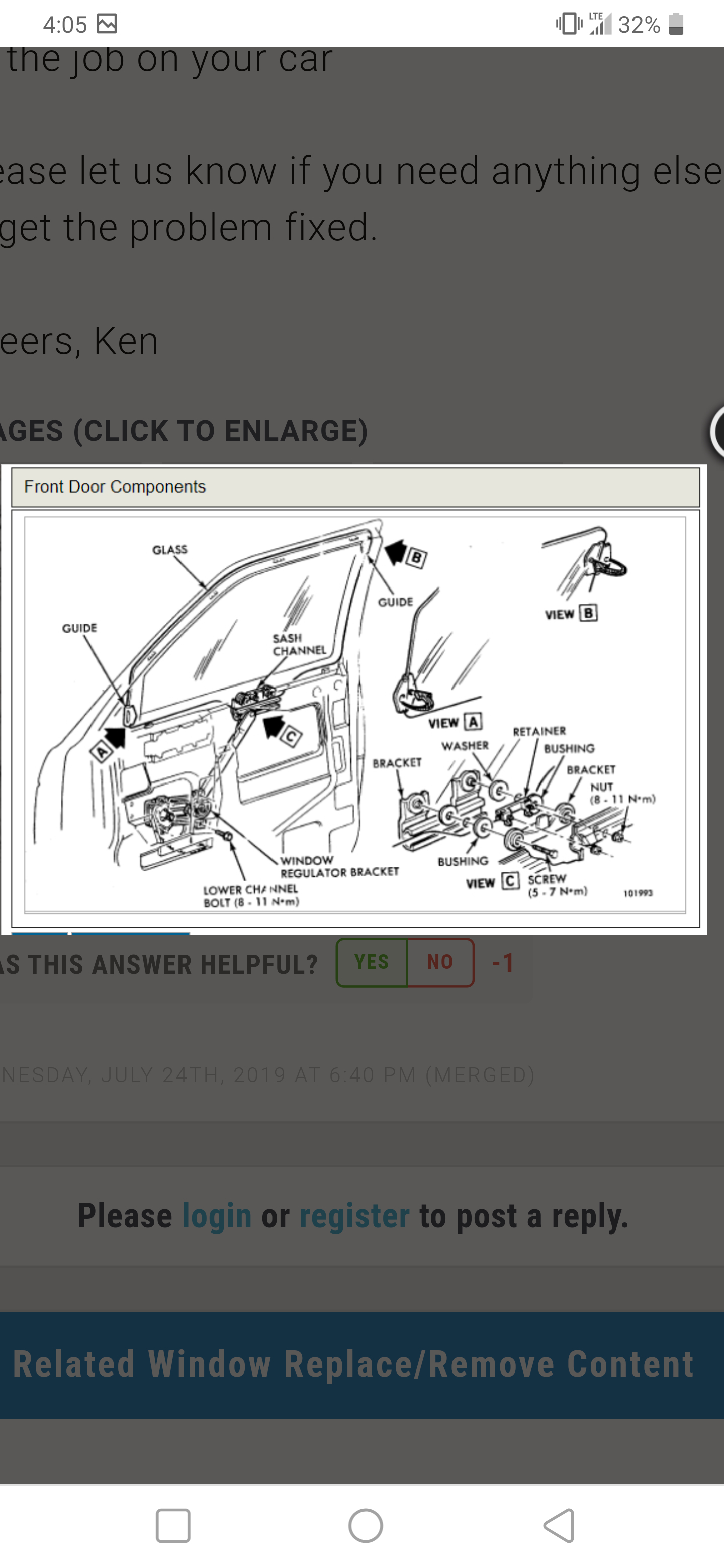

Maybe this is better.

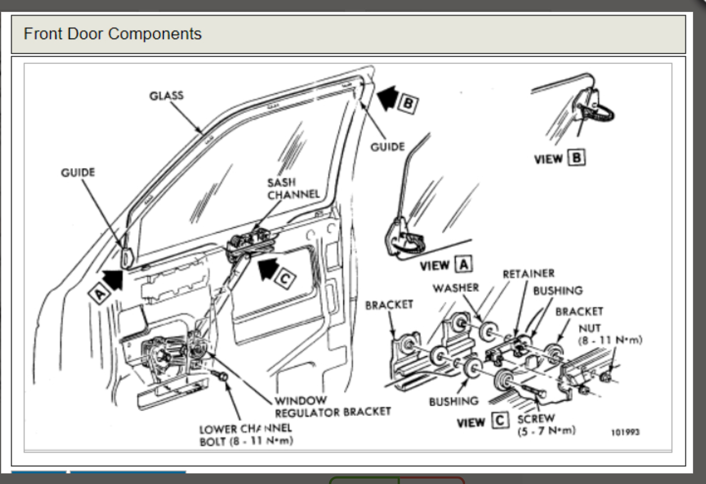

Okay, got it.
It is called a sash channel for the window. I attached a picture for you.

Sorry sir, I was on mobile. Okay so it's called a window sash. Now is just the tough part of finding it anywhere online. I do greatly appreciate your help though!
