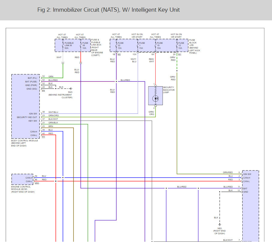

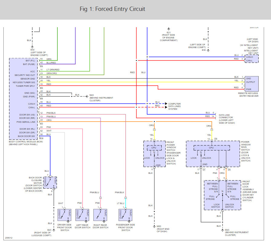

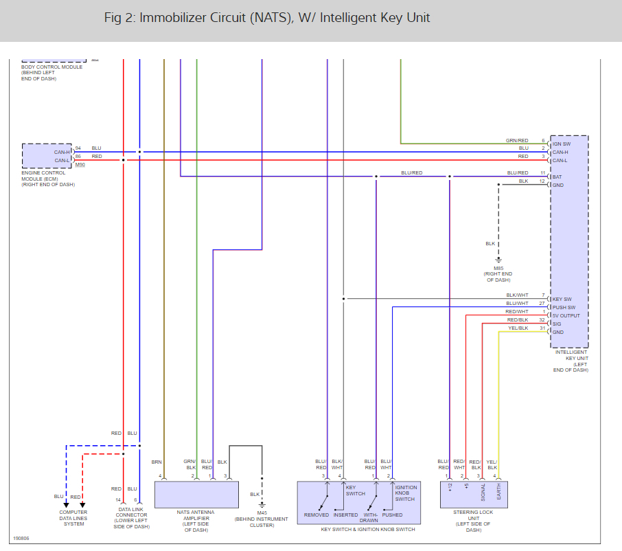

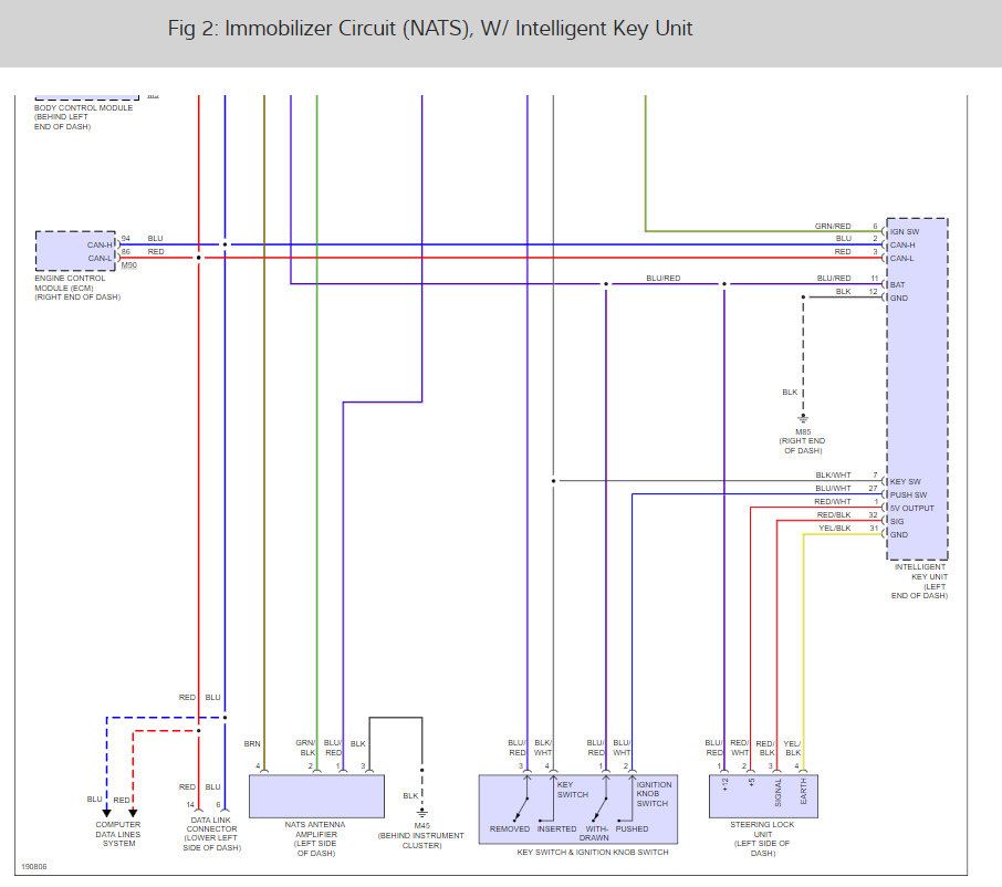

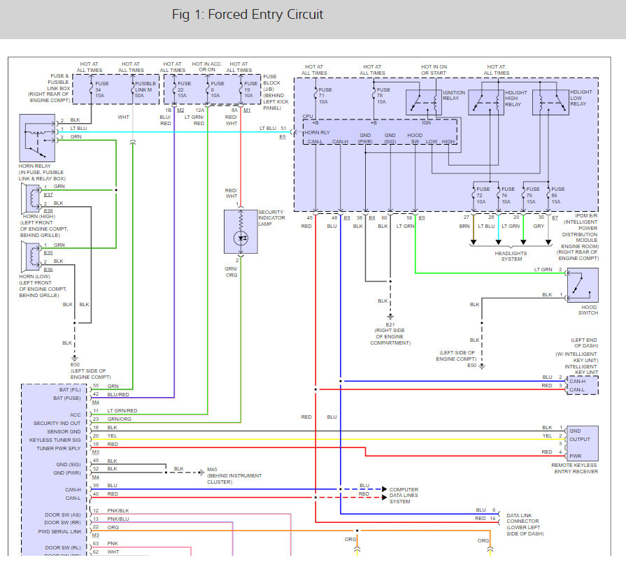

My problem is , I have dtc P1610 and two keys are good. I can make diagnostic in both ECU, ( BCM and ECU ) my problem is that code avoid my car to start. I need wiring diagram to control wise maybe some wire not connected. Because turn signal not working and central lock. Thank you for help.

Here is a guide to help you test the wiring and power with grounds and the wiring diagrams for the security and forced entry systems:

Thank you very much Mr Ken, your diagram helped me. I found a problem was in inside BCM. Water was entering in BCM through sun roof, wiring was good. Thank you for your help, I appreciate it.
