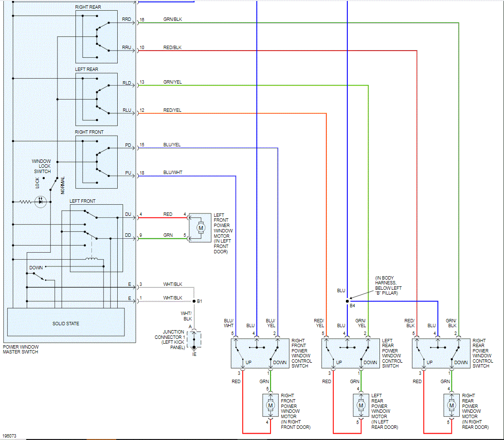

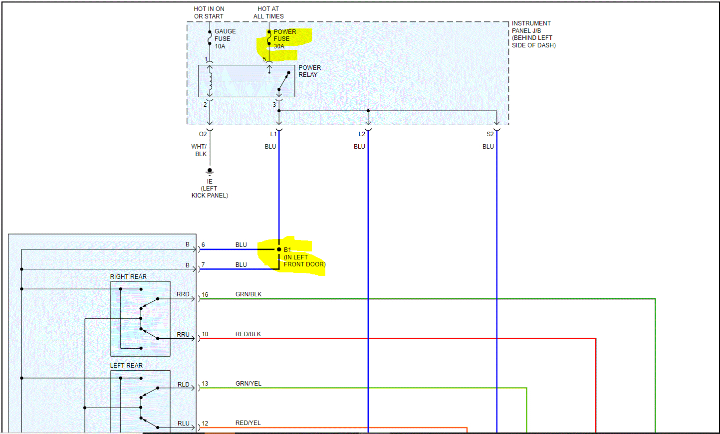

All windows are powered by one fuse. For the left side to fail, either someone would have had to open the door panel and damage the power supply or we have a switch-related issue. I attached the wiring schematic below for the windows. Note that the blue wires provide power to the front and rear windows. The rear windows (left and right) get power from the same wire. The right and left front each have a blue wire providing power. So, I'm not sure if that is something someone would have done.

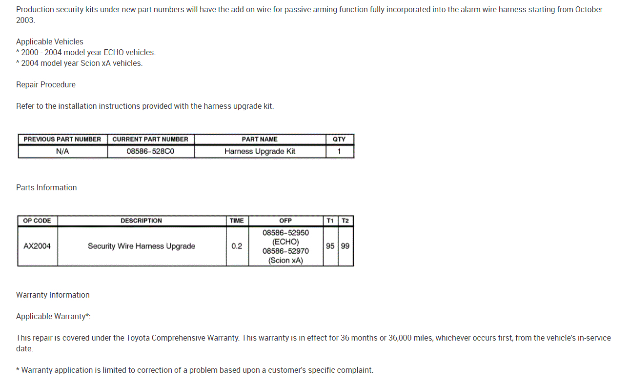

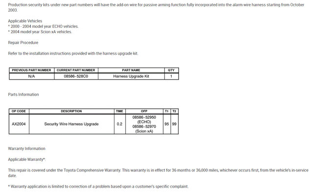

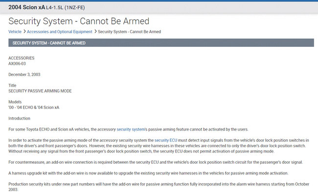

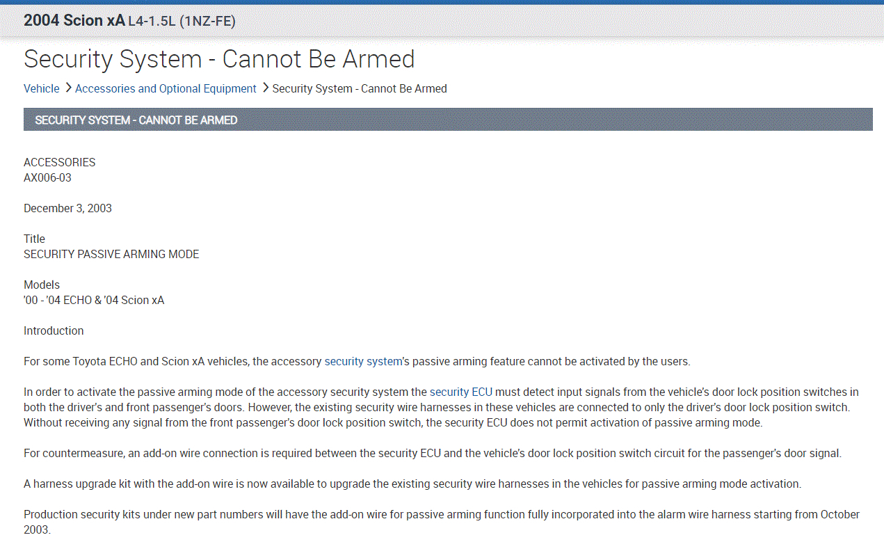

I did find a technical service bulletin related to the antitheft system when it can't be armed. I provided that below as well. Take a look through it and let me know if it mirrors what you are experiencing.
