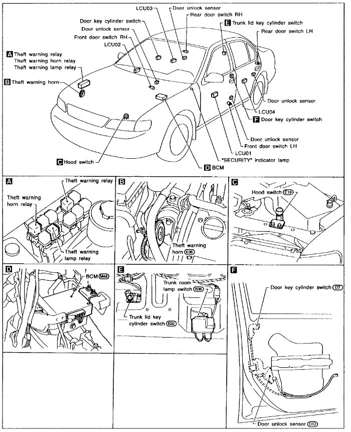

When I went to the store, I came out and attempted to start the car. Nothing. Changed Battery, starter, and battery fuse. Nothing. I read over resetting the security system. My question is, I just have an ignition key, no key fob. How do I reset the system without a key fob? Please help. This is driving me nuts!
May 7, 2022 at 11:16 AM
SQM
  • 6,383 POSTS
Infiniti does call for the use of the key fob to unlock and then use the key to start the vehicle. That typically resets the light.
Since you don't have the fob, try to disconnect the battery for a minute and reconnect. That should reset the security system.
Take a look at this helpful guide, it covers the basics of how to reset security systems:
https://www.2carpros.com/articles/how-to-reset-a-security-system
Let me know of any questions.
