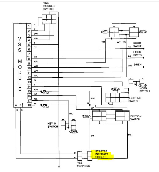

I pulled up the Vehicle Security System (VSS) wiring harness. If you have a factory system, it appears the fuel pump is not affected. From what I am seeing, either the starter won't engage, or it will shut down the ignition system. See pic 1.

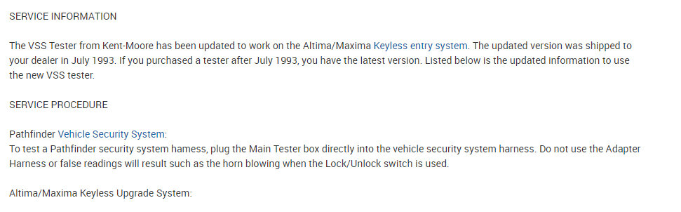

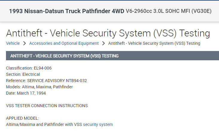

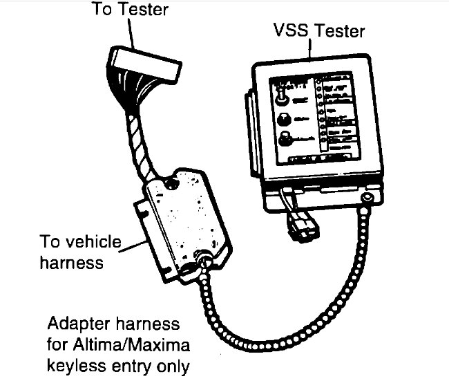

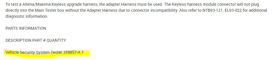

I have the diagnostics for the system, but it requires a specialized tool that will likely not be found. However, I have attached the directions below. Maybe if you try locating the tool with the part number provided, you may get lucky.
