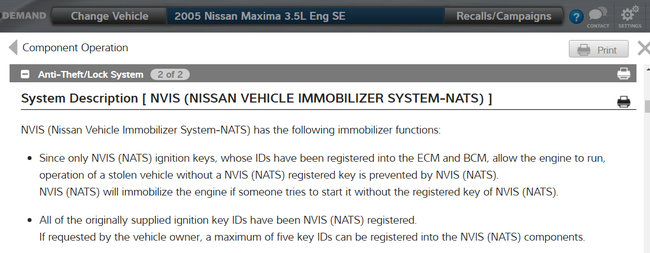

Car will not start due to security system
2005 NISSAN MAXIMA
120,000 MILES
LARRY7619
Something about the (Nat) security system. the car is immobilized.

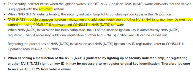

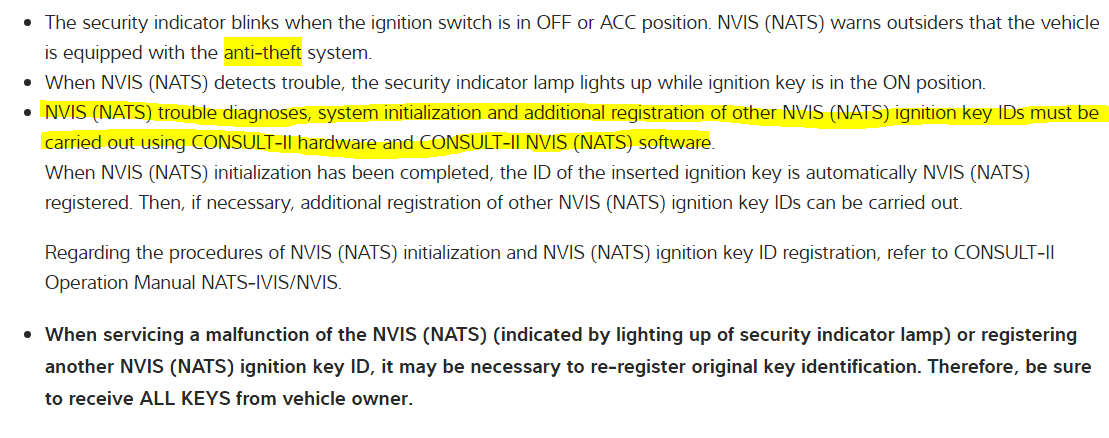

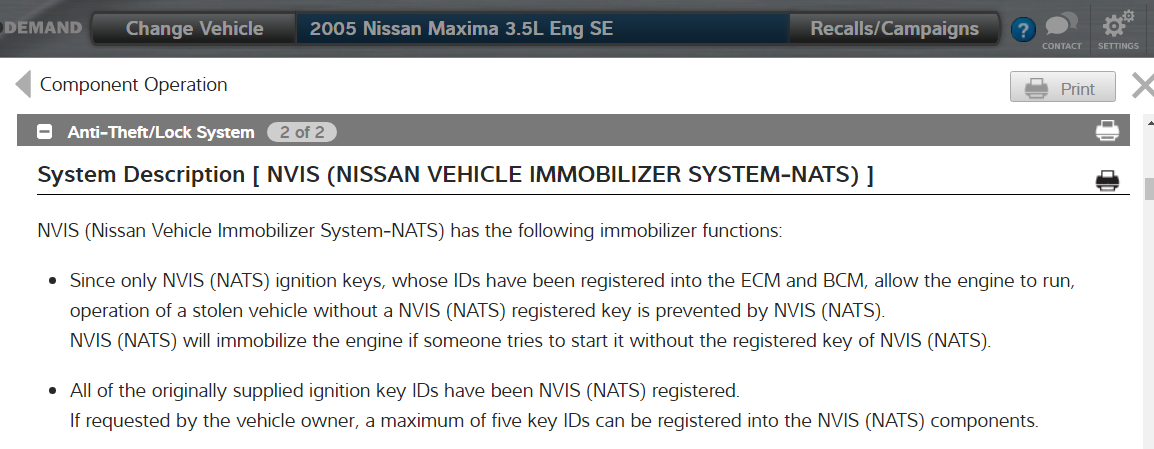

Unfortunately if your ignition key has been lost or it has lost it's programming somehow, the only remedy is to have a new key or your old key reprogrammed to the Power-train Control Module of your vehicle. It has to be done with Nissan's Consult II and with Nissan's Consult II NVIS (NATS) software. In the diagrams down below I have included the description of this from the vehicle manufacturer. Please keep us informed as to how everything progresses.
Thanks,
Alex
