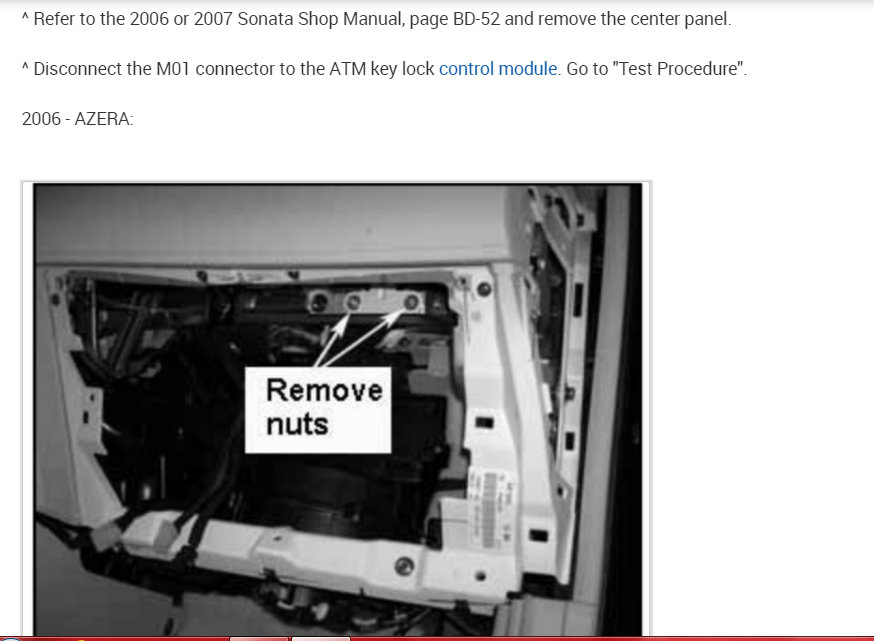

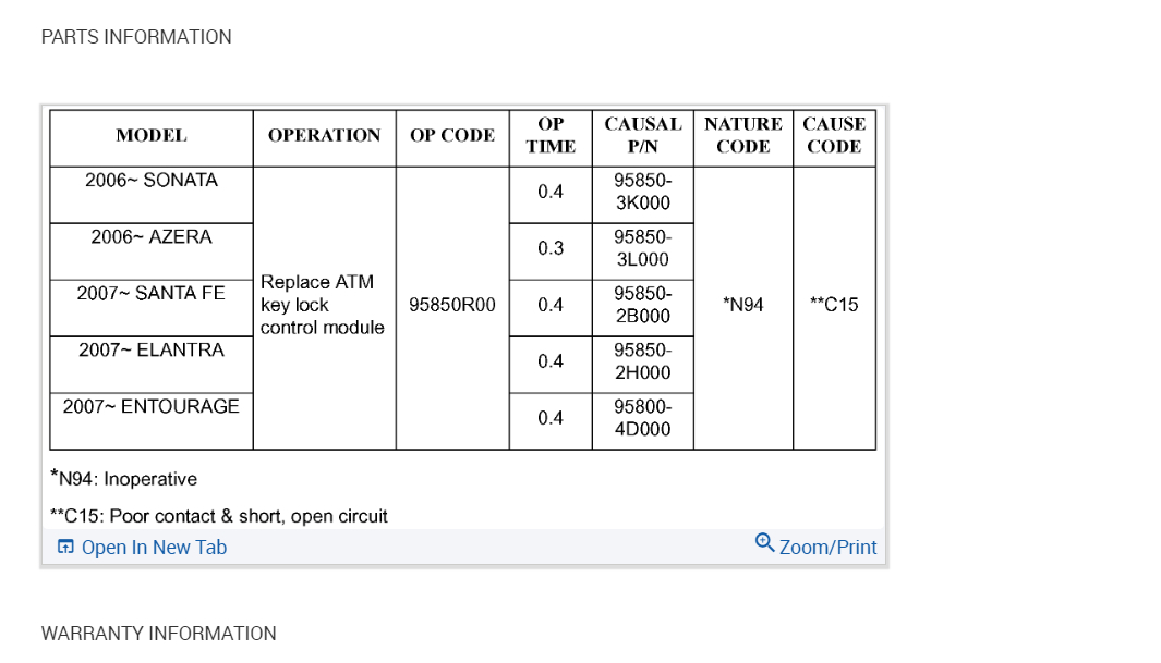

Removed battery post and then reconnected. Won't do anything. Security system?
Sep 1, 2019 at 2:46 PM
SHEREE BURGIN

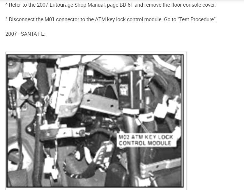

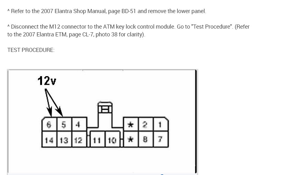

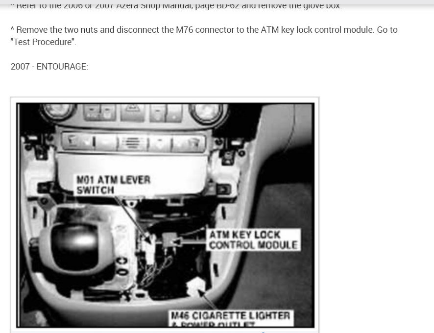

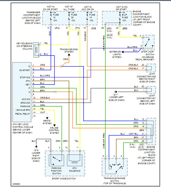

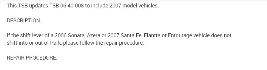

Key will not turn on. Shifter is locked, steering is locked. Lost fob but have orginal key.
Sep 1, 2019 at 2:52 PM
SCGRANTURISMO
  • 4,897 POSTS

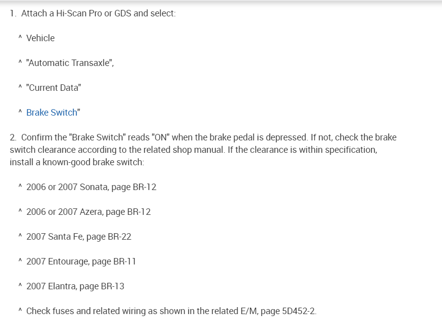

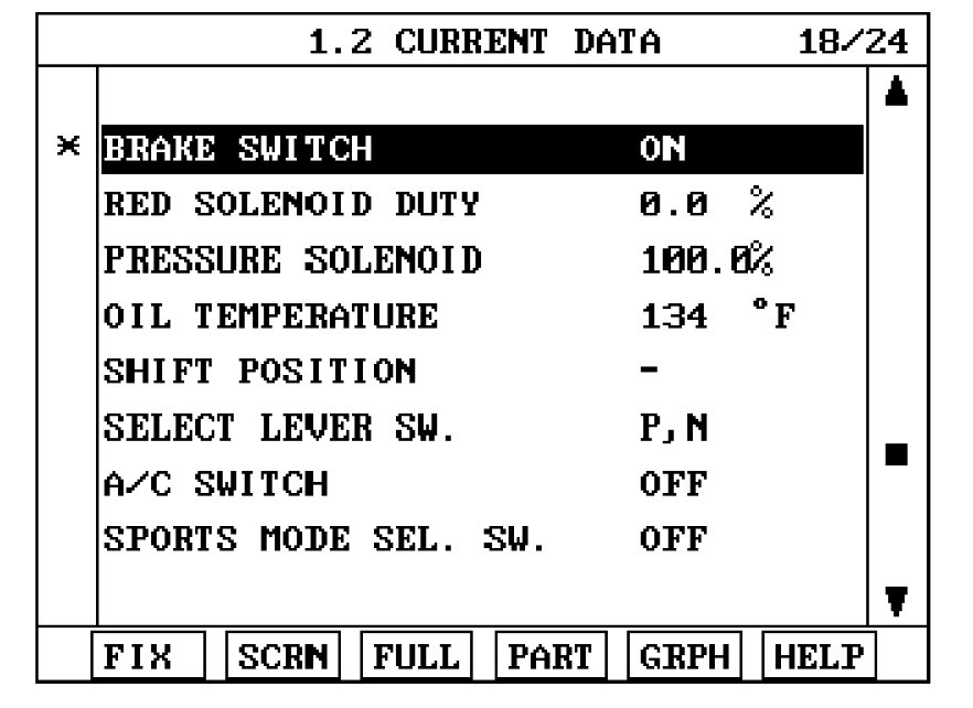

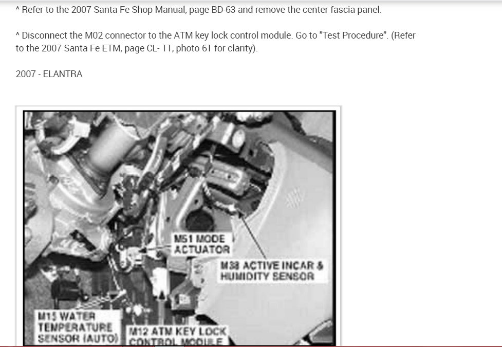

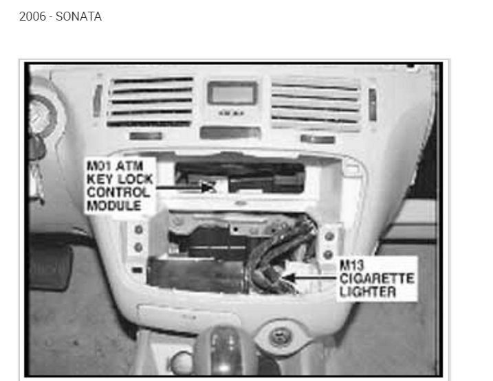

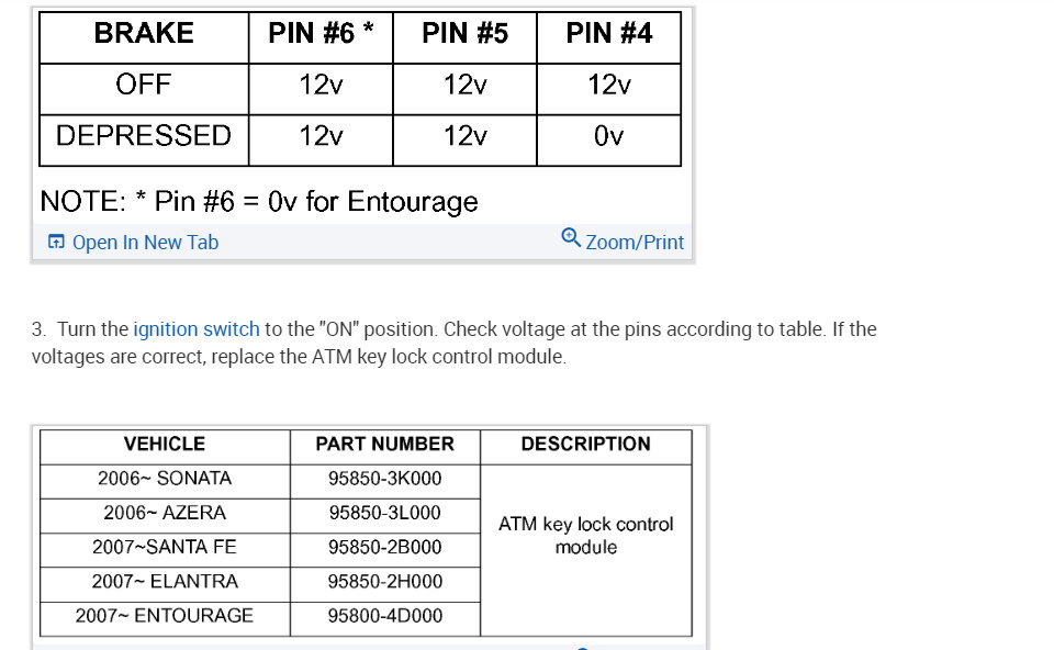

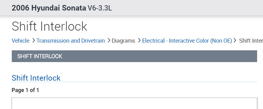

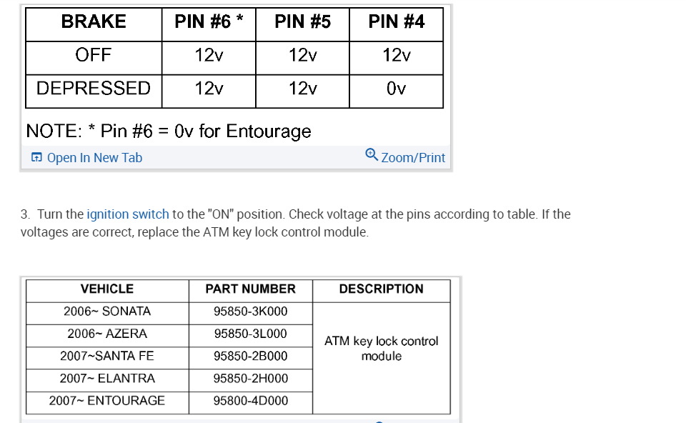

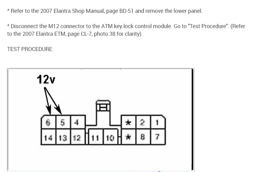

In the diagrams down below I have included a wiring diagram of your vehicle's shift interlock circuit and a Technical Service Bulletin (TSB) from the vehicle manufacturer with instructions on how to fix this very problem. Please go through these guides and get back to us with how everything turns out.
