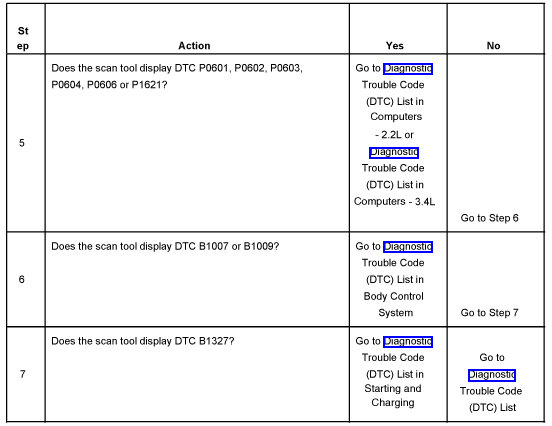

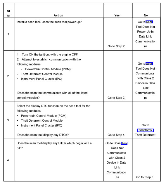

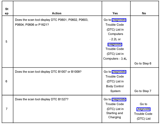

It this does not work, you will need to scan the computer to identify trouble codes. I have attached a flow chart that may be helpful for you. The following numbers refer to the steps listed on the charts I attached. Additionally, it indicates what specific trouble codes are being caused by.
2) Lack of communication may be due to a partial malfunction of the class 2 serial data circuit or due to a total malfunction of the class 2 serial data circuit. The specified procedure will determine the particular condition.
3) The symptoms list in symptoms will determine the correct diagnostic procedure to use.
4) The presence of DTCs which begin with "U" indicate some other module is not communicating. The specified procedure will compile all the available information before tests are performed.
5) The presence of DTC P0601, P0602, P0603, P0604, P0606 or P1621 indicates an internal fault in the powertrain control module (PCM).
6) The presence of DTC B1007 or B1009 indicates an internal module fault.
