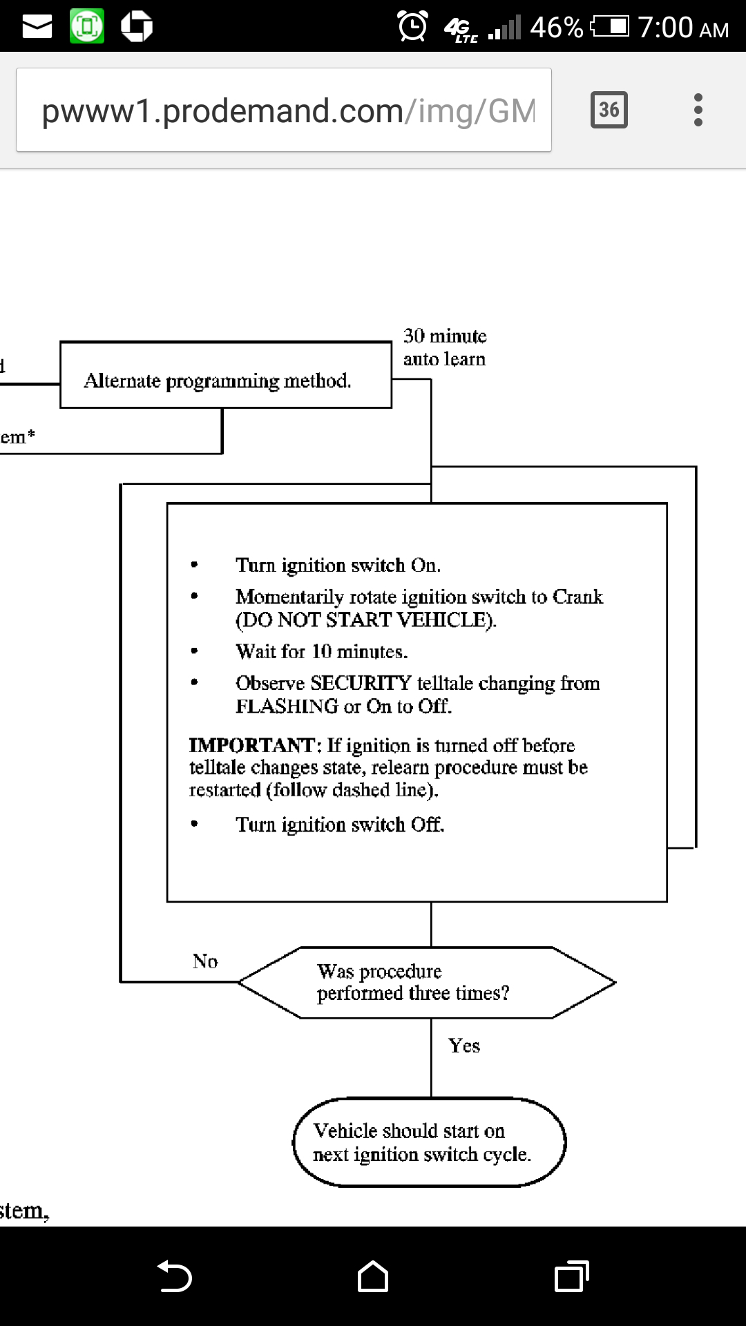

i recently replaced ignition lock had a cut key made and coded go to start car and now the security light flashes then stays lit and car starts then stalls.

If you replaced the steering lock housing did you relearn the pass lock sensor? Because there is no chip in the key on that car.

I posted how you learn the new pass lock sensor that was replaced with the steering lock housing.

I did not replace housing. I replaced the lock cylinder and when I do a relearn the security light never goes off no matter how long I wait.

The cylinder has nothing to do with the light staying on.The sensor is in the housing.Why did you replace the cylinder and how did you get it out?

I did not replace housing only sensor. I will try another relearn when I get off work and will let you know or how can I disarm security? The security light flashes four times going as I am starting it and when car dies the light stays on.

The sensor is part of the steering lock housing it does not come separate. There is no good way to bypass the ignition security

You are doing three ten minute cycles and not turning the key off until the security light turns off each time?

When I do the relearn the security light flashes. when I try to start it then when it dies the light stays lit does not matter how long I leave key on for ten, eleven or twelve minutes. do I do the test anyway?

The light has to go out each cycle.You never answered me how did you drill the ignition cylinder to get the old one out? Or doing anything that might have damaged the passlock sensor in the ignition housing? Because if it was fine before you changed the cylinder then that is all I can think of. Because if you only changed the cylinder it makes no sense why the light would be on unless you damaged the passlock sensor.

Only thing I can think we'll I used key to get it out I read that you can wire a resistor on the yellow and ground the side and should start

Thx for all your help but I got starting again thx again
