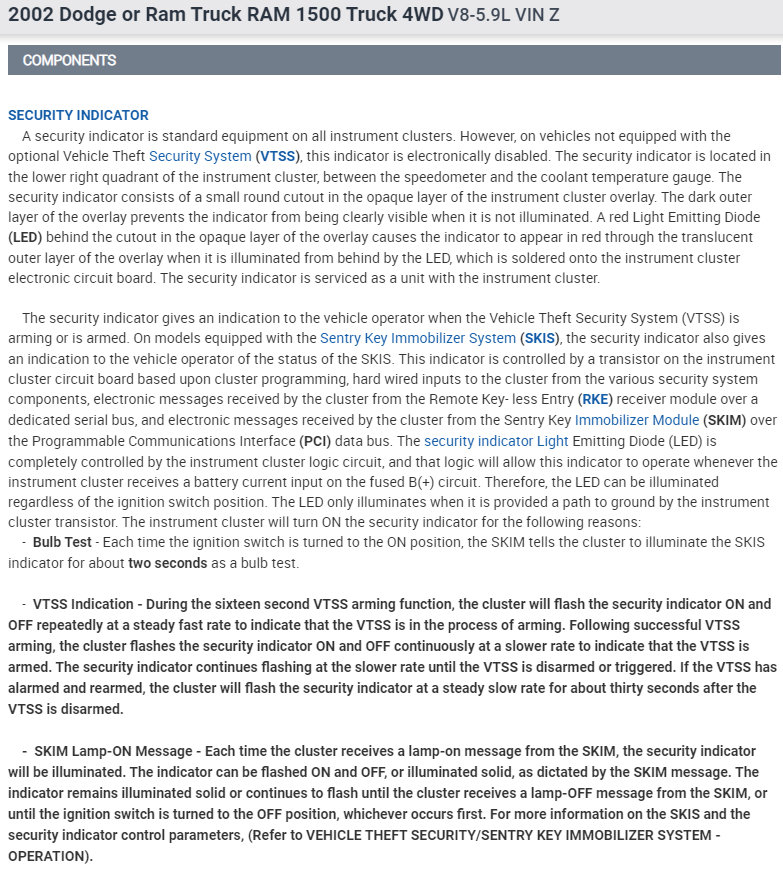

The alarm light won't stop blinking and the truck will not start.
Apr 26, 2022 at 2:49 PM
SQM
  • 6,383 POSTS

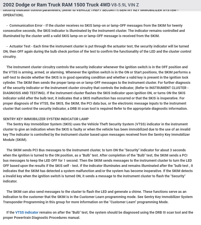

First try to reset the security system.
Most Dodge vehicles you can disconnect the battery for a minute and then reconnect, that should reset the security system.
Take a look at this helpful guide, it covers more details of what to do:
https://www.2carpros.com/articles/how-to-reset-a-security-system
Let me know what you find or if you have any questions.
