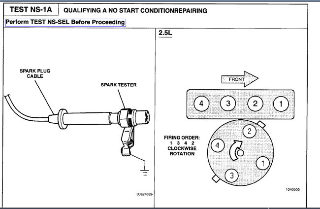

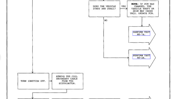

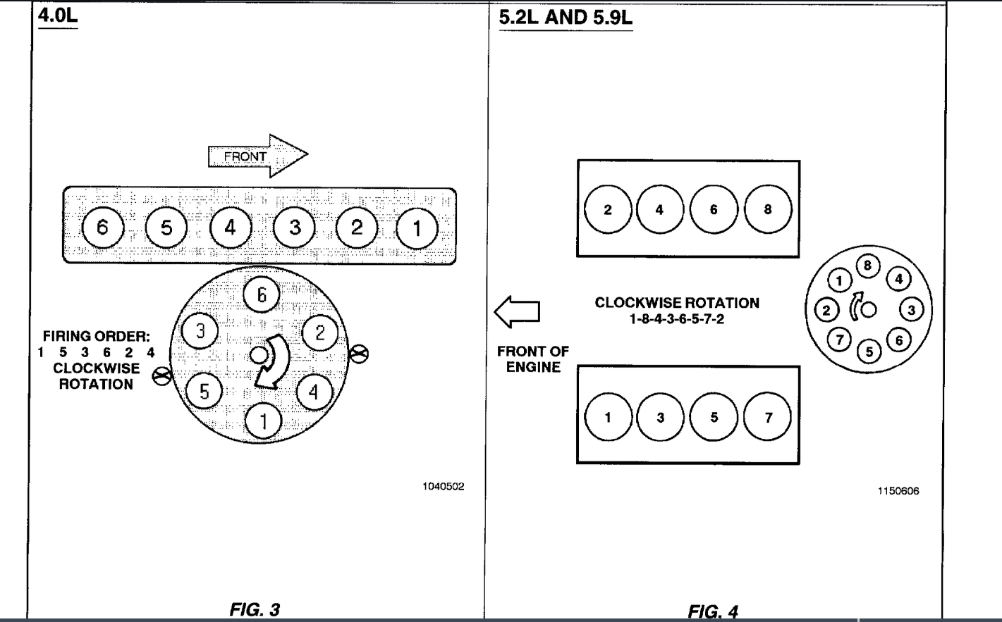

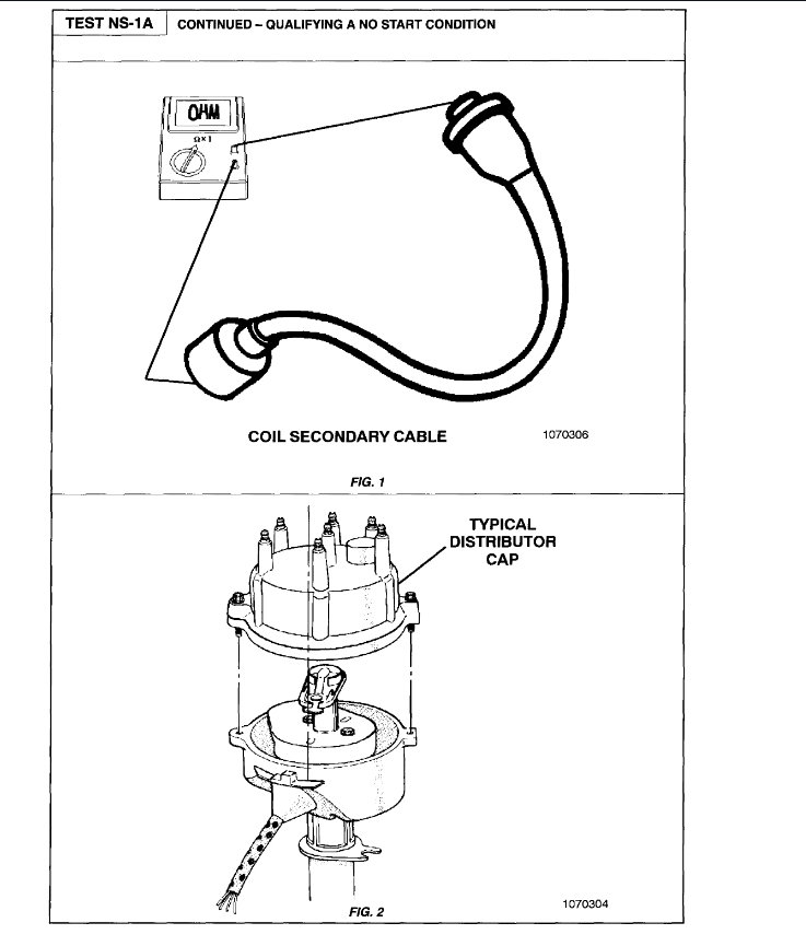

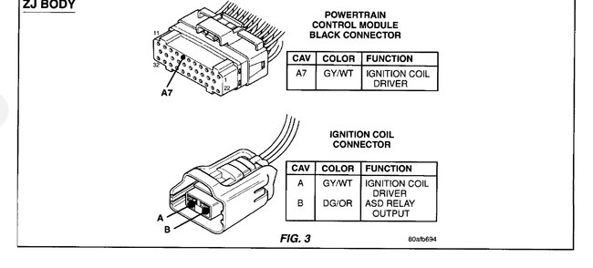

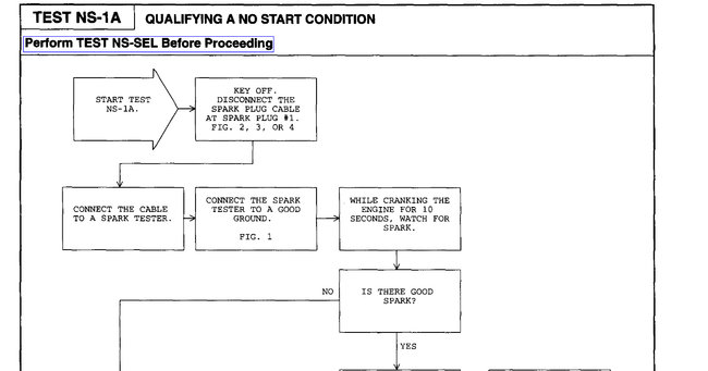

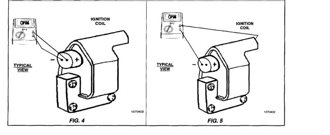

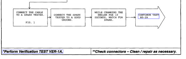

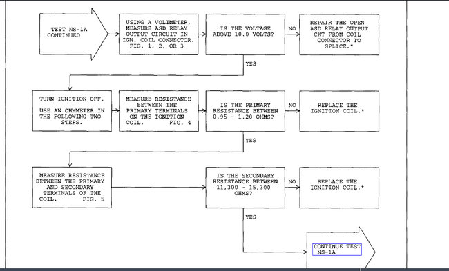

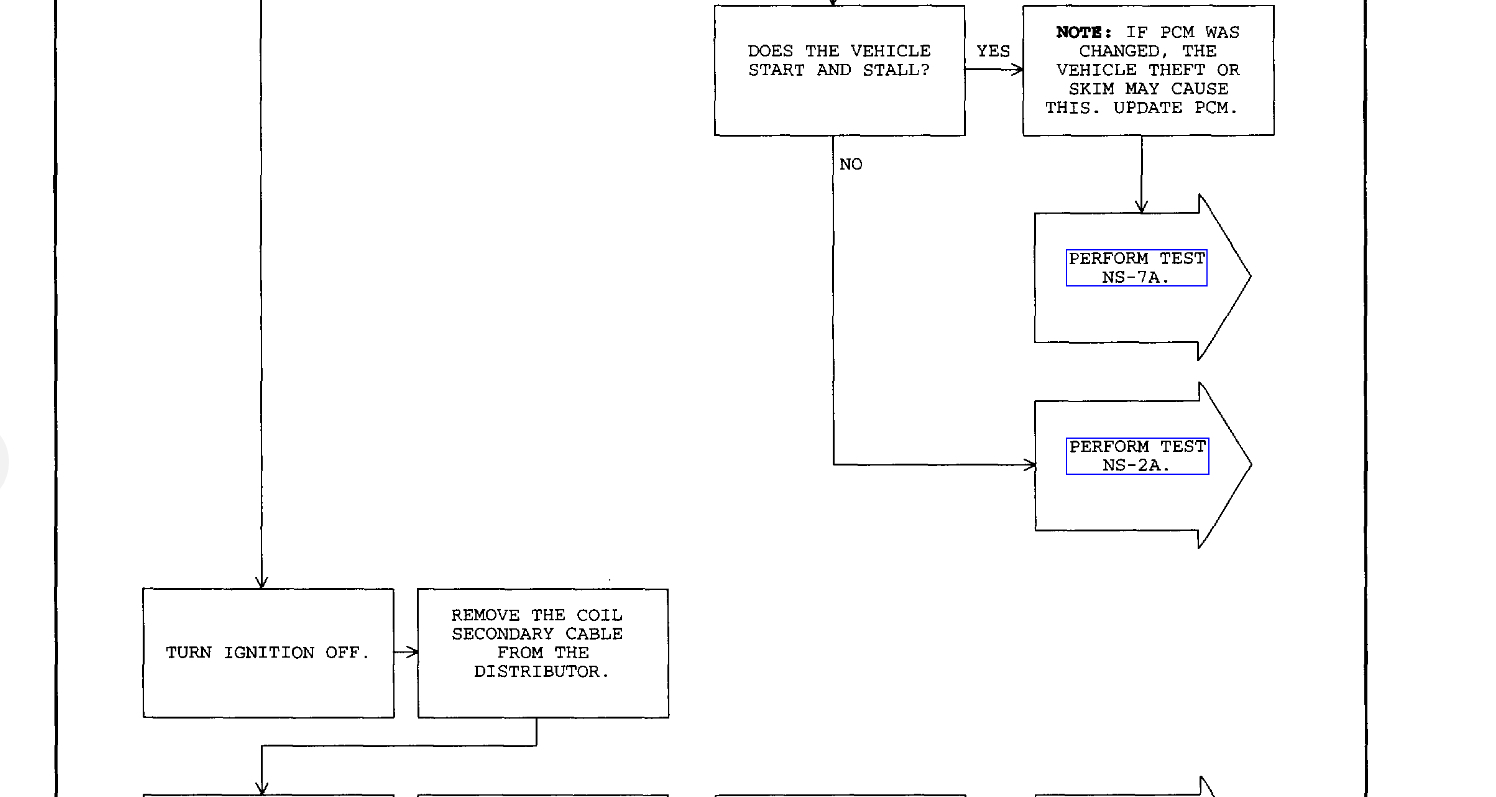

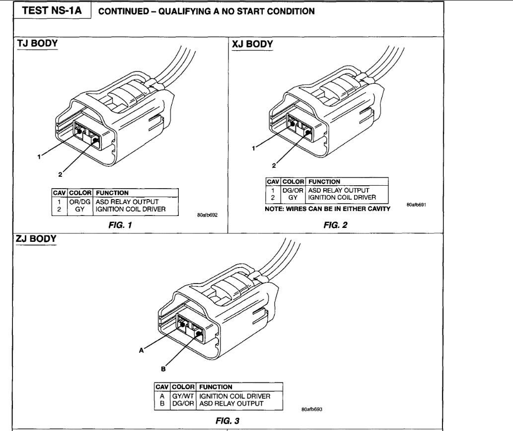

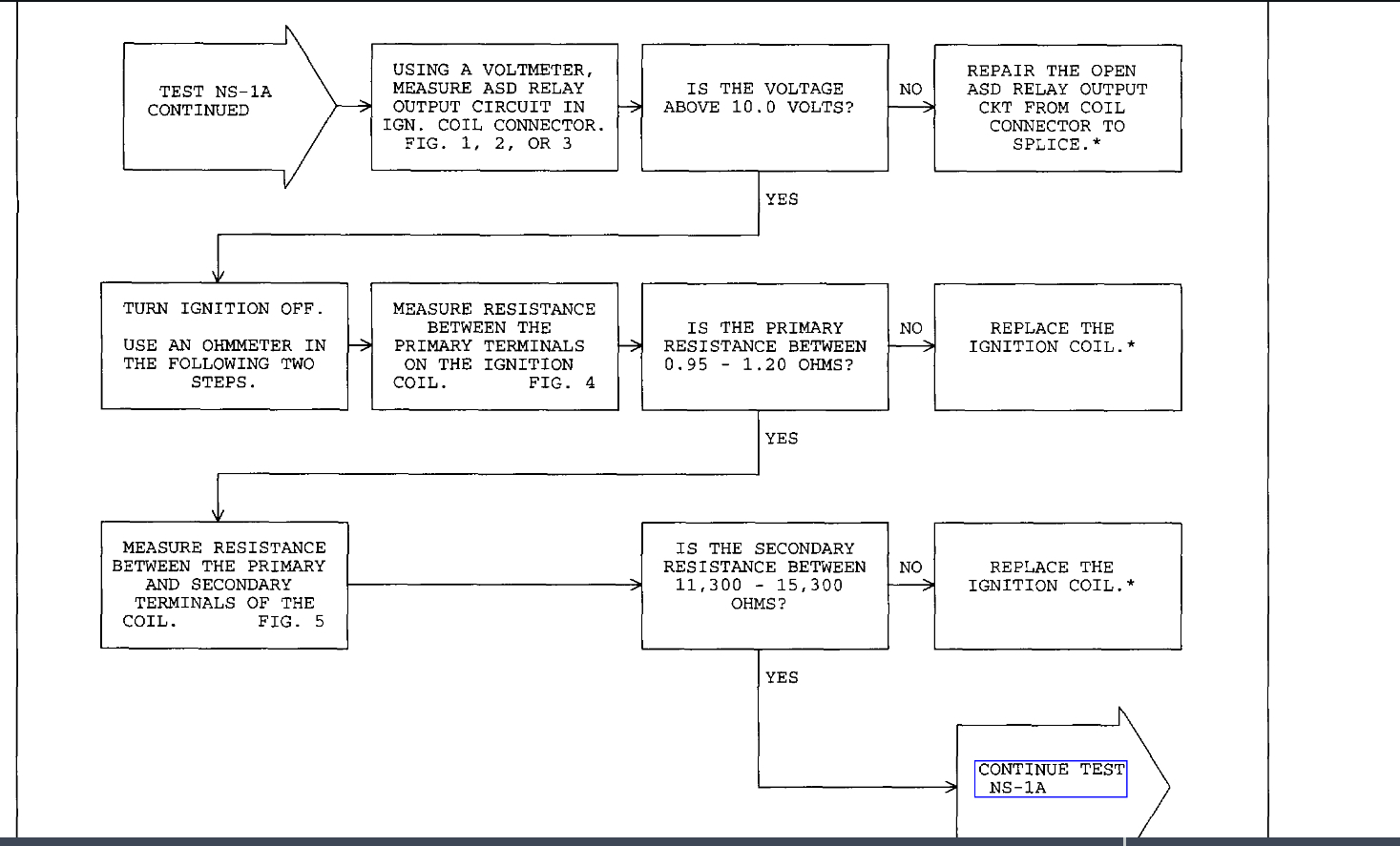

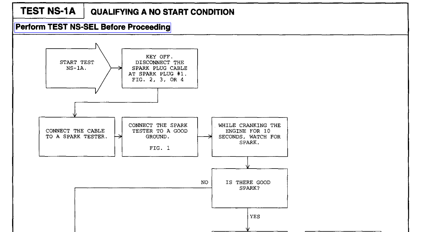

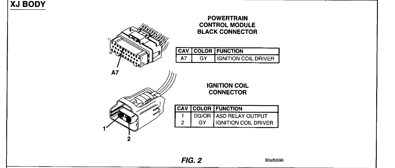

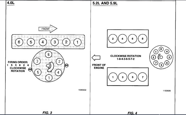

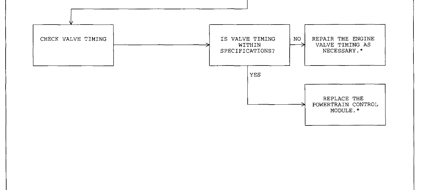

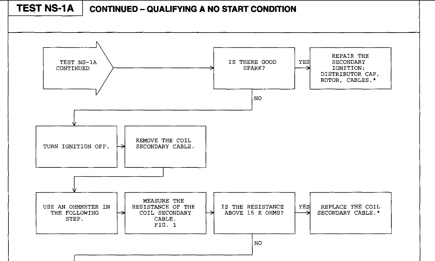

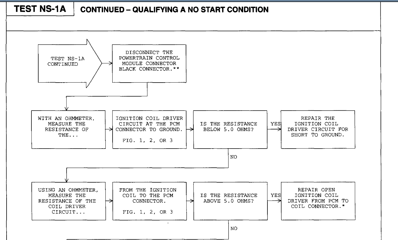

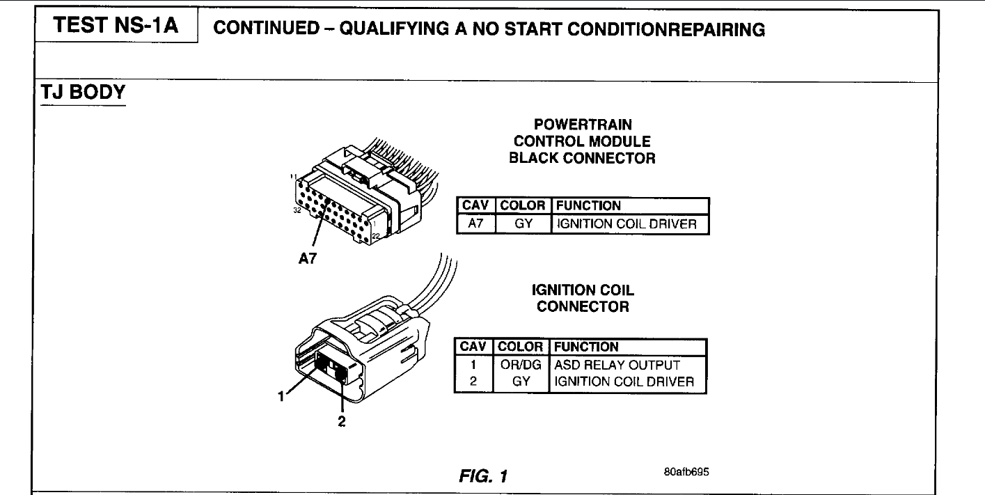

The engine crank but will not start. Security mode.
Saturday, June 15th, 2019 AT 5:49 AM
SCGRANTURISMO
  • 4,897 POSTS

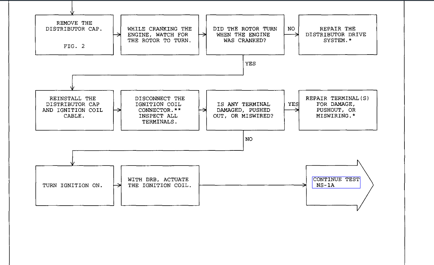

In the diagrams down below I have included a No Start troubleshooting flowchart from the vehicle manufacturer. If you follow this flowchart, it should lead you to the cause of your vehicle's No Start condition. Please go through this guide and get back to us with what you are able to find out.
