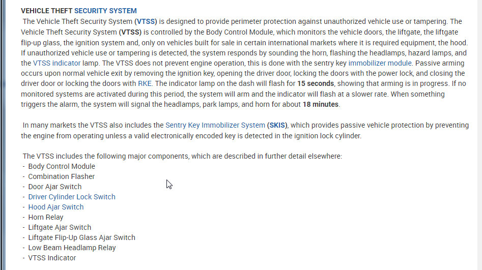

l lost my only transponder key.
Went to a salvage and inserted a different lock cylinder w/key. It will start and run 2 or 3 seconds and shuts off. I was told the body control module locked the system down.
If l go get PCM, BCM, lock cylinder and key from the same vehicle and install it all in mine. Will it start and run with no further programming?
Mar 24, 2021 at 4:07 PM
This will solve the theft issue but it is likely to cause some VIN mismatch issues. The reason is the BCM pretty much controls this theft system but it needs valid input from the key and other inputs listed below to disarm the system and allow the SKIS system to tell the PCM to start the engine.
Couple options may be cheaper and easier and that is to put all your original parts back on and just get a key programmed to the vehicle.
The other option is to look into getting a PCM that has this system deleted. That way you can just use any key that fits the vehicle and does not require programming. Clearly this comes with concessions as well but it is just a PCM replacement rather then all these other parts.
The reason I would recommend against all this is what if one of these parts has an issue with it? Then you have to use them in order to solve the theft issue but now you need to replace it or fix the new issue which is just going to put you back in the same situation.
If it were me, I would just go back and get replacement keys but let me know if you have questions and we can go from there. Thanks

If l have the vats removed from my PCM, is it okay to remove the immobilizer? And is there anything else needs to be done to the BCM?
Mar 27, 2021 at 3:30 PM
If this is the only issue then you do not need to remove anything or do anything with the BCM. I would just leave it all there. Basically what will happen is the PCM will get the ignition switch battery voltage and not look for a secret code from the theft system and just start the Jeep.
There are many companies out there that do this but I would just find one that you like and follow their instructions as some vehicles require different things but from what I remember the Chrysler products just need the PCM.
