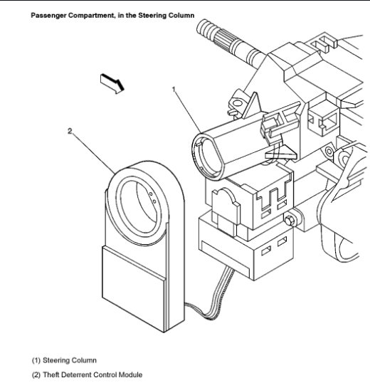

I have the car listed above that was given to me from a friend that had committed suicide. the key was lost so now I'm stuck with a car that I cannot start. is there anyway to bypass the security system without having the key?

Unfortunately, no the anti-theft, security system cannot be bypassed. This car incorporates a theft deterrent module that can only recognize a key for that particular car. I've attached a picture below of its location on the steering column.You will have to take the VIN number (vehicle identification number) using the cars information to have a new key made to get the module to work. A new key can be made but it can cost a few hundred dollars to work.Hope this helps and thanks for using 2CarPros.
