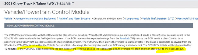

It starts and goes out immediately. When trying to program the remote key. Nothing happens.
In order to start the car, I had to open the car with the remote control on the key, the remote control stopped working and I cannot start.
I also did the relearning procedure, but the security lamp does not want to go out, it lights up all the time.
I would like to know what the problem may be and whether it can be fixed and how to fix it.
I would like to completely remove the security system from my car so that it always fires. If it is possible.

You are experiencing a fuel lockout. Are you using a known good key? Have you tried a different one?
My concern is that the light isn't turning off. This could be an indication of a failed body control module (BCM) or powertrain control module (PCM). Please keep in mind, this is a theory at this point based on conditions.
What should be done is to scan the can-bus system. CAN stands for controller area network. Basically, all the different modules are tied together via a few wires. This type of scan will provide diagnostic codes regardless of the module storing them. Here is a link showing how it's done. Because there could be one or more modules at fault, I am recommending this be done.
Next, take a look at pic 1 below. This is what I suspect is happening. To test the circuit, we will need a scan tool that can communicate with the different modules.

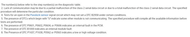

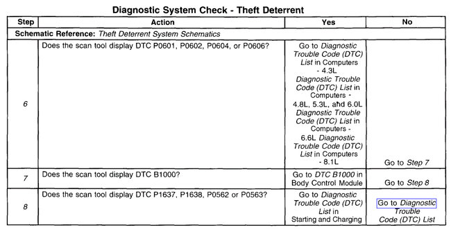

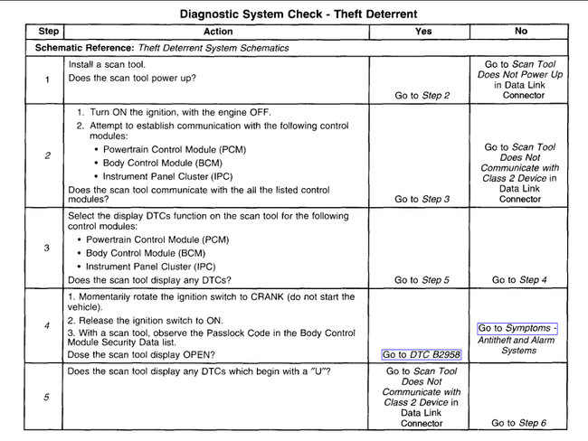

If you look through the last 3 pics, they provide the diagnostics. Let me know if you are comfortable performing them.
