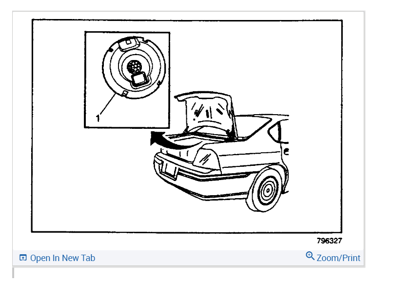

where is the location of the release trap sensor at in the trunk?

Here is the information and location for the trap sensor you have requested, make sure you check out the images below.

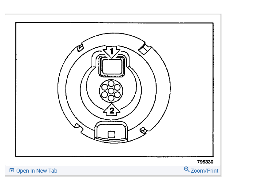

The GM TrapAlert system contains the following components:
Rear Compartment Occupant Sensor (1)
Body Control Module (BCM)
Trunk Ajar Switch
Some vehicles may be equipped with the GM TrapAlert system. This system will release the deck lid and sound the horn if a combination of a difference in temperature compared to ambient and a movement is detected in the rear compartment by the rear compartment occupant sensor (1).
The rear compartment occupant sensor is connected to battery voltage and ground at all times. When a combination of a difference in temperature compared to ambient and movement is detected by the sensor (2), the body control module (BCM) will command the horn ON for 1 minute, the trunk will then release and the horn will continue to sound for 1 more minute. This process will initialize within 3 minutes of a detect signal from the rear compartment occupant sensor. If the ignition is in the ON position when the BCM receives the detect signal, the disable switch (1) on the rear compartment occupant sensor will flash.

The rear compartment occupant sensor can be disabled by pressing and holding the disable switch (1) on the sensor for 2 seconds with the ignition in the ON position. When disabled, the BCM will command the trunk ajar telltale ON for 1 minute with each ignition ON signal while the sensor is disabled. Once the rear compartment is opened, the sensor will reset to an enabled status and resume normal operation. The sensor can also be enabled inside of the trunk, if disabled, with the ignition ON or OFF by pressing the disable switch (1). If the rear compartment occupant sensor is disabled, the trunk ajar telltale will illuminate for 30 seconds with each ignition ON cycle.

Check out the diagrams. (Below)
