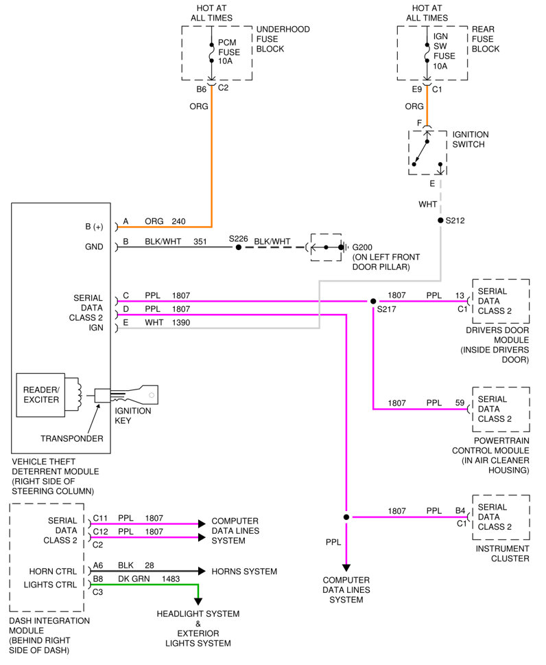

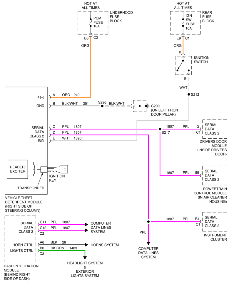

Can I get a wiring diagram or schematic for the passkey 3 system or the pass lock 3 system?
2000 BUICK LESABRE
150,000 MILES • 6 CYL • 2WD • AUTOMATIC

May I please get the wiring diagram or schematic for the passkey 3 system or the pass lock 3 system I can't remember what it's called, lol. Thank you.

Please see below.
Hope this helps.
