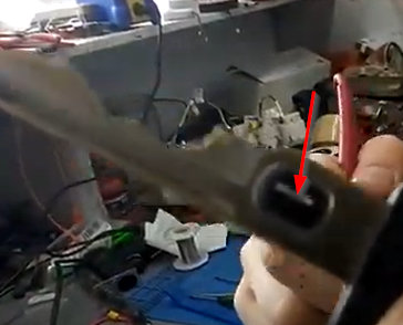

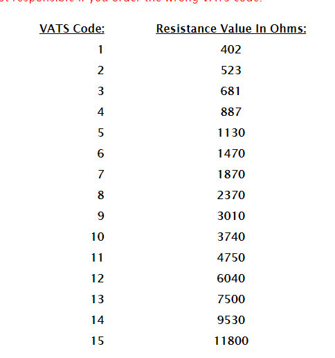

We do not have a video on that but basically you need to measure the resistance in the pellet in the key. So, you put one lead on the pellet and the other on the pellet on the other side of the key. If looking at the black dot, there should be a metal center part and that is where you measure. Each system is different, so we need to check this to find out how many resistors to use.
Here is a guide that will help with checking resistance (ohms).

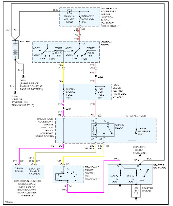

The wiring diagram is below, and I am putting a picture of the key as well.
Let us know what resistance is and we can go from there.

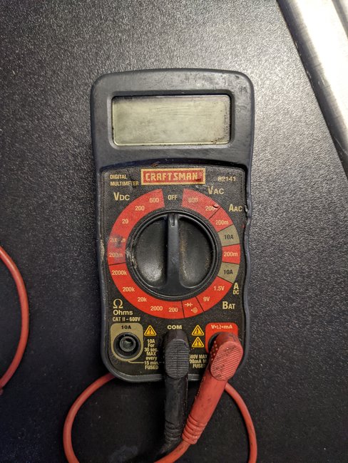

I'm starting to think maybe the pellet was just covered in invisible crud. I went to measure resistance and kept coming back with infinite readings until I scrubbed it good. Then I got a 0.884. But I've never really delved into reading resistances before, so I'm attaching a pic of my multimeter. I had it set on 20,000. Is that right? Or should it be set somewhere else?
Feb 20, 2022 at 1:28 PM
Basically, this scale means how much resistance the circuit should have. If you are checking something that is in the range of 500-1500 ohms, then you want to be on the 2000 scale as it is going to be closely matched to the reading you are expecting. This is basically a sensitivity reading so you want to try and match it, so it is accurate. However, once you get up to the higher numbers then you are going to get 1.8 on the 2000k which is really 2 mil, so you are going to have to multiply that by 1 mil to move the decimal to the proper place.
So, if you were on 20,000 and got .884 ohms then that is really 8840 ohms. Which means you have a 13/14 key based on this chart.
However, that may be your issue because these readings should closely match one of these readings. So, what I would do is call a GM dealer and have them check your VIN and they can tell you what key you have.
