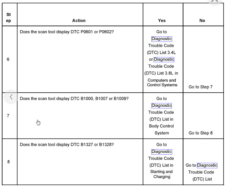

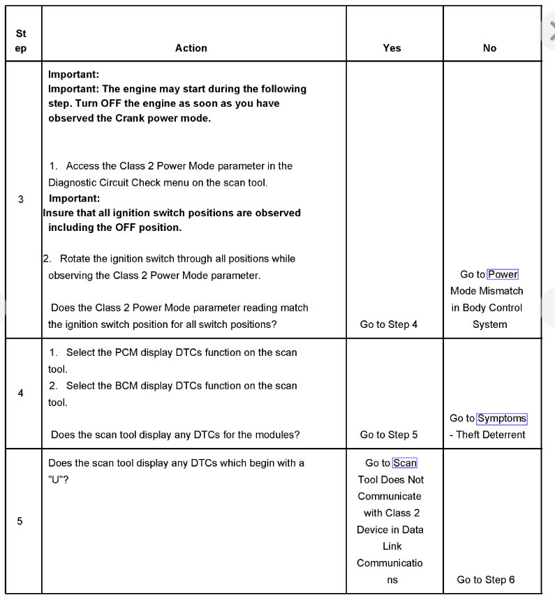

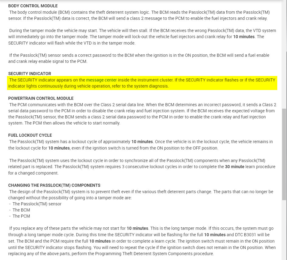

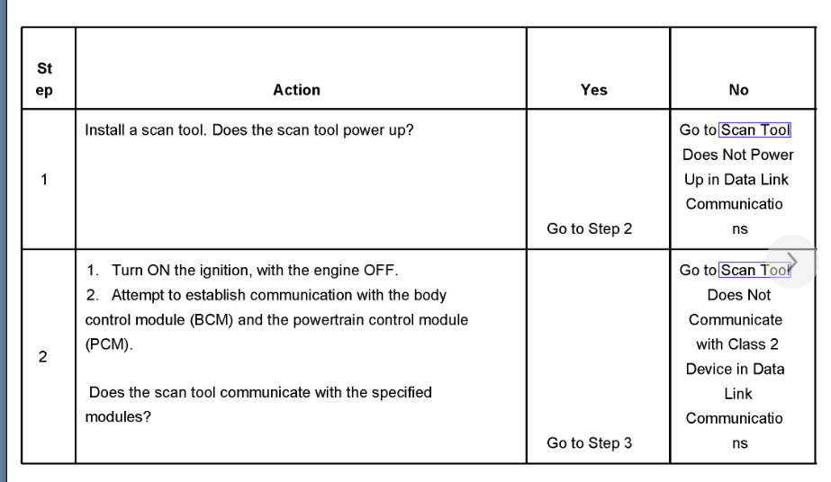

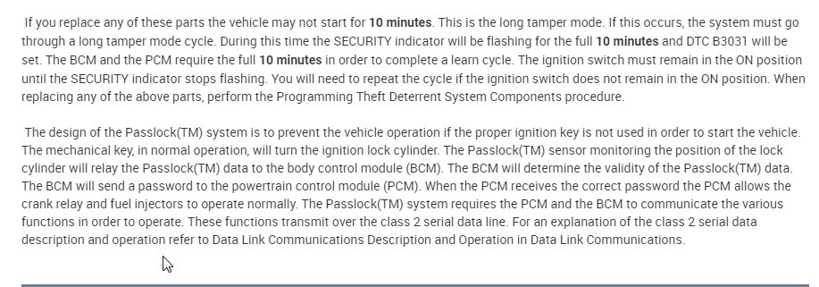

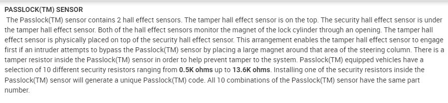

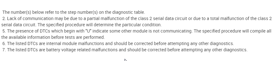

My car cranks over good but wont start. security light is on, but not flashing. how do i get it to start?
Oct 31, 2019 at 11:14 PM

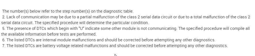

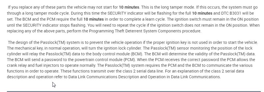

We need to find out what codes are in the system. This will point us in the right direction. Take a look at these attachments especially the first where it says that you need see the diagnostic steps and getting the codes is the first step.
Let me know and we can go from there. Thanks
