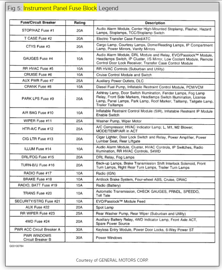

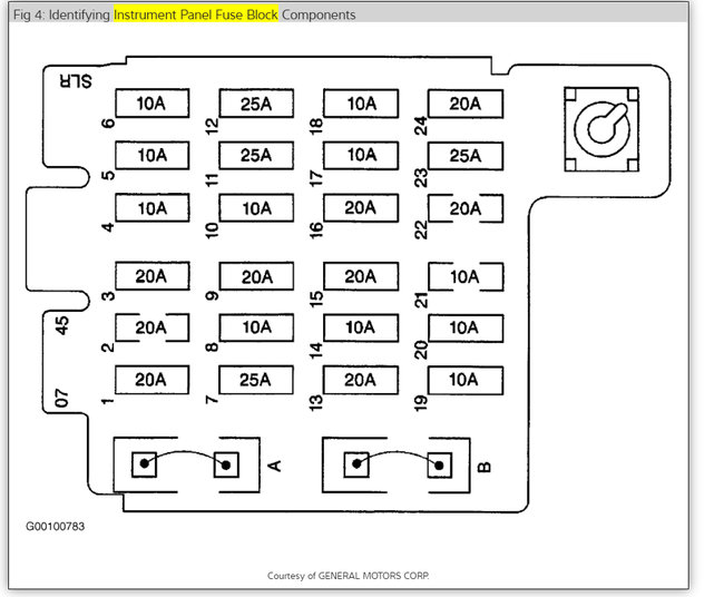

My truck was stolen and the ignition busted. Now I am trying to get it to start. It was starting and shutting off after two to three seconds, now it is not even turning over. Security/bypass?

Okay, so replaced the ignition and the box with it and still doing the same thing. So now what? The security light is not on and does not even come on at all. I am not getting fuel to the injectors but the pump is engaging. Please someone help.
Dec 6, 2018 at 11:06 AM

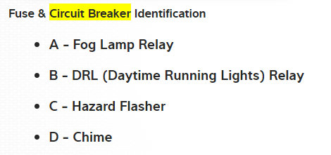

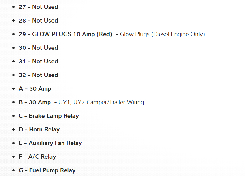

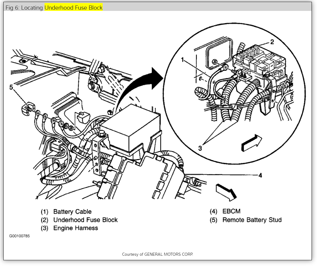

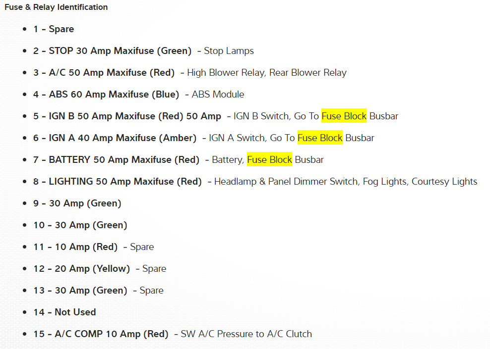

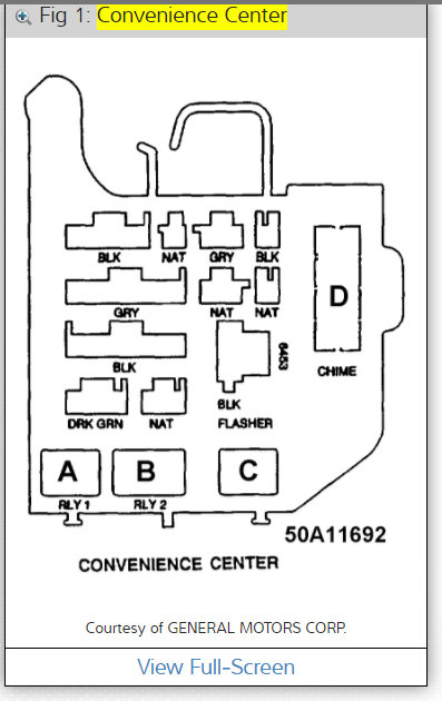

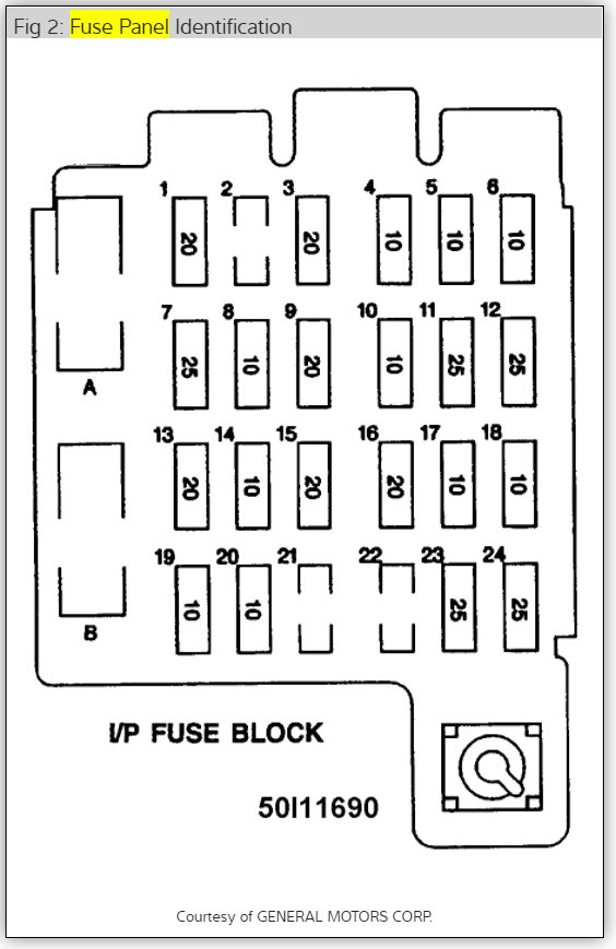

  • 55,746 POSTS

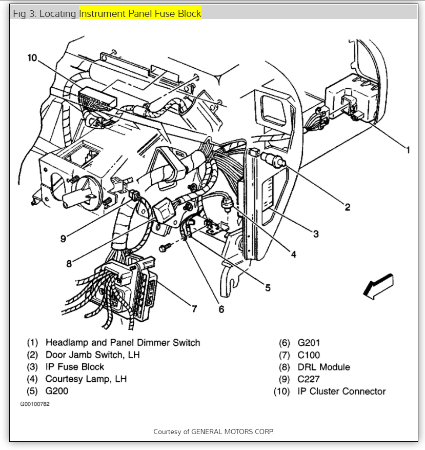

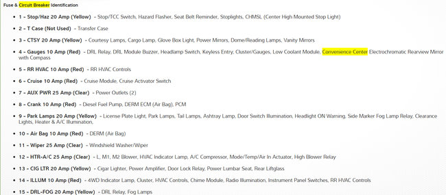

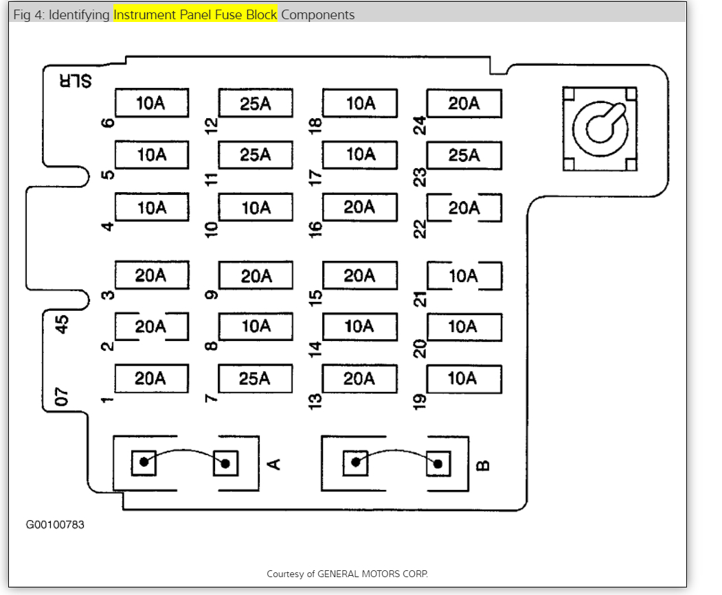

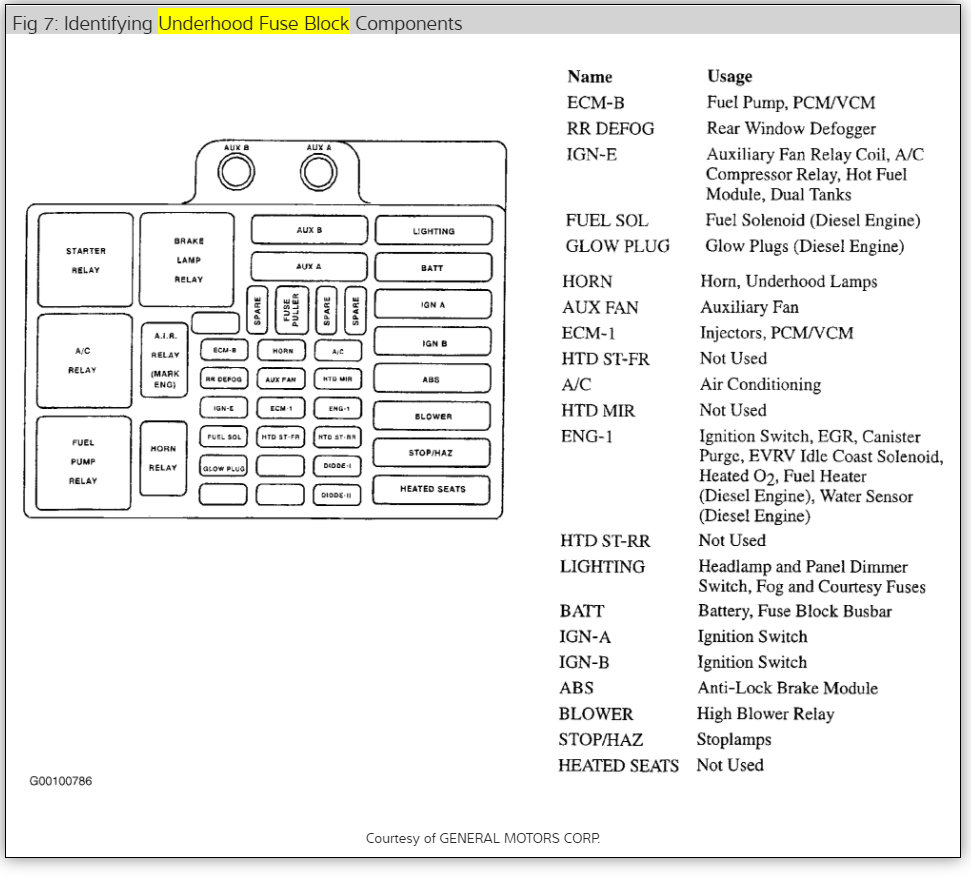

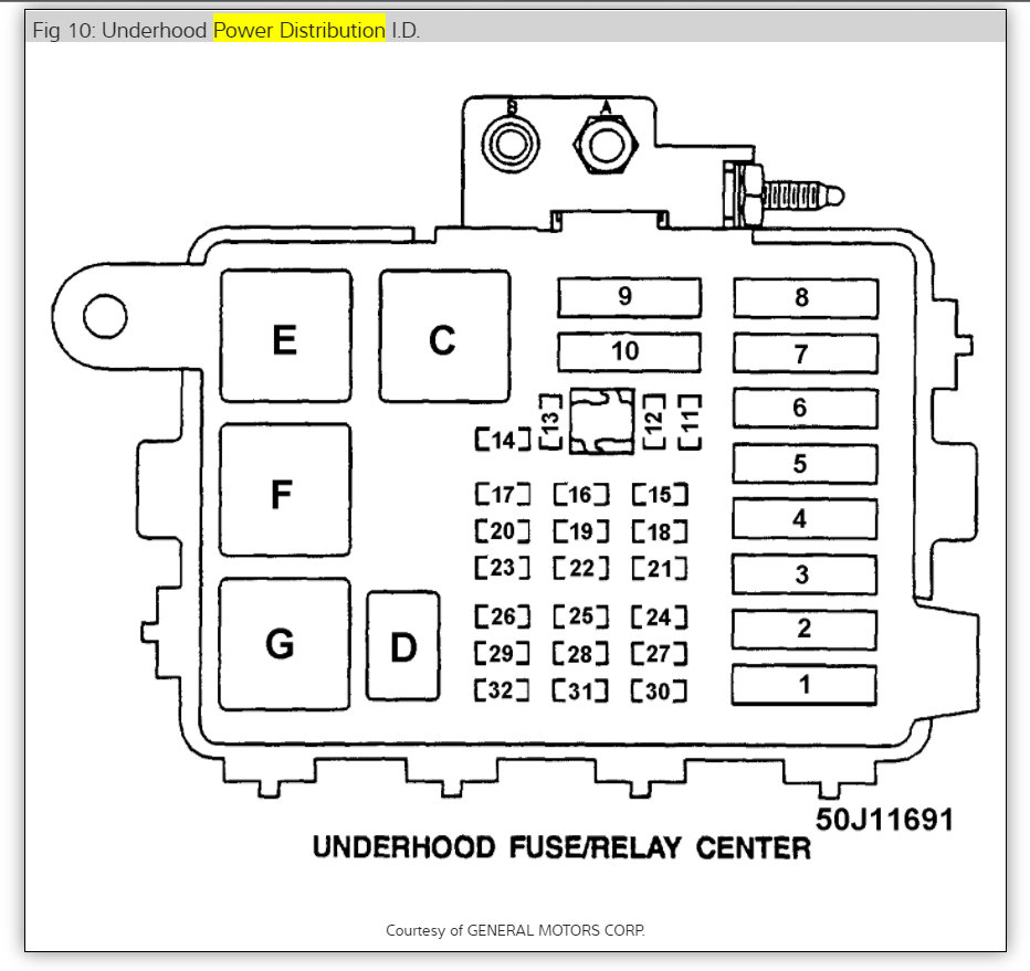

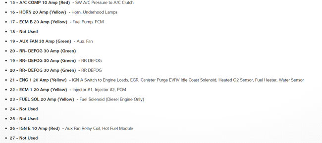

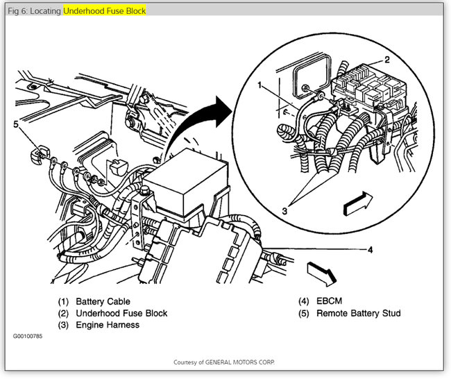

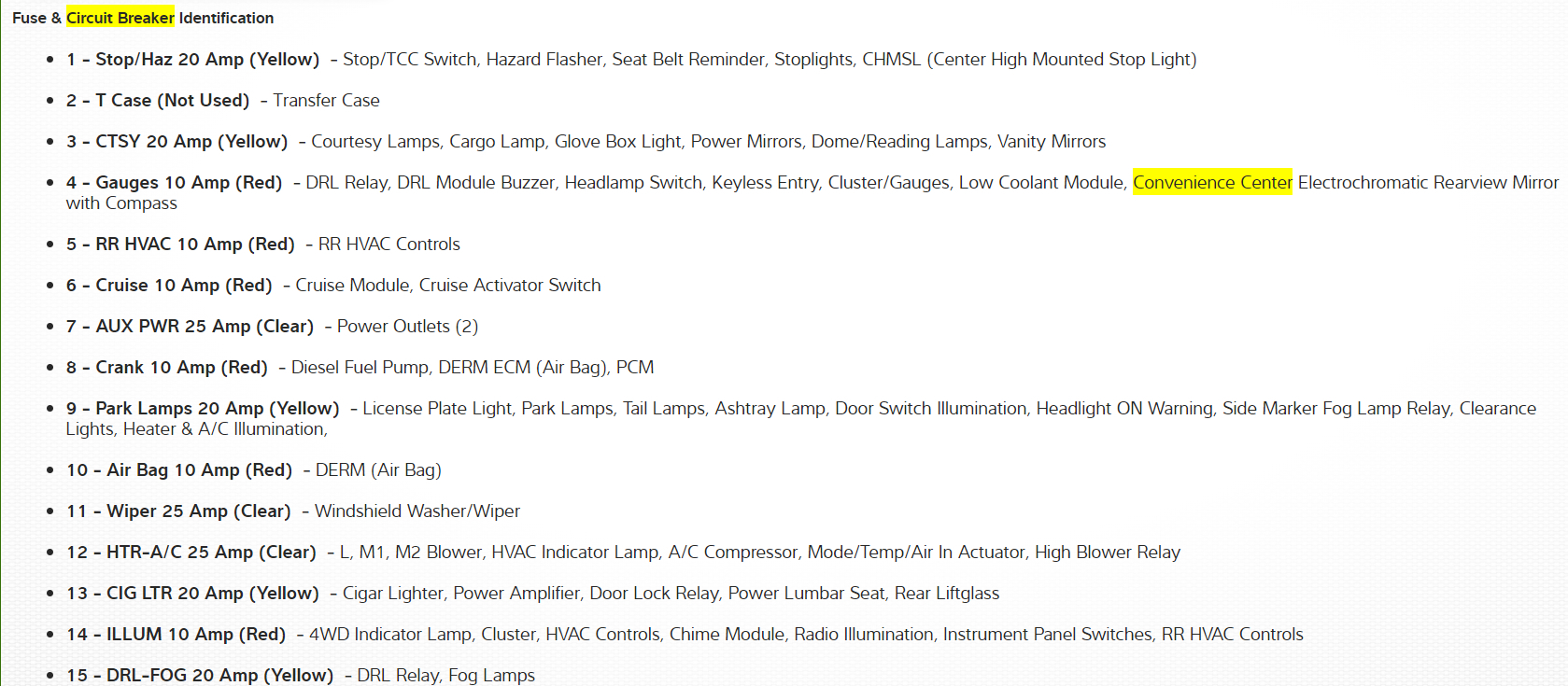

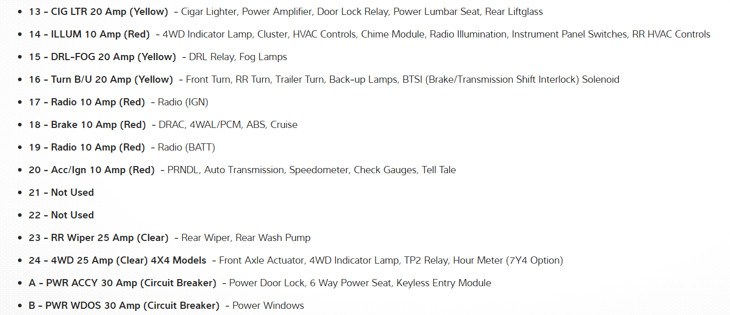

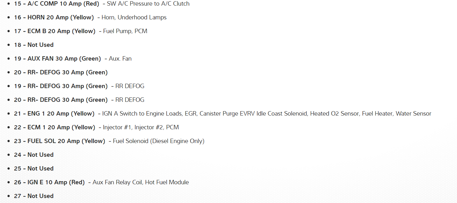

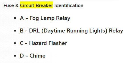

Will the engine crank over? Lets start by checking the fuses. Here is a guide to help us get started along with the fuse locations:

Have checked all fuses and relays. Replaced ignition switch, and wiring harness, still no change, yes it will crank over but will not run it starts and dies instantly. No security light and no codes set. But it acts like the passlock has triggered. Only thing I have left to do is replace the ignition lock housing and hope and pray that fixes my problem.

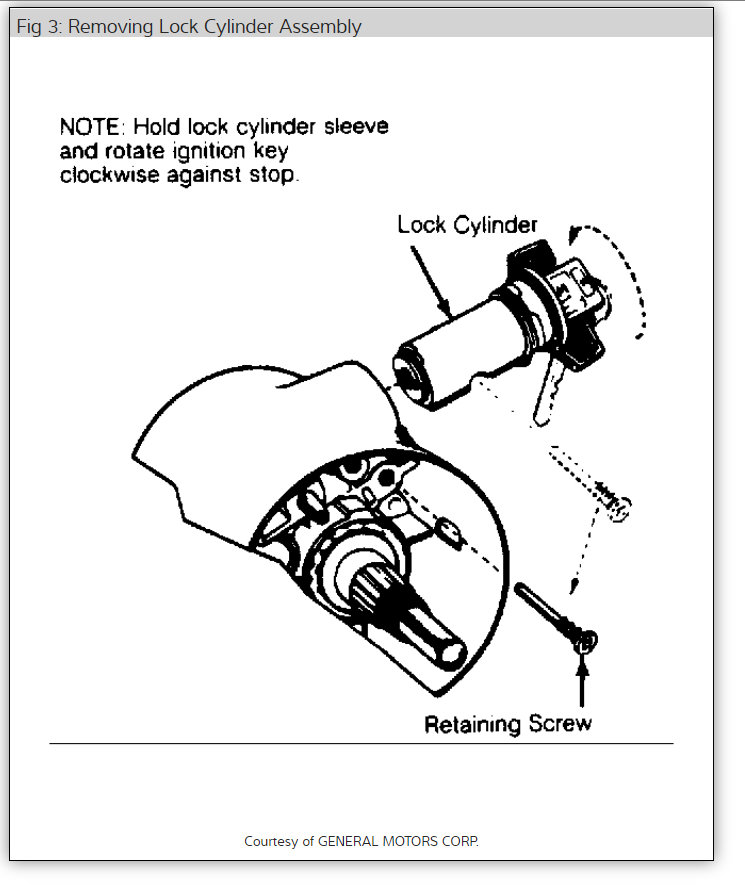

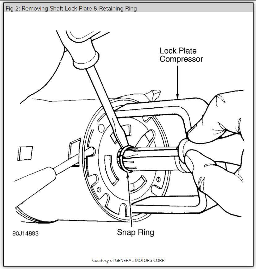

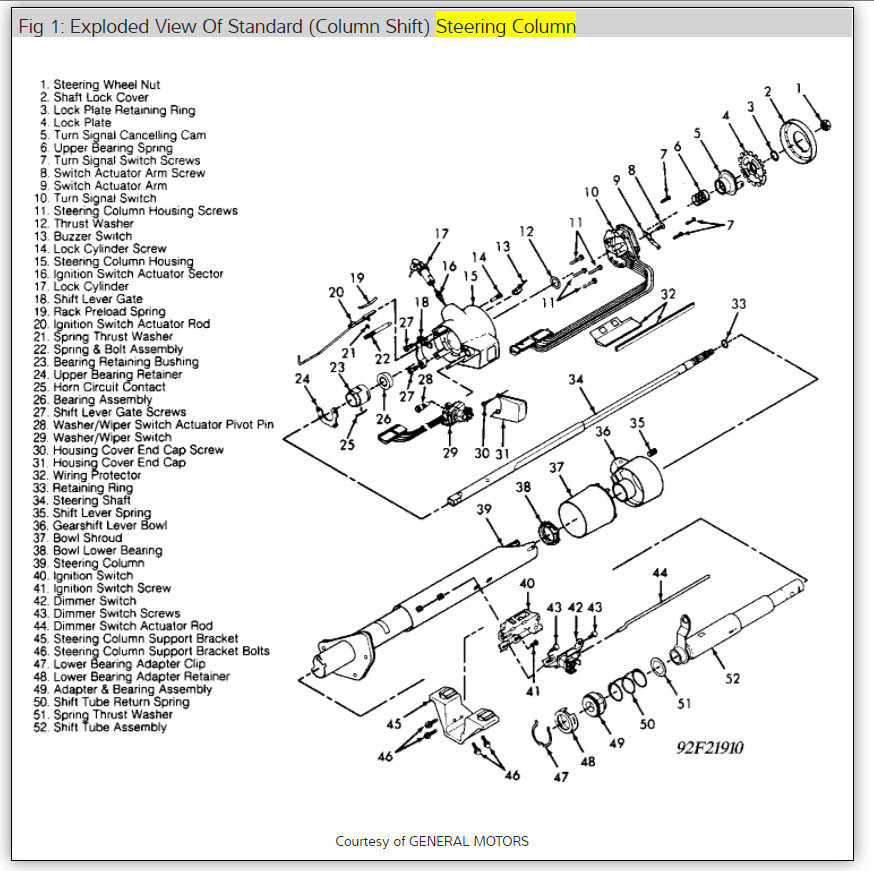

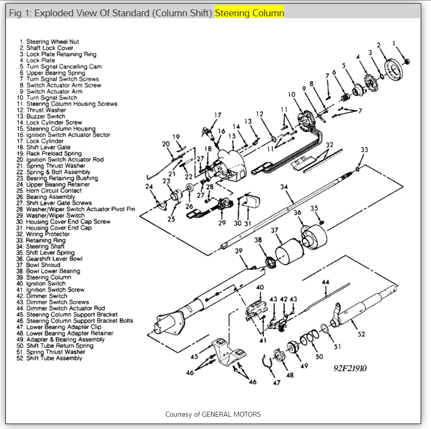

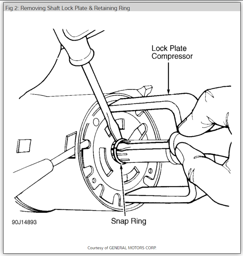

I have seen at the ignition switch the one of the two small wires breaks at the tumbler causing this issue. Here are diagrams to help you confirm the issue. Check out the diagrams (Below). Please let us know what you find.
Dec 16, 2018 at 1:45 AM
