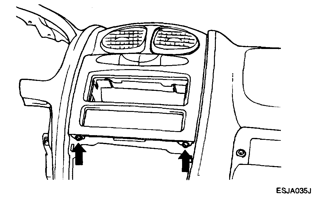

where is the BCM to reset the security system?

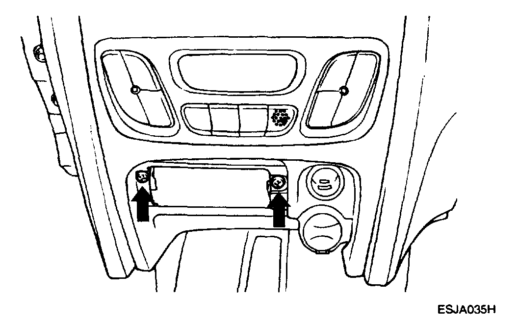

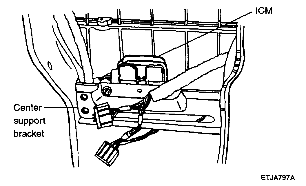

There is no reset on the BCM. Are you referring to the immobilizer control module (ICM)? Here are the directions for removal. However, the reprogramming is done via a scan tool.
The attached pics correlate with the directions.

1. Remove the ash tray and then remove the 4 screws holding the center fascia panel.
2. Remove the center fascia panel and disconnect the connectors.
pic 3
3. Remove the immobilizer control module from the center support bracket.
