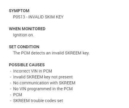

Will not crank over by key, and the security light stays on solid, dash showing code p0513.
Feb 16, 2020 at 3:07 PM
Good evening,

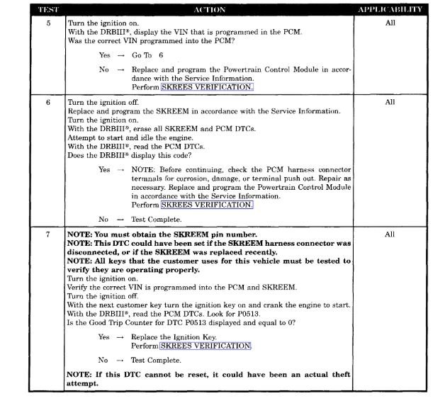

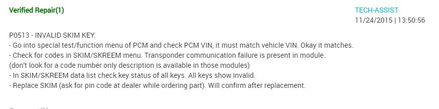

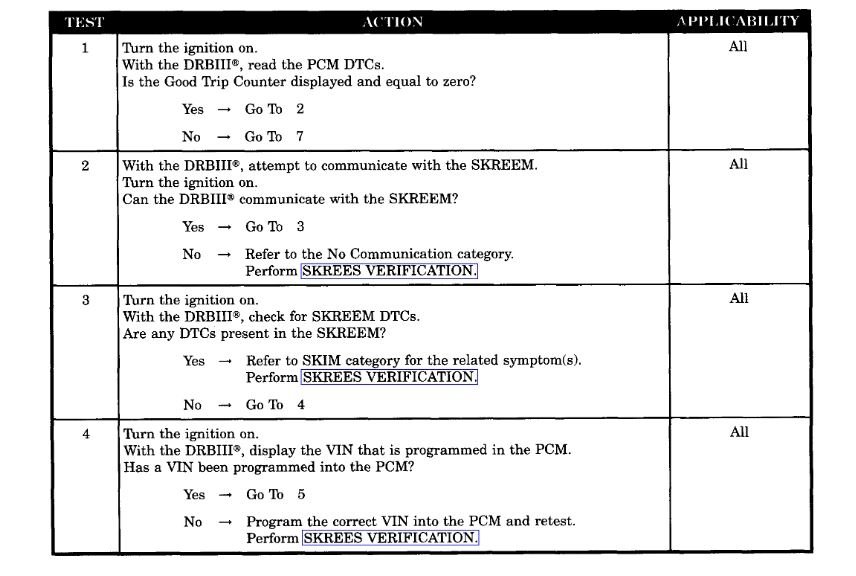

You will need an advanced scan tool to access the security section of the ECM. You will need to see if the Skim code is correct. You may have to contact the dealer to verify and then compare.
I attached a flow chart for you to follow.
