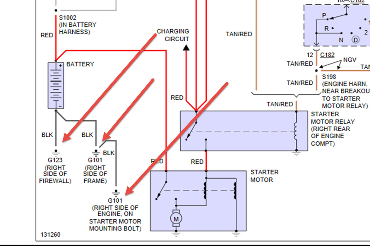

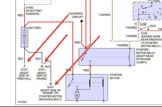

HMAC300
  • 48,601 POSTS
Electronics are really screwy on a car so take to a garage not dealer and have them check grounds see if all are connected an clean it may not fix it but check anyhow it won't be 600 dollars. Or if you can check the three that I have pointed out in arrows make sure they are clean and not corroded. See pic
Tuesday, October 25th, 2016 AT 4:35 PM
