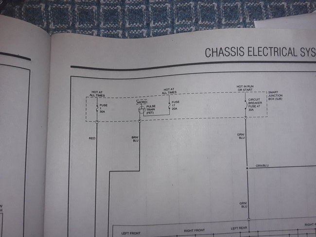

So I have found out a little more detail about the situation and I ran across a website that said if the battery is popping when you put the negative cord on it was placed wrong and will blow out a lot of circuits.
So that being said I have a question for you Mr.Danny or any expert that is willing to help . My FET line I dunno what it is, makes the connection for the Mirco Pulse Train can you tell me what the FET means and why my car uses it?

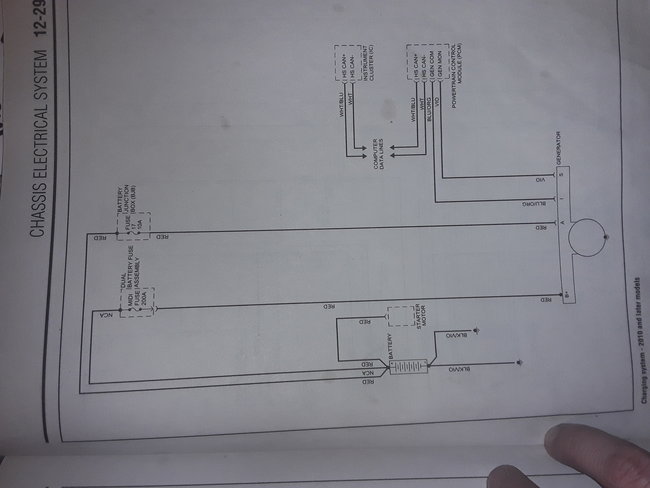

So this is the page I found the pulse train micro on. I'm also looking for the midi/fusible linkage120 A and the midi fuse 200 A. These I think are part of the problem. I've checked all the fuses on the outside besides these 2 midi fuses I just want to know where they are located and what they look like. Also I just changed my transmission out and it's telling me my transmission range sensor is bad, but it shouldn't be I just put a good transmission in it. Is there a fuse or wire that might not be making connection for the range sensor? When I put it in gear the lights don't show at all and the last transmission the parking light didn't show but all others like neutral drive reverse did.
