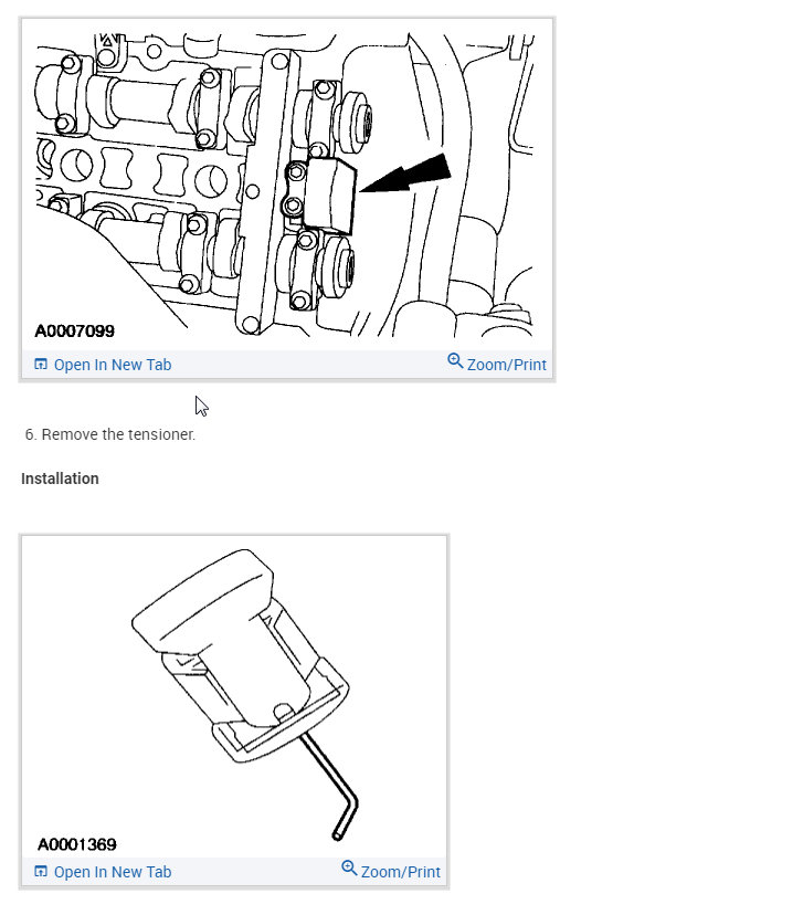

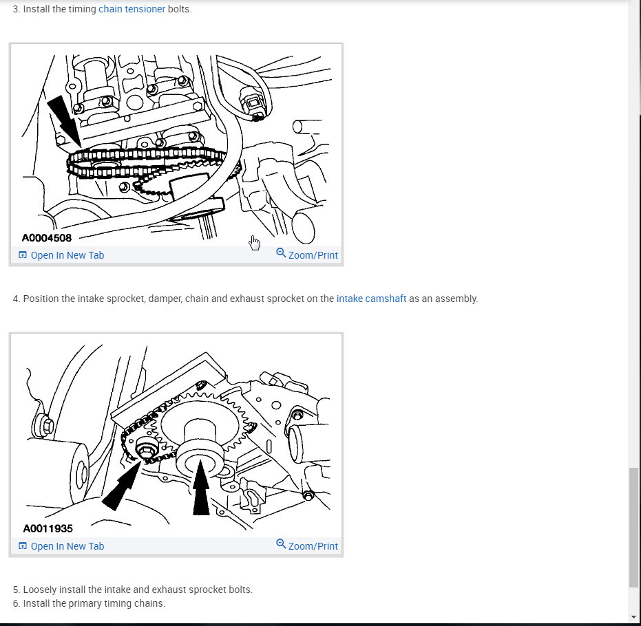

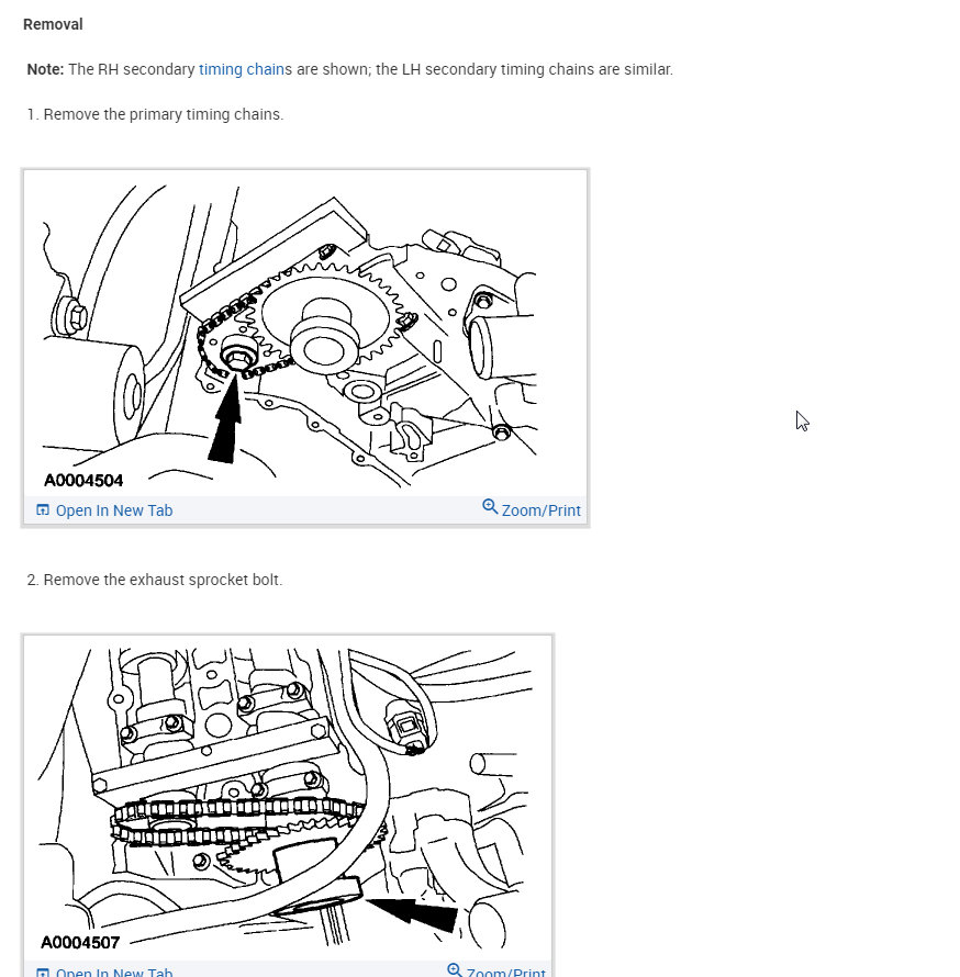

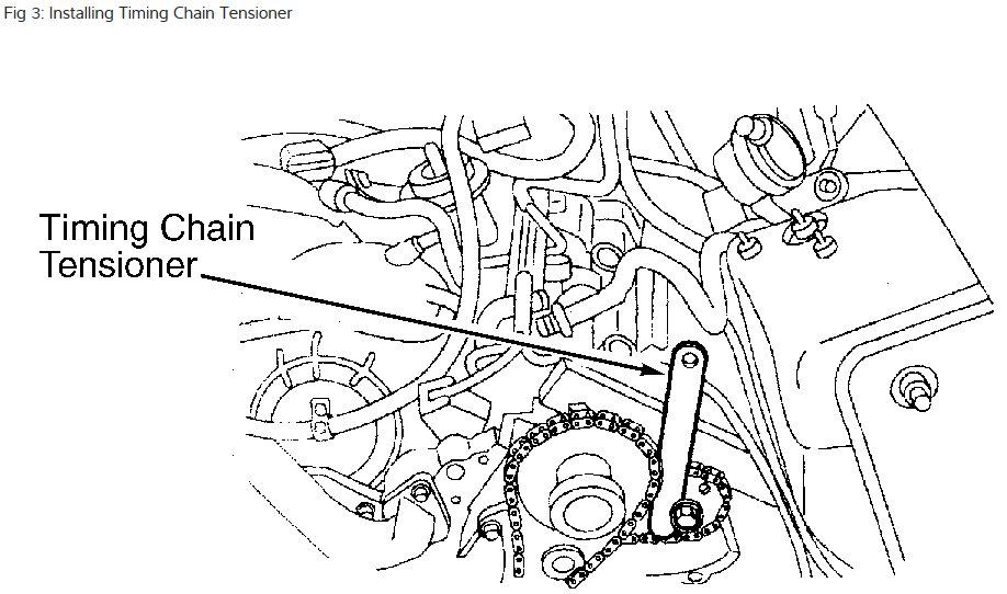

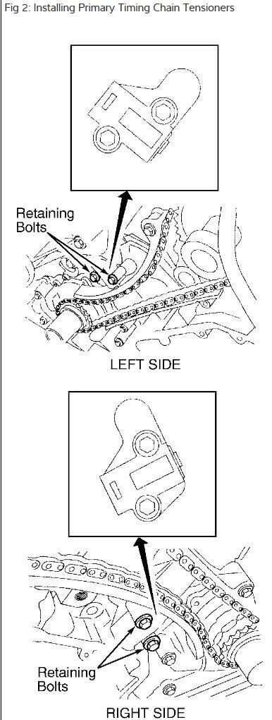

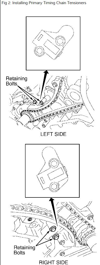

So secondary timing chain and tensioner broke on passenger side motor. How do I fix this? Can I just turn exhaust cam clock wise until it matches other cam then put chain an tensioner on? Let me know.
Wednesday, November 27th, 2019 AT 7:36 PM
12 Replies
Here is the process for installing the secondary timing chain. Check out the diagrams (Below). Please let us know if you need anything else to get the problem fixed. Let me know if you have questions.
Thursday, November 28th, 2019 AT 6:13 AM

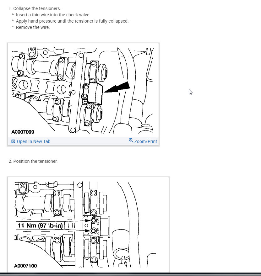

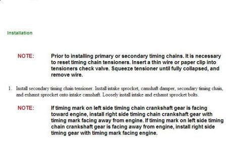

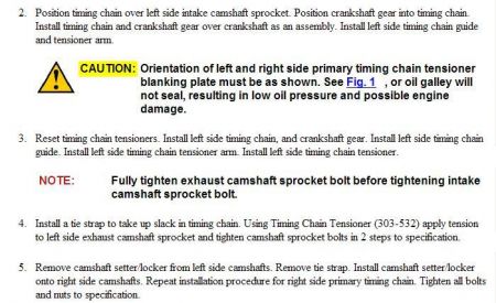

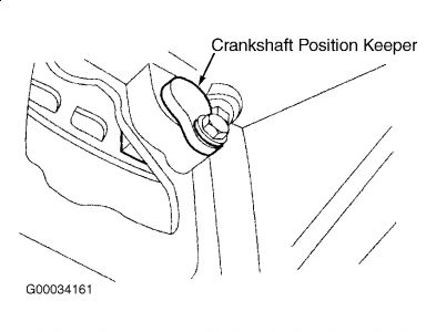

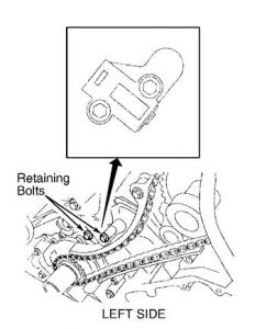

Prior to installing a new timing chain on your 3.9L motor you will need to reset the timing chain tensioners. By inserting a paper clip or thin wire into the tensioners check valve you can squeeze the tensioner until fully collapsed then remove wire.

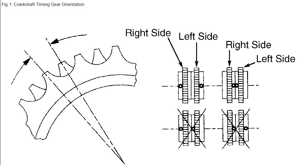

Here are the diagrams for the timing marks. Following an online repair manual like is recommend for replacing the timing chains, you can find one here https://www.2carpros.com/manuals.php

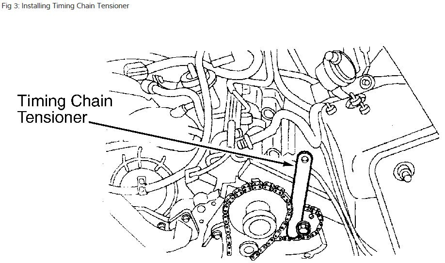

Hello I currently have a couple mechanics working on my 2000 lincoln ls 3.9L v8. They are installing a new timing chain because the last one broke. They can't seem to get ahold of the specialty tool you need to align the cams for this vehicle.I believe it's called a camshaft alignment tool. It's just a crankshaft that locks onto the cams and holds them into place while you get the timing chain into the correct position. Could you please aid me in finding this specialty tool? Thanks
Monday, September 28th, 2020 AT 10:58 AM (Merged)
BMRFIXIT
  • 19,053 POSTS

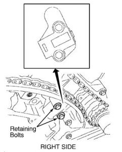

Timing Chain Tensioner 303-532
Timing Chain Tensioner Adjuster
https://www.2carpros.com/forum/automotive_pictures/99387_image_resize_2.jpg
and also you need
OTC 303-645A
Crankshaft Alignment Tool
https://www.2carpros.com/forum/automotive_pictures/99387_Graphic2_1.gif
https://www.2carpros.com/forum/automotive_pictures/99387_Graphic1_498.jpg

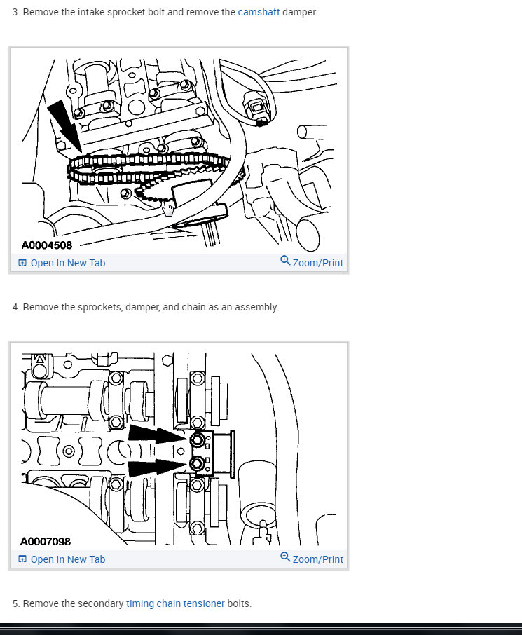

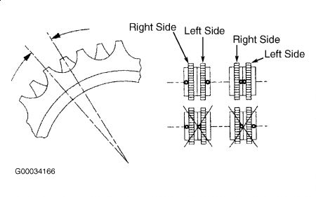

My secondary timing chain broke on the passenger side. And I need to replace it. The diagram you have is for the v6 model. My vehicle has 4 chains which is a v8. Two on each side of the car. Can you post a diagram for the timing setting on the 2000 Lincoln LS 3.9 v8.
BLUELIGHTNIN6
  • 16,542 POSTS
https://www.2carpros.com/forum/automotive_pictures/261618_1_113.jpg
https://www.2carpros.com/forum/automotive_pictures/261618_Noname_1614.jpg
https://www.2carpros.com/forum/automotive_pictures/261618_Noname2_492.jpg
https://www.2carpros.com/forum/automotive_pictures/261618_Noname3_187.jpg
FIG. 1
https://www.2carpros.com/forum/automotive_pictures/261618_1_114.jpg
https://www.2carpros.com/forum/automotive_pictures/261618_11_3.jpg
