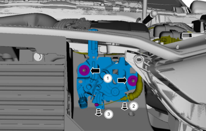

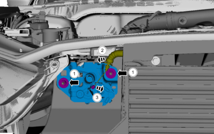

I had a minor gender bender on my front end. A lil damage. When i tried to open my hood to put in oil, my secondary hood latch won't open. I have tried everything i can think of. What do you suggest?
Aug 3, 2025 at 11:52 AM
  • 55,433 POSTS
So to be clear, the hood pops open but will not release the secondary safety latch. There are two hood latches on this car so one of them must not be operating correctly due to the crash. I would try moving the hood back and forth and up and down while trying to activate the secondary release, you may nee two people to do this. Here are images of the hood latches so you can see what you are up against. Check out the images (below). Please upload pictures or videos in your response
