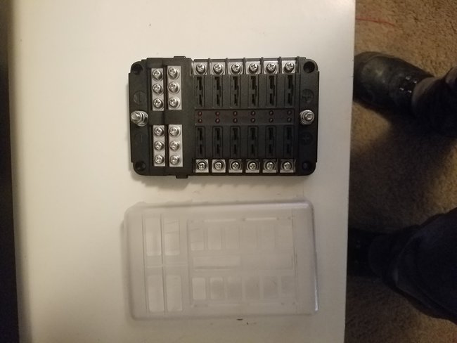

Here is a picture of the fuse box I'll be mounting in the engine bay somewhere:

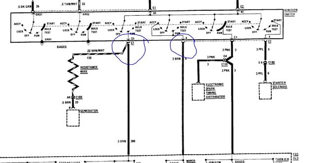

Okay, I attached a diagram for you of the ignition switch. Either the brown or orange wire should only have power with the key on.
