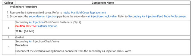

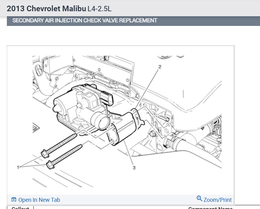

  • 55,224 POSTS
P2440 - Secondary Air Injection System Switching Valve Stuck Open, if so, you should be able to remove the valve and blow through it, I would try that first, you could have a defective valve, or something is stuck in it.
Nov 7, 2022 at 6:55 AM

  • 55,224 POSTS
P2440 The solenoid (shutoff and check) valve is stuck open or a system leak between the pump and the valve has been detected.
Let's remove the valve and see if you can blow through it? It should not allow flow. Also recheck the hose connections to make sure there are no leaks.
System Fault Detection
The ECM monitors the secondary air injection system for faults during cold start operation. When the system's pressure or relay circuits operations vary too far from the expected values, a DTC will set. Diagnostics detect the following conditions:
A partially or fully blocked or leaking secondary air injection system
A malfunctioning secondary air injection pump
A malfunctioning secondary air injection solenoid (shutoff and check) valve assembly
A malfunctioning secondary air injection pressure sensor
A restricted exhaust system
A malfunctioning secondary air injection pump and secondary air injection valve relay
