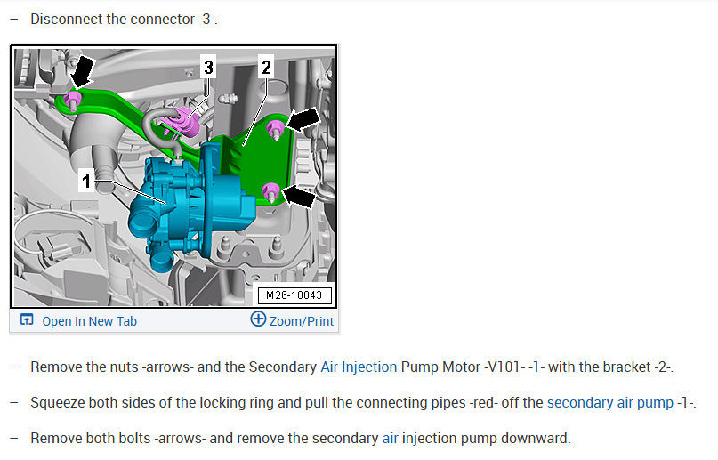

Any idea where this is?
Apr 27, 2026 at 10:41 AM
  • 110,241 POSTS
Hi:

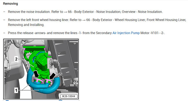

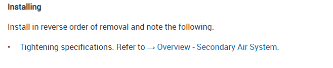

According to the manual, you need to remove the left-side inner fender liner to access the pump.
I attached the directions below for you. Take a look through them and let me know if they help or if you have other questions.
See pics below
