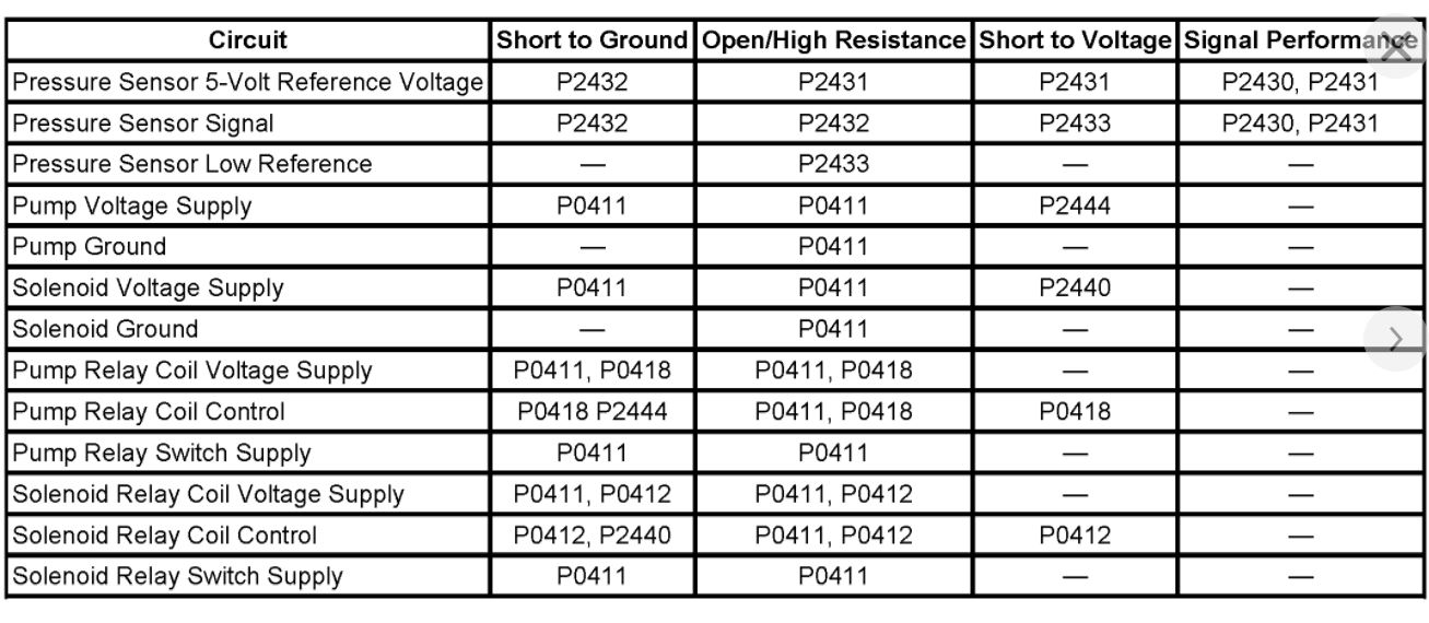

I am showing a p0411 code. I changed the fuse, air filter , secondary air check valve and secondary air injection pump and relay. I erased the code. After driving thirty two miles engine light came back on and it is reading code p0411 again.

Okay, the code is for voltage issues. I attached a chart for you to view.
It would help a lot if you had a real scan tool that could read all the live data.

I read that before. As I stated before, this is not a component issue it is a voltage issue. you will need to check the voltages at all points to verify voltages and looking for any wiring issues such as damaged or broken connectors and wiring

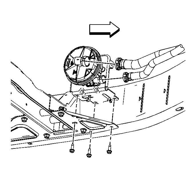

ALEX187
Where is the secondary air injection pump on a 2005 chevy trailblazer and is it something i can replace on my own?
Jul 29, 2019 at 1:23 PM (Merged)
PROTECH1980
  • 901 POSTS
The air pump and air pump relay are located on the driver side frame rail just bellow the drivers door.
