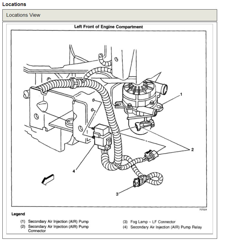

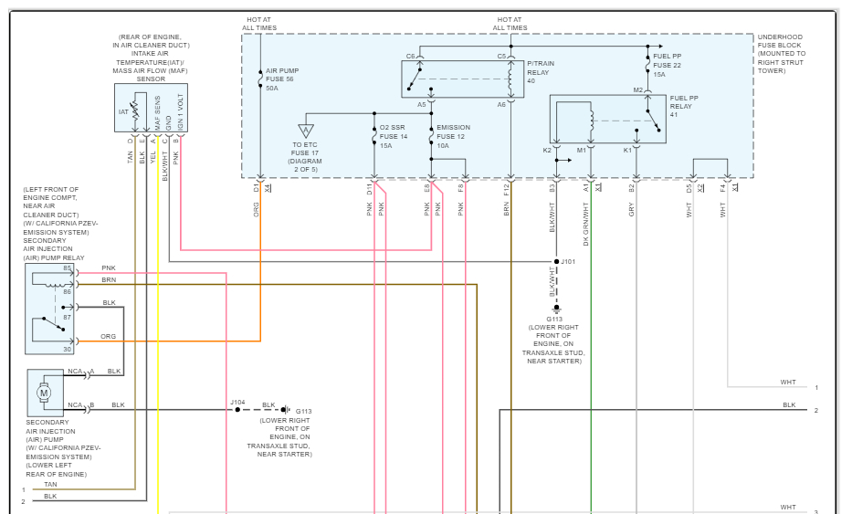

I need to know where the air injection relay is please.
May 10, 2016 at 6:38 AM
HMAC300
  • 48,601 POSTS
Secondary Air Injection (AIR) Pump Relay Left front of engine compartment, near air cleaner duct. There is no solenoid it may be part of assembly of pump. there is a check valve both are in pictures. Check out the diagrams (Below). Please let us know what happens.
May 10, 2016 at 8:38 AM

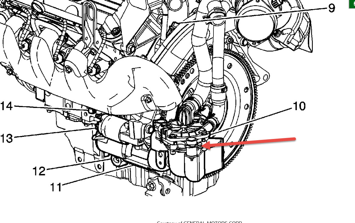

where is this air pump located on a 2005 pontiac grand prix
Jun 25, 2019 at 9:29 AM (Merged)
WRENCHTECH
  • 20,760 POSTS
Hello, The air pump is located On left front frame rail, forward of fenderwell. https://www.2carpros.com/images/external/117396613.gif Check out the diagrams (Below). Please let us know if you need anything else to get the problem fixed. Cheers
  • 110,248 POSTS

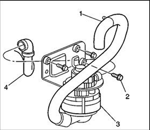

It doesn't have a traditional air pump. It has a Secondary Air Injection Reaction Pump & Solenoid.
I have attached a picture.
WRENCHTECH
  • 20,760 POSTS
GM still uses air pumps. They are just electric now.

My 01 grand prix gt has the ses light on and is throwing a code P0410 secondary air injection system, which means water in the air pump. problem is i cannot find the air pump on my car! i was told it was on the drivers side under the airbox, but the part has a pulley on it, and the only belts i see are on the passenger side. so where is my air pump?
  • 55,677 POSTS

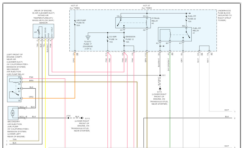

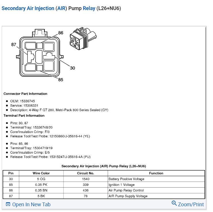

This air pump is electric. That may be why they said it's on the lower left driver's side of the car. Check to see if you have a relay or fuse that is blown as this may be your problem as well.
Here is a guide to help you test for power and how to test the relay
and
Please run this test and get back to us.

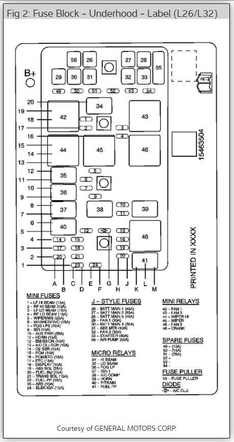

Where is the secondary air pump solenoid relay located?
Jul 29, 2020 at 10:56 AM (Merged)
PATENTED_REPAIR_PRO
  • 1,853 POSTS
Left front of engine compartment near the air cleaner duct.
