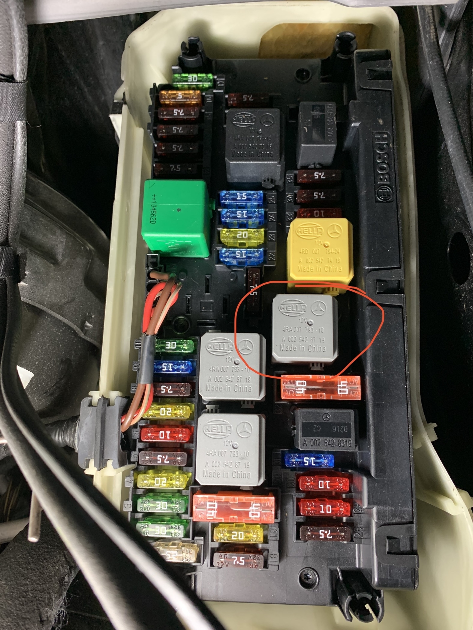

I am getting the code P0410. Secondary Air injection pump. My old pump sounded like a jet engine for about 10,000 miles and it eventually stopped working last week and CEL light came up. I replaced the pump with brand new OEM one last weekend, but the pump is still not engaging after cold start and the light keeps coming back on. I replaced the relay that I circled on the attached picture.

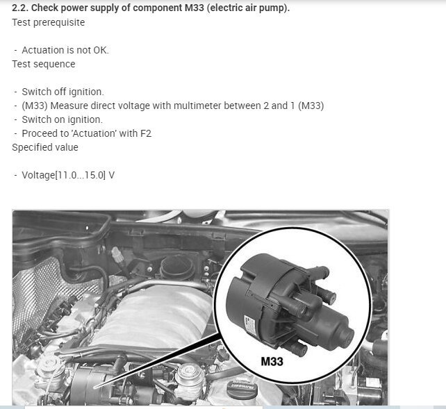

As far as it no actuating, have you checked for power at the pump itself? Take a look at the pic below and let me know what you find.
See pic below.

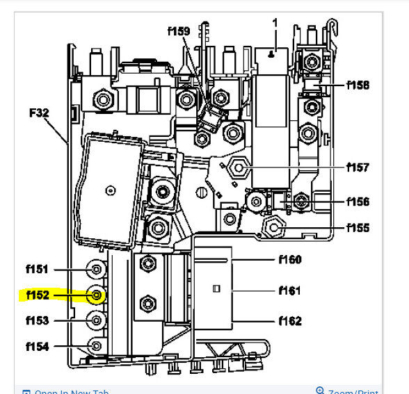

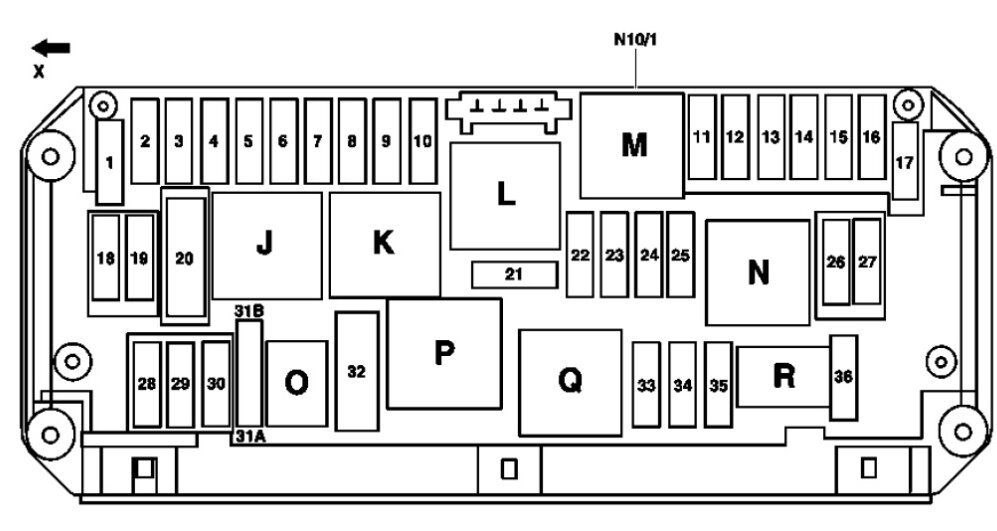

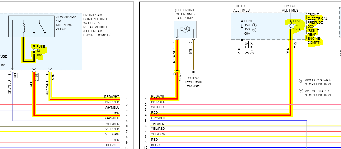

No problem. Pic 1 shows the relay and the power distribution from the fuse to the relay. There are two that may have failed. However, if the old pump was failing, my first suspect would be fuse 32 in the under-hood fuse box. See pic 3 for fuse location. Pic 2 is the pre-fuse fuse box which has a much higher amperage fuse. I don't feel this would have failed, but anything is possible.
When you check fuses, make sure they are good first. If they are, it is important to make sure there is power both to and from them.

Thanks for the information. If you look at my picture, fuse 32 is the 40 amp fuse. Is that the right one? I pulled this fuse and looked at from the top it seems like it’s intact. Is there supposed to be like an LED light on top of it that will turn on indicating that the fuse is blown.
