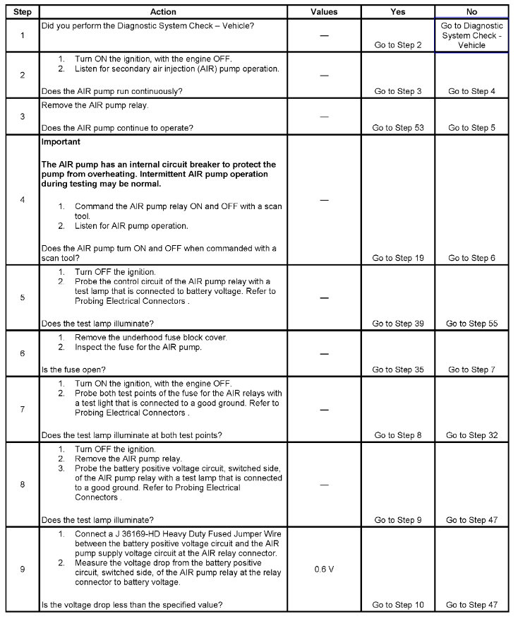

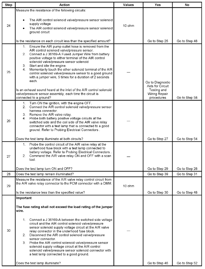

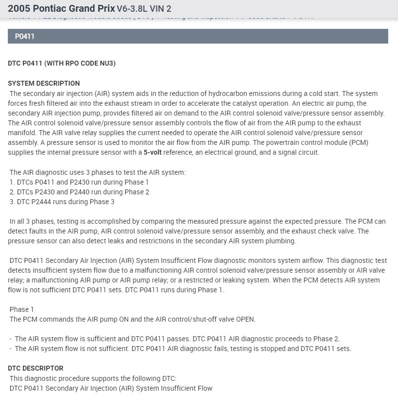

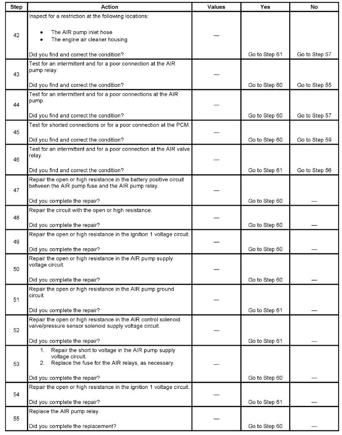

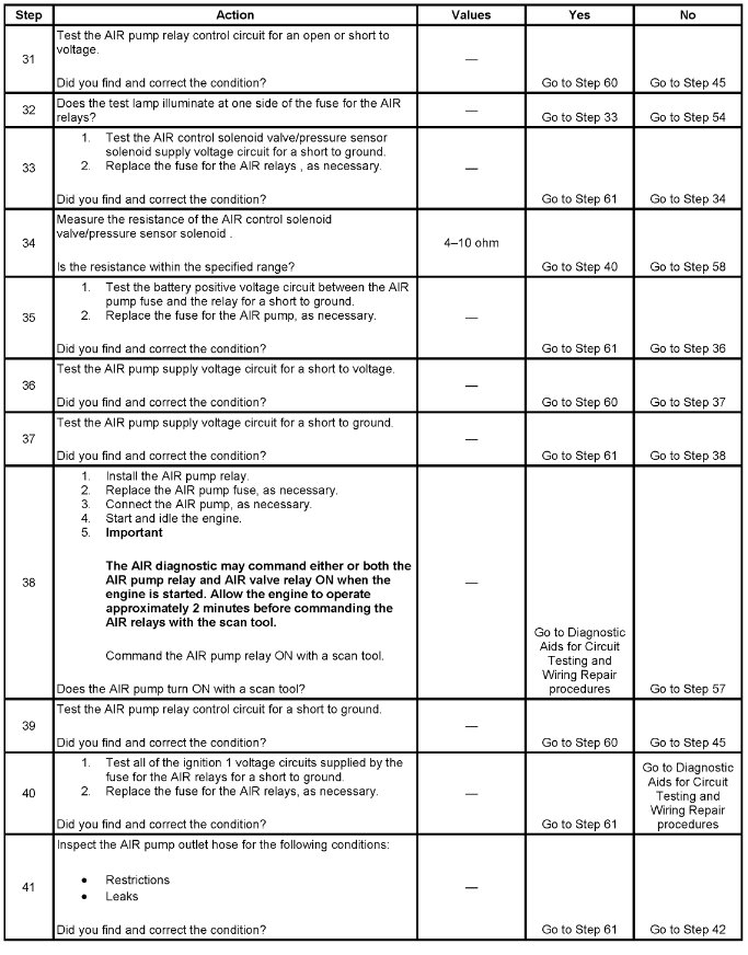

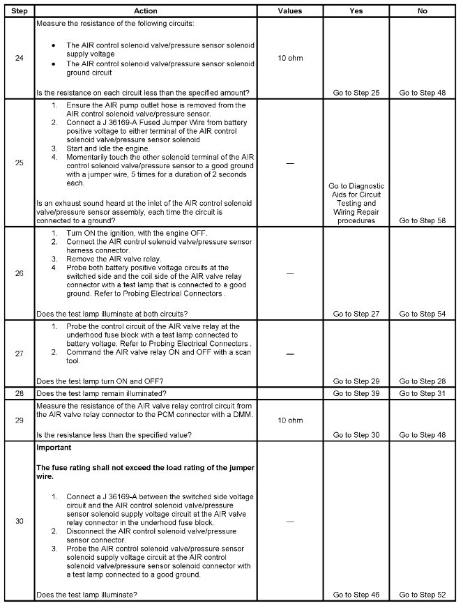

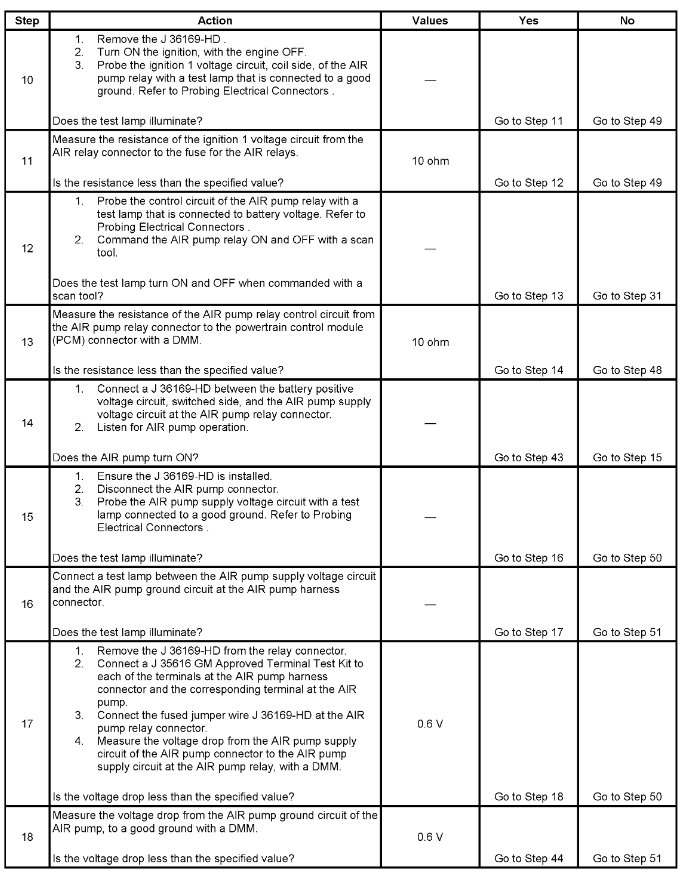

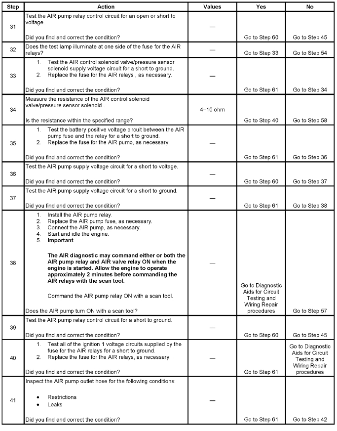

I put a new secondary air flow in i reset the code and it comes back again. What do i do now? What else is it? Please help
Jun 28, 2022 at 11:09 PM
SQM
  • 6,383 POSTS
Keep in mind that the code can get triggered due to any number of components including the actual part as well as wiring issue.
Can you tell me exactly what code you are getting?
This will allow me to look into the diagnostics for the issue.
Jun 29, 2022 at 3:50 AM
PENNYTAZ
  • 9 POSTS

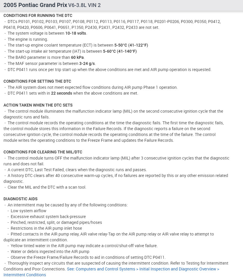

P0411 secondary air flow.
Jun 29, 2022 at 5:04 AM
PENNYTAZ
  • 9 POSTS
P0411.
Jun 29, 2022 at 7:59 AM
SQM
  • 6,383 POSTS

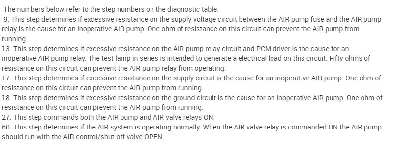

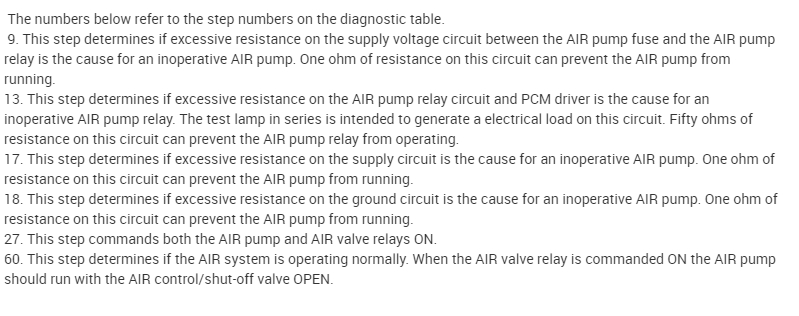

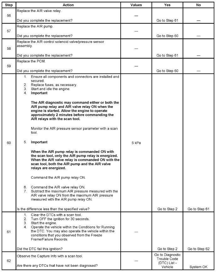

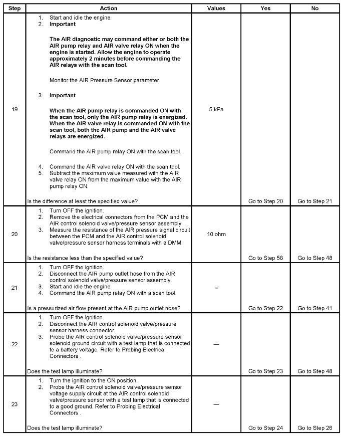

See attached for the troubleshooting guide. It covers all the possibilities.
