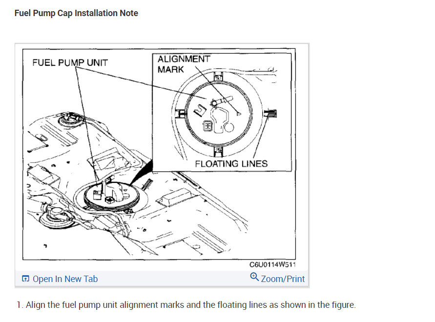

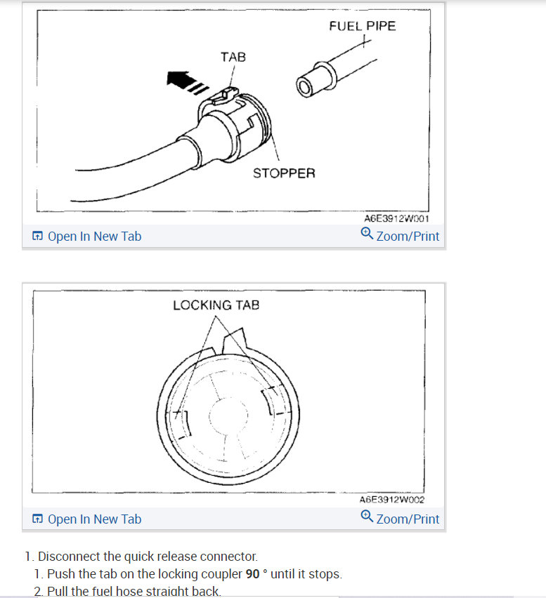

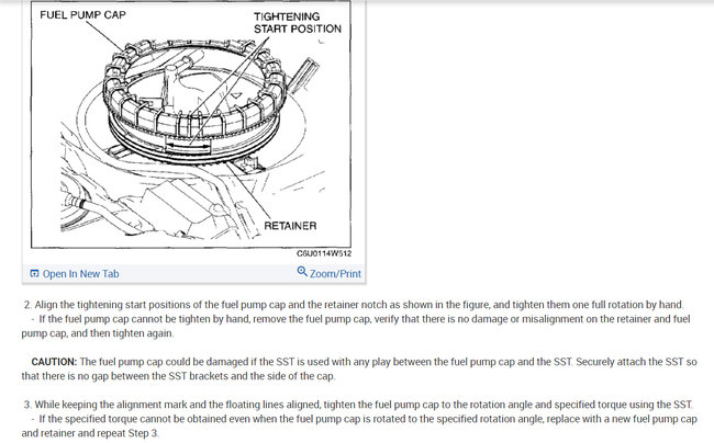

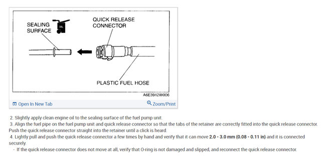

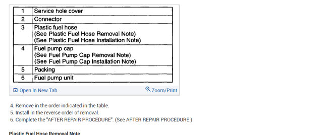

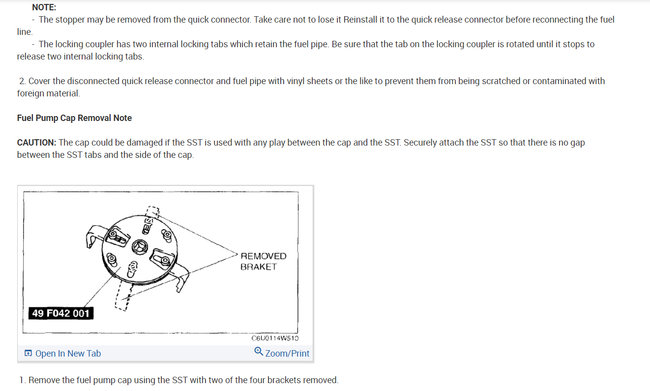

Good morning,

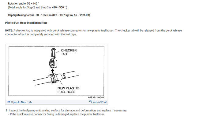

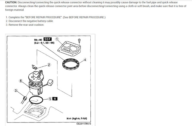

I would check the fuel pressure. The fact it is running lean suggests there is not enough fuel at the rail.
https://www.2carpros.com/articles/repair-lean-mixture-codes-p0171-or-p0174-on-some-manufacturers
You could need a fuel pump. I would start there.
https://www.2carpros.com/articles/how-to-replace-an-electric-fuel-pump
